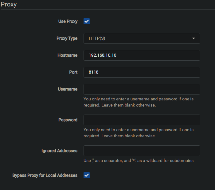

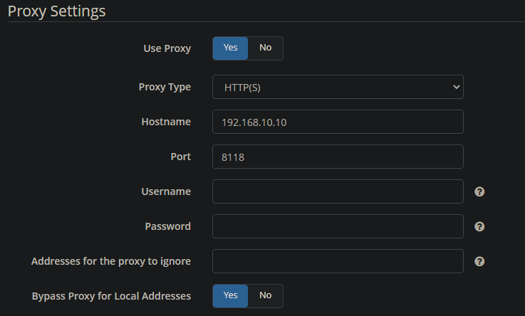

  4. 1. only using privoxy, nothing going through a container. 2. 192.168.10.0/24 server 192.168.10.10 3. Deluge,Radarr,Sonarr all set to bridge I'm not very knowledgeable on Unriad so just used spaceinvaders vids to setup a few years ago Sonarr: Radarr:
  5. So if just using privoxy from radarr/sonarr etc we dont need to change anything? Because nothing using privoxy is working since the update to deluge.

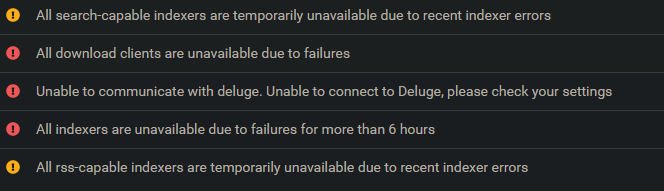

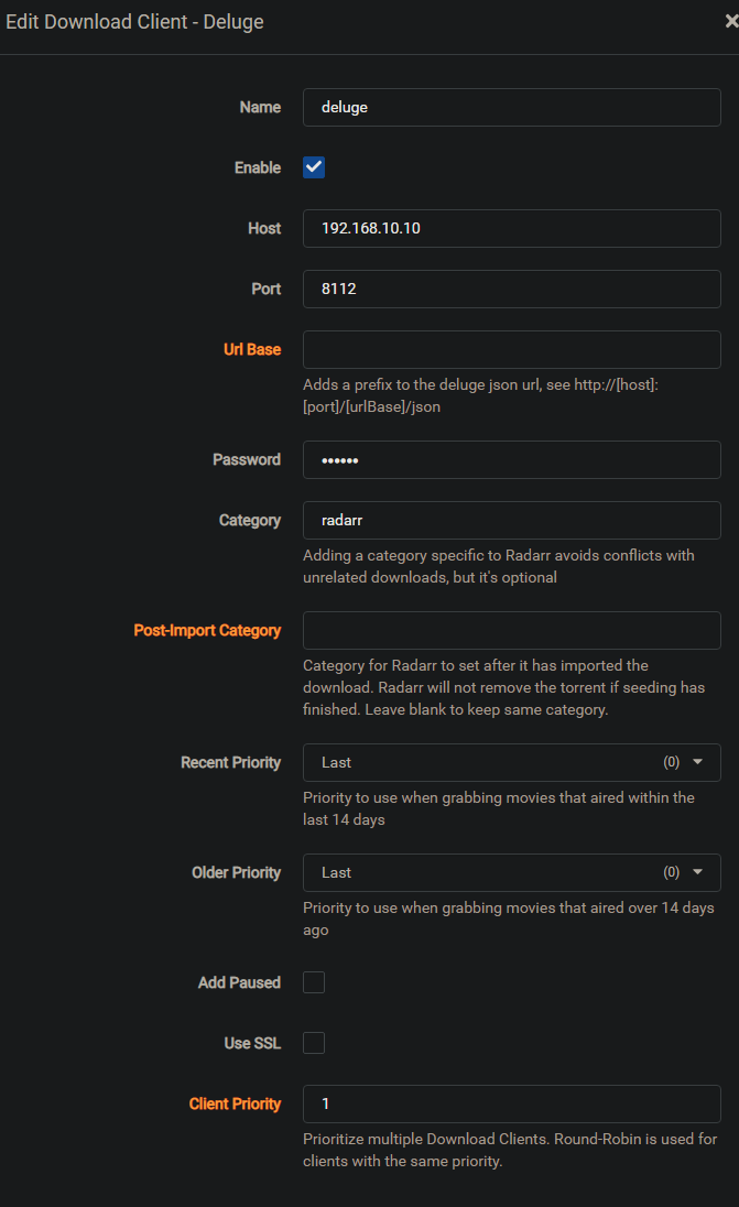

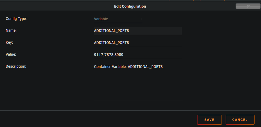

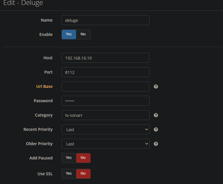

  6. Hi, sorry another person getting stuck with this new update here. Not really that great with unraid so guessing something maybe setup wrong in the first place which is why its not not working. (but has been fine for 2 years ish) Didn't have additional_ports so added this: Assume that's correct? Sonarr/Radarr/Jacket all on same IP as deluge. Get this error in those when trying to test download client Unknown exception: The operation has timed out.: 'http://192.168.10.10:8112/json' I have the host in Sonarr/Radarr/Jacket set to the same IP as deluge/server, tried localhost and it instantly says unable to connect on test. Also tried setting the proxy to localhost but no change to test results
