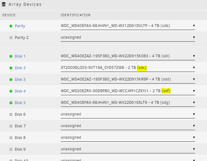

  7. Thank you for the help. I do have a spare 2TB drive and slot location if that will help with the process. So I have a few questions. Question 1 Is this the command to back up disk4 MBR? dd if=/dev/sdf of=/boot/disk4.mbr bs=512 count=1 Not sure how to find the disk4 identifier, but I haven't done anything since the diag but stop the array, so it should hopefully be the same. How do I check what the identifier is? I have attached an image and highlighted what I believe are the identifiers. Do I check with the array started or stopped. It is currently stopped. Question 2 Where does the back up go? Question 3 How do I implement those commands? I assume I just type the commands in the terminal? Do I have to start the array before doing these commands, or keep the array off? Thanks again.
