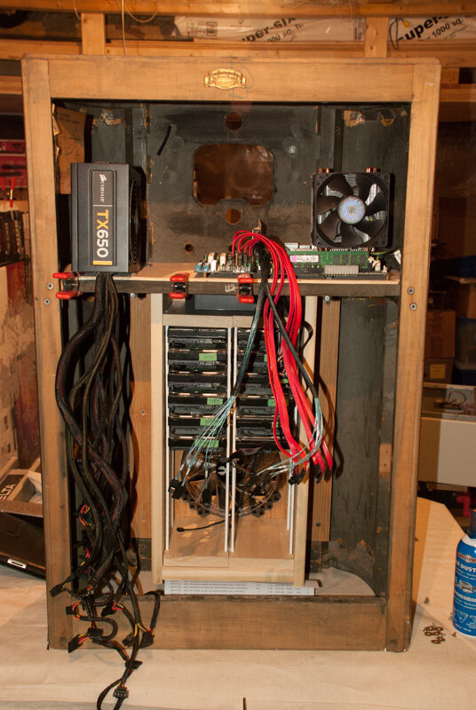

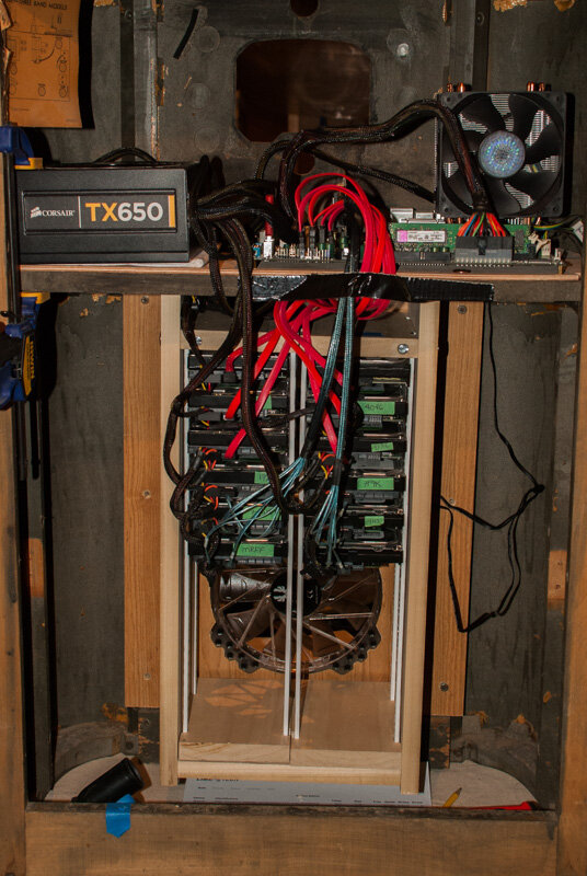

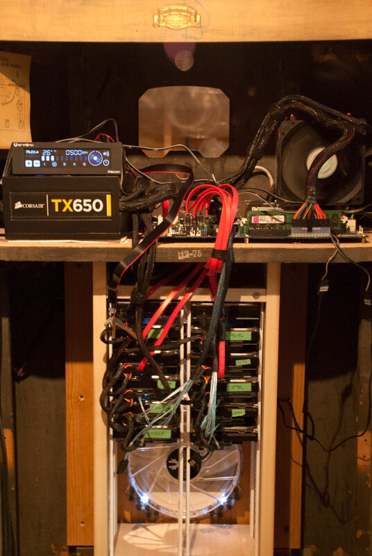

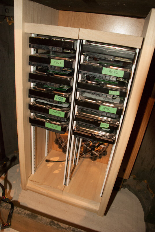

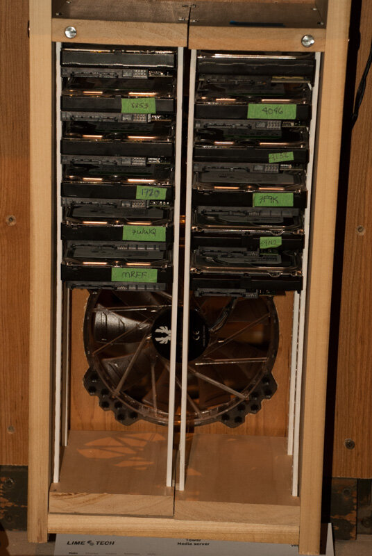

  1. This not making new holes in the original radio is becoming a pain. Tried to remove the mid shelf, but they glued the front. This has caused more headaches. The space between the front curves and that plate allows for 1 finger. I now need to create custom power cables and distribution block. For now I built a baseplate to cover the midshelf and accept mounting hardware. The bolts holding down the baseplate are a little high for my liking. I'll be getting some of those ikea style furniture bolts. I also need to buy new baseplate material as the old piece I used was warped. Going to try and use clamps to see if I can get it to hold flat shape. (highly doubt it) Tossed in all the drives I have. Worried that parity and cache are so close to the top. Maybe the design will only hold 20 drives instead of 22. We'll see how temps are. and here is the mess of wires I need to deal with. <grumble grumble> I forgot about getting a power button. Reset button, etc etc. lots of forgots. so now unraid is offline and my regular drives will have to bear the brunt of media for now. Total Spent so far: $40 - $40 Radio $90 - Fans and Controller $53 - 3/4 Inch Poplar $30 - Closet Rails 6$ - PC Screws ------------------------------- $229

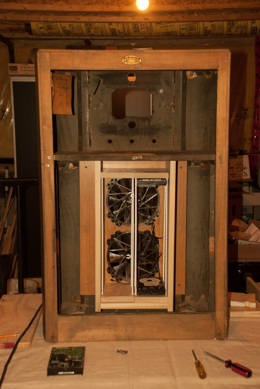

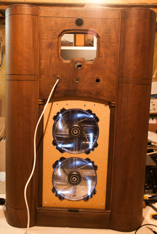

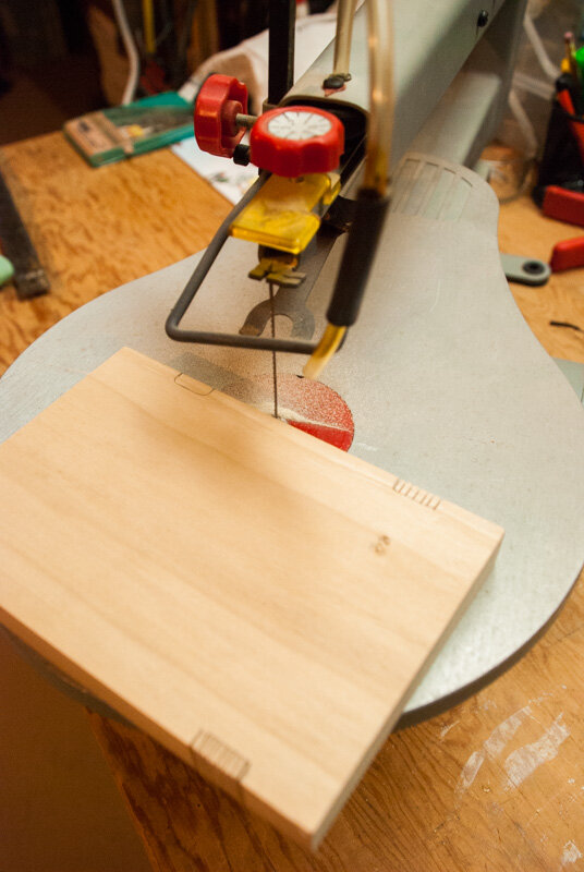

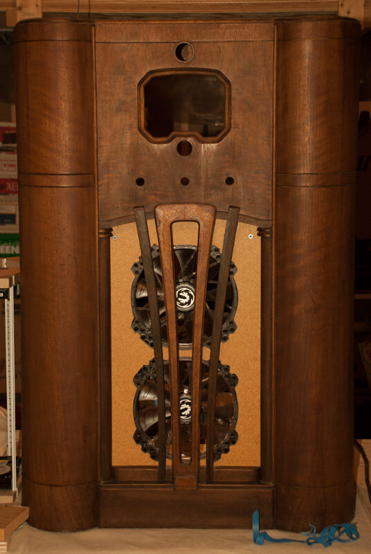

  2. Cut out the rack tops: Mounted: Assemble Fan / Rack Box Cut out and install fans into front plate Fans Installed: Front and Read View (still needs cutout for fan power wires to leave the fan box)

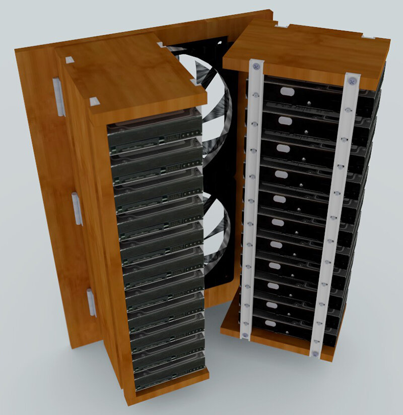

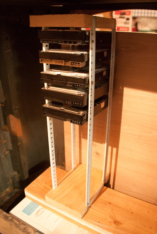

  4. Starting finally. There is going to be a redesign of the way the racks open. They will pivot back from the bottom. Here is the damaged top again: Removed the top damaged layer of veneer. Going to go veneer hunting (saved large piece for grain matching) Cutting the shelf brackets. Rough idea of height / clearance requirements (mock up using pine. too soft and not quite cut to spec. Slight bends in the brackets). Solid though. Most wood parts for each rack will be made using hardwood. (possibly leftover bloodwood. Very messy cutting though) All for now. Gonna have to go back to Sketchup for a new pivot design.

  6. Update: I should be back on the project starting this October. Did a quick mock-up of the last render I did, and found that the back bracket between the radio side and the drive cage is nearly inaccessible. Might be hard to mount new drives. Looking at using lift off hinges Each side will weigh between 18-20 lbs (when full). The hinges must be able to handle it. This would allow easier removal of the cages for new HDD install/replacement. Might try a few new designs.. but I like the current hinge design. Would have used drawer slides on top (so the cage slides back), but getting them short enough will be tough.

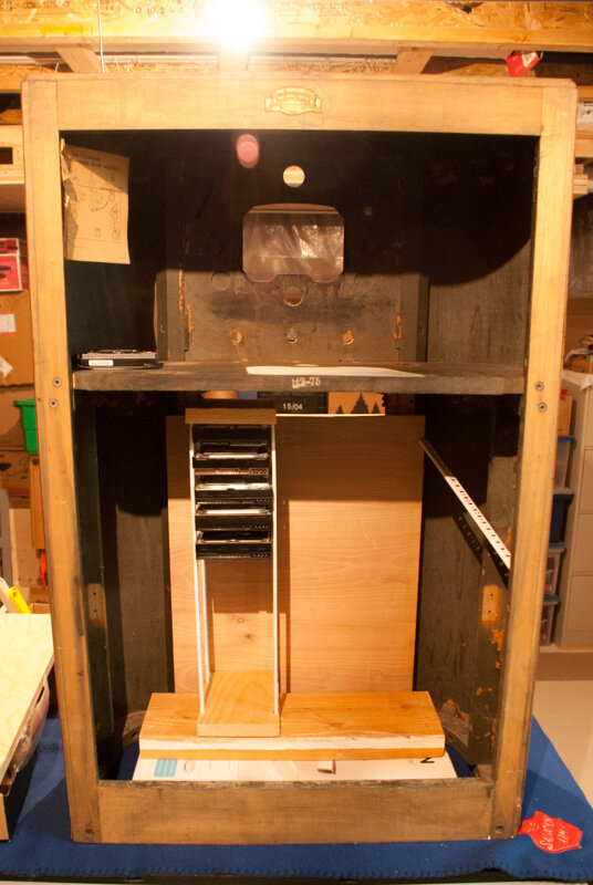

  8. Hi Guys. This is still happening. Unfortunately, my wife decided that this project was taking up too much of my time and asked for a divorce. I'm kidding........ It's not cause of the radio. So till the house sells and this mess is over, the project will be very slow, but I am working on it. I have finalized the drive tray design. Hoping to start on the trays this week. Jon, if you want to steal the images for blog post, by all means. Garycase, I will be taking photos. As a photographer, I feel it is my duty. Hope to meet all your expectations.

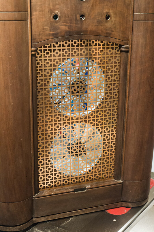

  10. Thinking along these lines. The radio part of this won't be a big space issue so I'm not going to bother drawing it out. 140mm fans. Shielded separator (drives and speakers) Some nice vintage speaker cloth to cover the fans and speakers (worried about enough air movement after the fabric is added). Can't use the original cloth as it is glued to the original panel and something splashed on it (looks like bleach). Now need to figure out the drive bracketing. Buy existing or make my own. I like this idea.

  13. Agreed. The radio will remain as stock looking as possible and it has to be almost dead silent cooling wise. Looked up 7 volt mod, I may try it as long as it can still move enough air to cool all the drives during parity checks. Magic Eye (Top Hole) http://en.wikipedia.org/wiki/Magic_eye_tube I am trying to get the magic eye to stay (show disk access) but with the fact that this 6x6 tube burns out with time and those tubes are $$$ and rare, I am looking for alternative. (maybe EM83, etc) Window (Display Hole) Thinking I will build a casing for it and add a 20% tinted piece of glass behind it with about 1" space in between. I will light up the area between the panes of glass. When the radio is on, the radio dial will show nicely, but when off, the light between the panes will allow the minimal red led lighting from the upper part of the inside to barely be visible. Worst case, will just keep it simple with black felt instead of tint. But I can't see how this will be used yet. none of the numbers on the display I can work with. (maybe the 1.7 to 5.5 could be temp? 17 to 55?) 1" Hole below display will either be Radio control knob or USB port. Three button holes I was going to put power, reset and some other type of switch there, but realized that I don't want people (AKA kids) pushing the buttons (ooh look shiny) Still unsure. Guess keep it to radio functions Drive arrangement has almost been decided. Gonna hammer out the details in Sketchup this week. Gonna retain much of the wood look.

  15. "No Vintage Pre WWII Radios will be harmed in the making of this server." Download: Sketchup File of the Radio Case: http://www.chucklavoie.ca/_projects/unraidio/unraidio.skp ** for those that may want to try some ideas out as well ** The drives will be suspended from and resting on the original wooden supports inside. I will build custom brackets / adapters to ensure no new holes will be drilled into the radio. If I want to restore it, it will be simple to undo changes. Other ideas that I am considering: FM Tuner (https://www.sparkfun.com/products/11083) or Online Radio Streams w/ Raspeberry Pi (http://www.bobrathbone.com/raspberrypi/Raspberry%20PI%20Radio.pdf) 2.1 PC Speakers (Inside) 7" LCD Touchscreen Monitor (In Window area)? Or Fan Controller? Battery Backup built in (larger battery for hours of up time) I am very indecisive lately, so this may take awhile. Rough draft #1. (2x 200mm Cooling Fans for HDD) Side cylinders provide upper unit with cooler air from bottom. Will be closed in at back. (slit at top to allow hot air to escape). Fan in cylinders to push air up

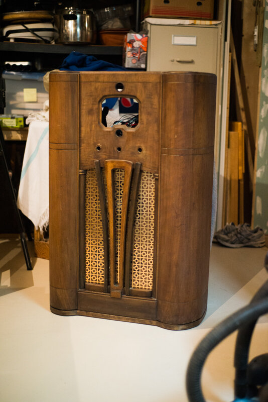

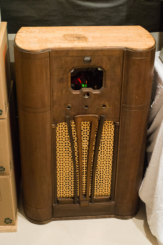

  17. Placeholder #3
