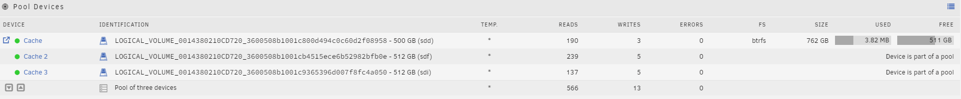

  4. Hi there, I have 3 SSDs of approximately 500 GB each in my cache pool device. It does say that the total size is 762 GB which I expect. However, when I combine the Used + Free space, I only get 511 GB. What am I doing wrong here? I've rebooted the server a couple of times but to no avail. Any tips here?
