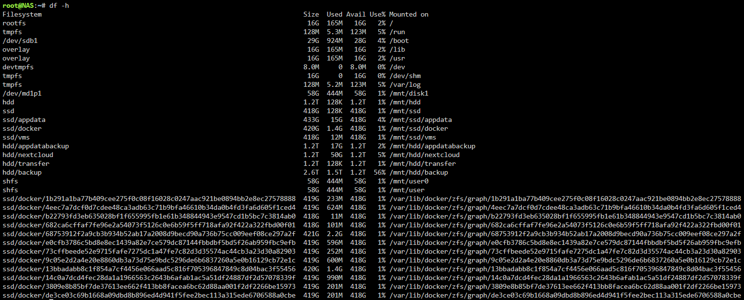

I have the same. Observed this 2 times with some month in between. But something seems not right.

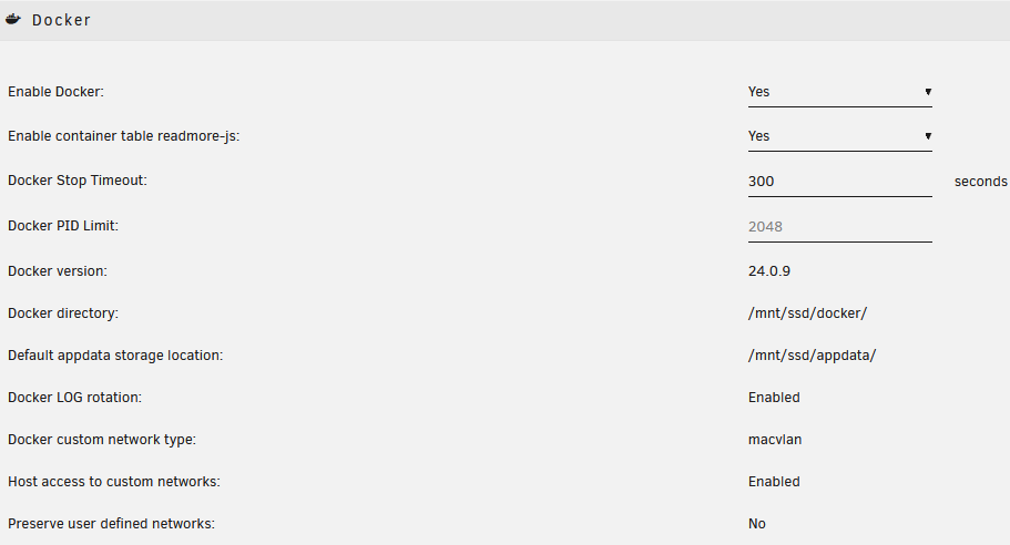

I have no image, I have a docker directory set. There IS space available, so no clue what the issue.
6.12.14.
docker start urbackup-ncbackup
Error response from daemon: failed to create task for container: failed to create shim task: OCI runtime create failed: runc create failed: unable to start container process: unable to apply cgroup configuration: mkdir /sys/fs/cgroup/docker/32089c8491bddd232588f4567a6c0320bc3e88090aa2eab98faf1befc2589331: no space left on device: unknown
Error: failed to start containers: urbackup-ncbackup
Any ideas?
This docker start error is not being logged into the syslog as I see. Dont know why.
Recommend changing to a docker image, docker folder sometimes causes strange issues.
Is that noted in the docs? With any reasons? If its like this, I try switching back to an image.
No, observation is based mostly on my experience in the forums
