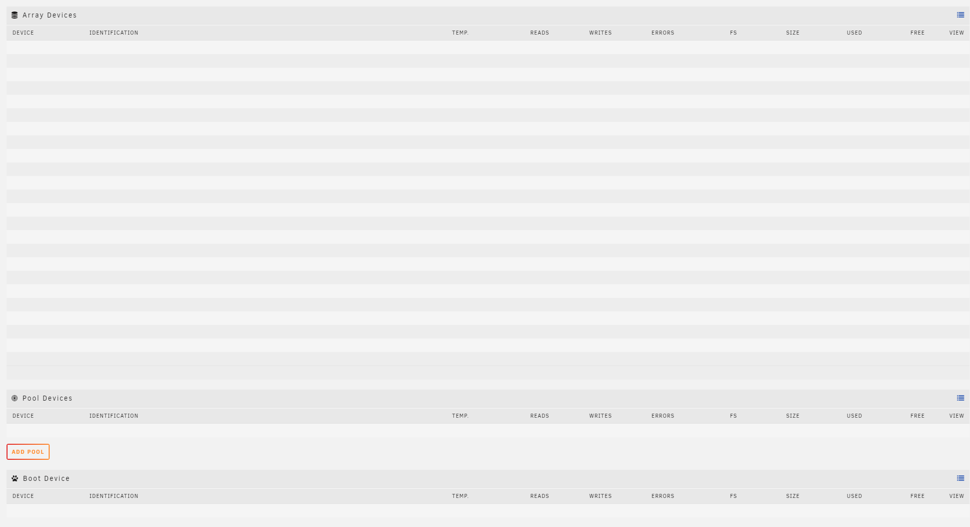

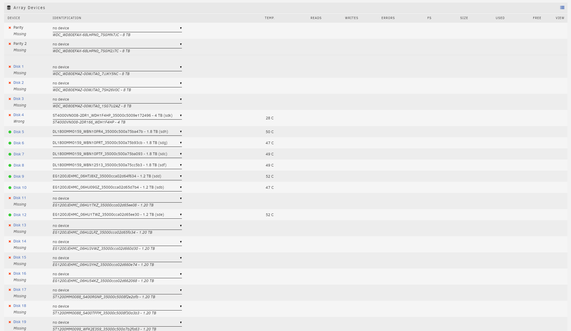

Failed hardware, moved to new and now have multiple missing drives
Sorry for the quick quoted reply, but I opened up the webui in Edge and it's populated, so I'm guessing some caching issue in Brave. Here's the Array/pool shots!
I'm going to have to reboot the server I guess, this happens once in a while, including on the old hardware as well, the drives are there but everything is blank.

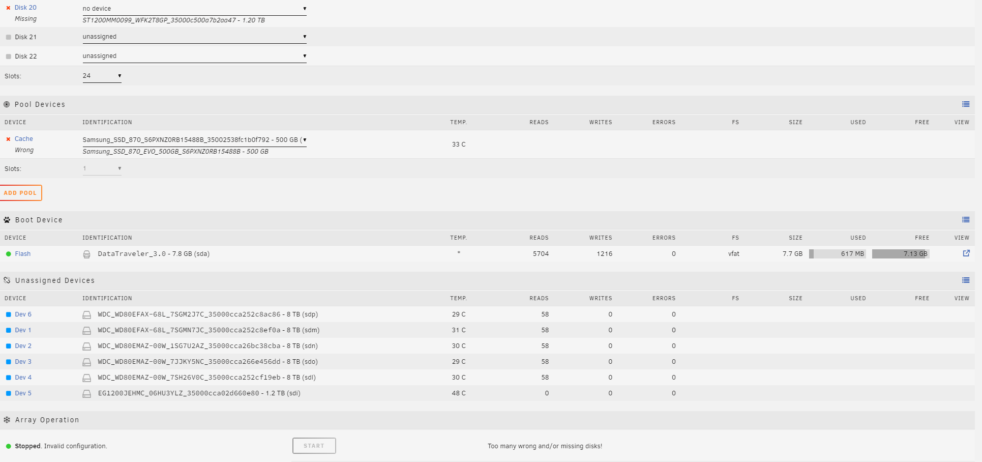

Hi everyone, Sadly I had a server that just decided to up and stop powering on at all, out of warranty of course and I don't have the funds to buy components to swap out hardware to see what failed (most likely motherboard I think). I've swapped from the (dead) Dell R730XD server to an HP DL380 Gen8 server, but Unraid isn't able to automatically recognize the drives, or at least most of them. I can work out what some of them are, but when I do select that it says "Wrong" now instead of missing. For the ones that I can't identify, because I have several WD 8TB drives, what can I do? I had two WD 8TB parity drives, and data drives consisting of three WD 8TB drives, one Seagate 4TB drive, and several other 1.2-1.8 SAS drives, some of those 1.2's I couldn't move into the HP server as I was missing enough drive trays to move them all. I did try to search the forums but didn't come up with something similar, likely my fault in search terms I think! I do have the HP P420i array controller in HBA mode thanks to another post on the forums, so I should be set there, but I think due to the controller differences it's getting more(?) information from the drives and that doesn't match what it had previously.
