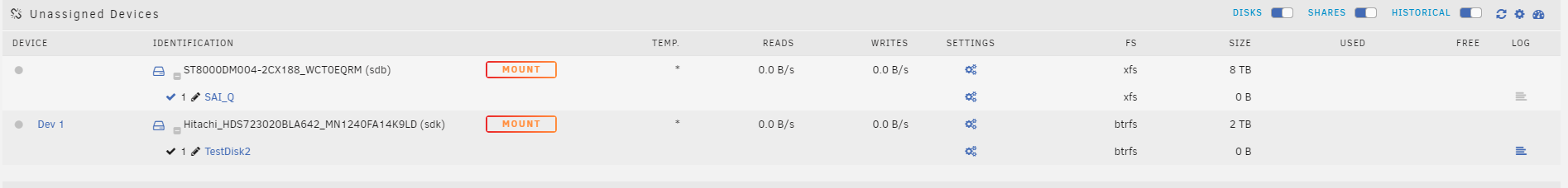

  4. One is a USB drive and one is a Sata. The Sata (hitachi) is the one not working. Also, the check mark is not blue for the Hitachi drive either to run file system check. But I'm assuming that is because it has trouble finding it.

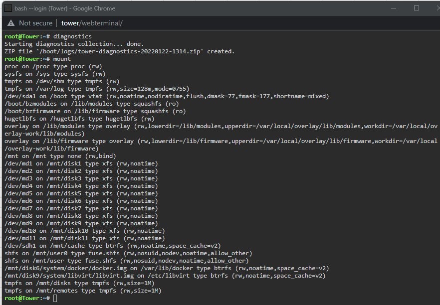

  5. Again, thank you for helping me so quickly. I have attached the diagnostics for you and here is the results of the 'mount' command. tower-diagnostics-20220122-1314.zip
  6. Thank you for the quick reply. I saw that on another thread and tried that. This is all I get when doing that. I'm assuming because I don't have any disks mounted in UD.

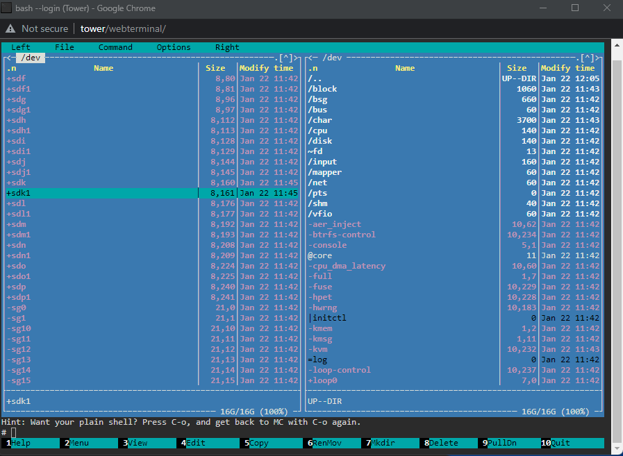

  7. I am trying to mount a few drives to and everytime I try to mount the drives I get the following error in device log: Jan 22 11:46:06 Tower unassigned.devices: Mount of 'sdk1' failed: 'mount: /mnt/disks/MN1240FA14K9LD: /dev/sdk1 already mounted or mount point busy. ' I have tried uninstalling Unassigned Drives and reinstalling but still receive the same error. Seems like the mount is stuck somewhere and I cannot remove. Any help would be appreciated. I see the +sdk1 file in /dev folder. Should I delete that or need to go another route? I am just trying to use Midnight Commander to copy files from the drive to my array. Thanks for your help.
