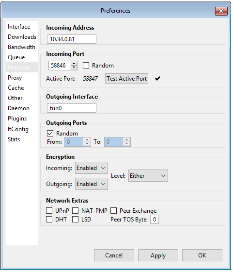

Apologies, user error I'm sure. And I think there are two people asking about ports simultaneously which may be confusing things. This is the port information I used in the generation of my docker container. docker run -d \ --cap-add=NET_ADMIN \ -p 8112:8112 \ -p 8118:8118 \ -p 58846:58846 \ -p 58946:58946 \ With VPN enabled, I'm unable to update deluge to use port 58846 as the incoming port. From your comment, that sounds like normal behavior. I have established port forwarding through my VPN provider (Torguard) for 58846, 58847, 58946. Updating the deluge incoming port through the webui to 58847 shows that the port is active and I'm connectable. However, my speeds are ~10% of my theoretical max. And testing that vpn server on the same network over wifi on my desktop, I get speeds 3 times faster. As my server is connected via ethernet i would expect speeds to be considerably higher. I've tried to work through each of the items you've identified in Q6 here: https://github.com/binhex/documentation/blob/master/docker/faq/vpn.md Upload rate set to 3/4 of my theoretical max GCM cipher used ItConfig installed. Both enable_incoming_utp and enable_outgoing_utp are disabled. Rate limit overhead disabled. VPN endpoint should be ok - I can use a different (windows based) machine on the same network, connect to the same endpoint, and max out my connection (over wifi) Disk fragmentation not an issue - new disk. Not writing to an array/using unraid Router shouldn't be an issue considering over wifi it's faster and it's a top of the line netgear The only thing I can think of is that there is something wrong with my port config. Again, appreciate your response, and any other ideas would be greatly appreciated!
[Support] binhex - DelugeVPN
Thanks for the fast response binhex. I seem unable to use the 58846 port. When I select that as the incoming port (either in the thin client or by manually updated core.cof), the deluge thin client tells me that the active port remains at 58847. When I change the incoming port to 58847, the active port stays at 58847. Could that be something to do with a setting on Torguards end? This is a fresh install so there shouldn't be anything using that port. I've now forwarded the 58847 port with Torguard as well, so the test active port passes however my speeds are still at 10% of my max. Do the OpenVPN/IPtable rules depend on the use of 58846 port? Any other advice to troubleshoot the issue would be greatly appreciated! This is so frustrating because I feel I'm so close!
