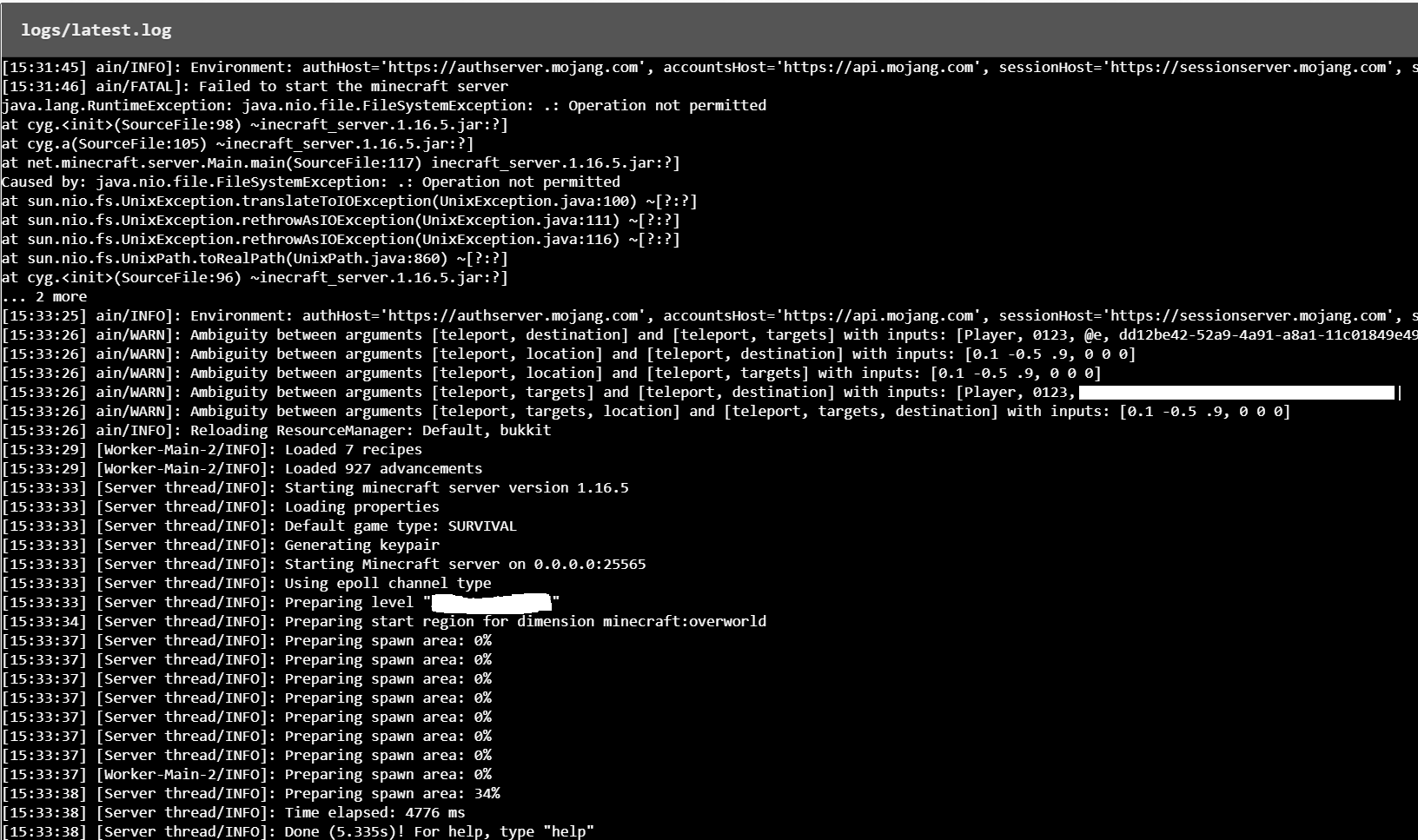

  5. Hello everyone. I just wanted to confirm for everyone that after upgrading to Unraid 6.9.2, both of my PaperMC Minecraft servers are working with NO Java errors and the MineOS container can now run WITHOUT setting "Privileged" On. Big props to @binhex here for all the work he does! To avoid any issues I recommend that you: 1) Stop any Minecraft servers first 2) Do a backup of them (archive not restore point) 4) Upgrade to Unraid 6.9.2 and reboot. 5) If your container is set to startup on boot, login to MineOS and Stop the servers once more. 6) Perform the docker update to the latest 7) After the update go into the docker image and turn off "Privileged" You will still get the warning message on the Minecraft logs about the 1.17 update stuff, but I'm sure binhex will deal with that once 1.17 is released. Enjoy everyone!

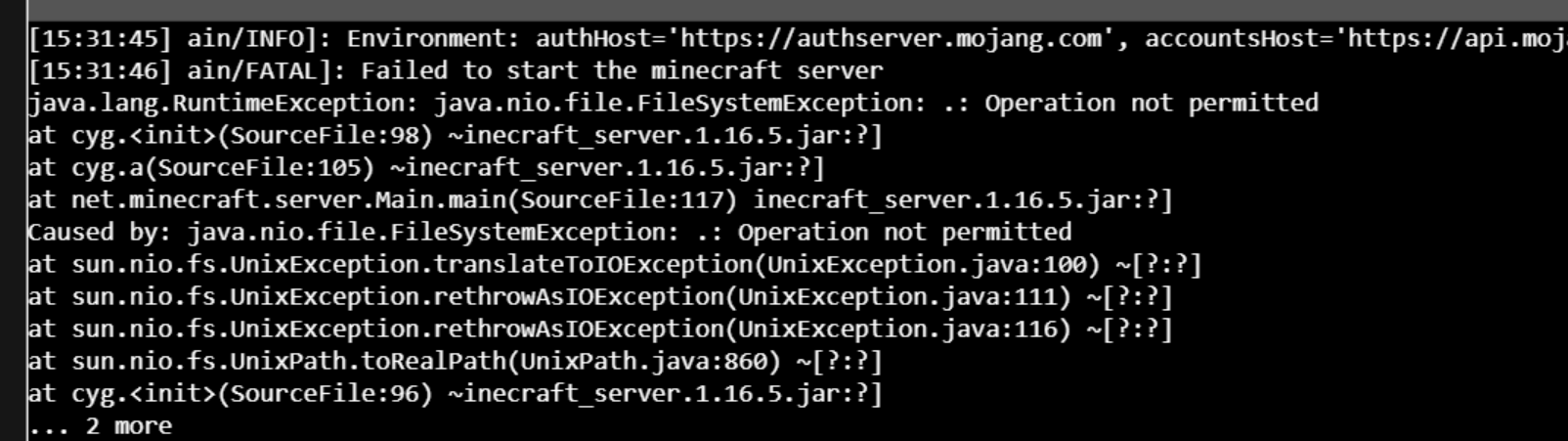

  6. Binhex: Thank you for all of the hard work you do! I just wanted to add a couple more notes: I'm running the image: binhex/arch-mineos-node:2cd410a44e4873ebb215048d51509be07bacd89a-01 Unraid 6.9.1 My java version is: I'm running papermc 1.16.5 for both of my Minecraft Servers. They both WORK on this image. But they ONLY work if the container is in "Privileged" mode. Otherwise I get the same issue as others above about "Operation not permitted". I'm not sure which MineOS image version these issues started at (I haven't tested).

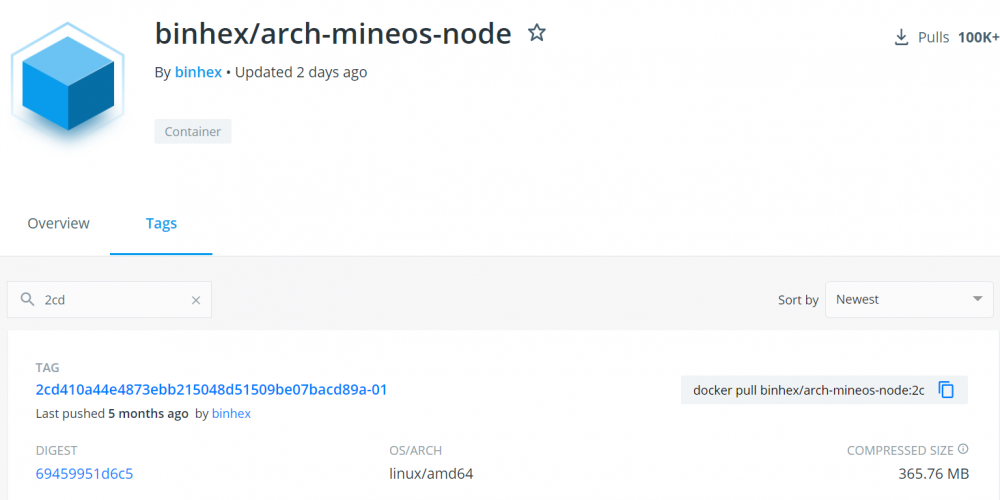

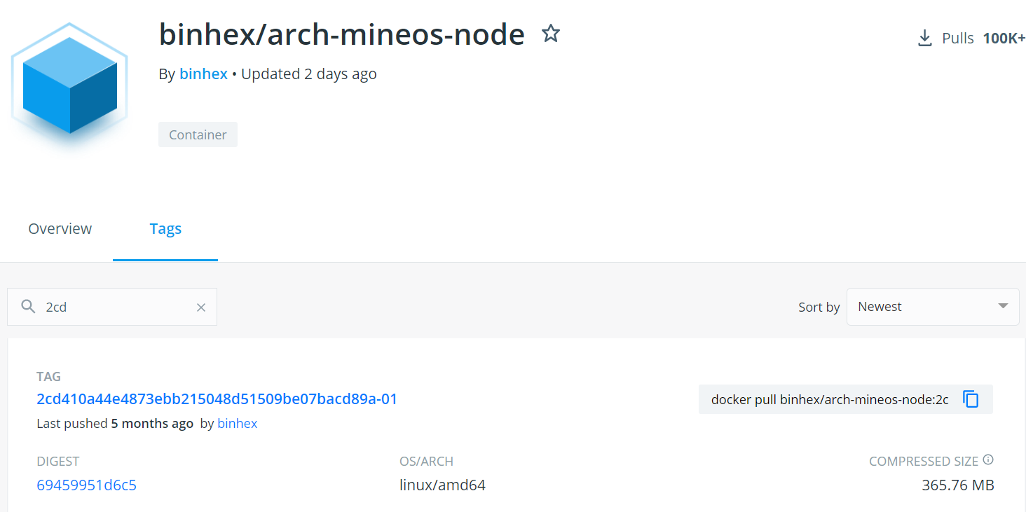

  8. After doing a lot of searching, I found this. I have the same issue as most of you with the Java errors when trying to start your Minecraft Server after the latest update to binhex's mineos. I also CAN CONFIRM that downgrading the image like user JKEJSER suggested WORKS!!! I should note that I am currently running Unraid Version 6.9.0 (I haven't updated to 6.9.1 yet. =/ ). Go here to grab that specific image: https://registry.hub.docker.com/r/binhex/arch-mineos-node/tags?page=1&ordering=last_updated&name=2cd 1) Just stop the current docker. 2) Open up the Server Terminal located at the top right of Unraid 3) Paste in the command to manually pull this image: docker pull binhex/arch-mineos-node:2cd410a44e4873ebb215048d51509be07bacd89a-01 4) The image will install with this specific Image ID. 5) Once done, make sure you open the container settings and turn on "Privileged" and click Done. 6) Start the container back up and log back into MineOS. Make note of the image ID after logging in at the top right under the login to confirm it loaded the correct image: 7) Start the server backup!
