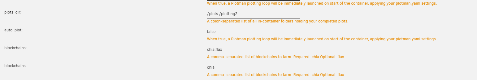

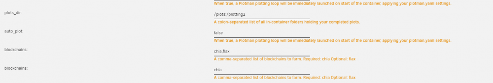

  6. Hey, thanks for replying and also thanks for developing this. For the record, the 'culprit' is the 2nd entry of plots_dir which doesn't have an edit button. That being said, I did change this one to the correct value (along with the first one). I also had to go into config.yaml and and manually add the 2nd folder. Now I have this in there: plot_directories: - /plotting2 - /plots - /plots,/plotting2 Everything works as intended now and I do see everything properly listed on the farming page. Thanks!
  7. thanks. I did look around and took note of the issue with duplicate variables. I have ‘plots_dir’ twice but when I run it, the command outputs to -e ‘/plots’=‘/plots:/plots2’. Somehow it’s dropping the _dir. I still seem to have the issue but it’s not a big deal, I think it’s farming properly still.
