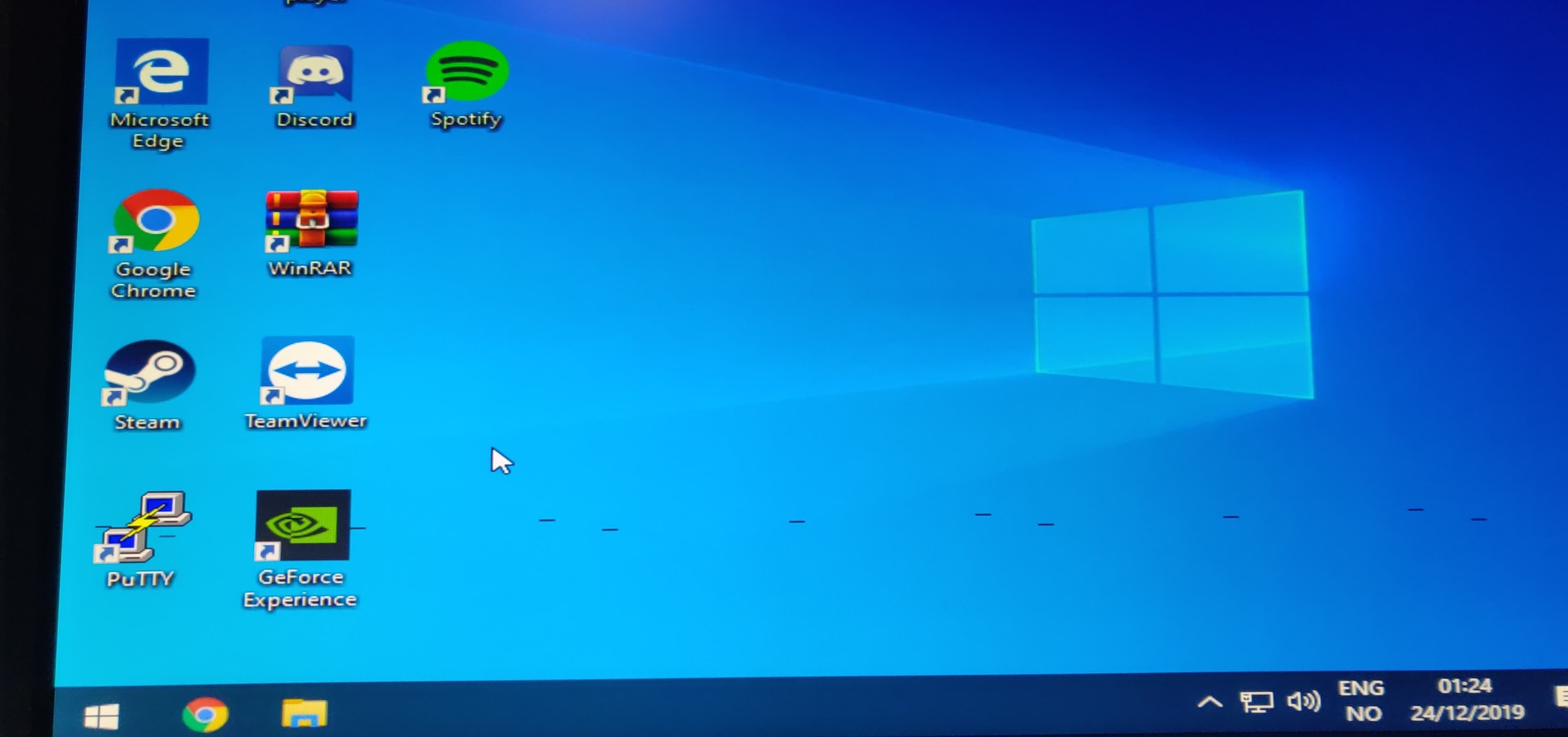

  2. I have tried to do steps mentioned in this video about multifunction but that does not help, I also tried making a seperate Windows VM with Q35 and that did not help either This did not work either. I just dont understand guys, let me know if there is some tech info missing and I will post it
