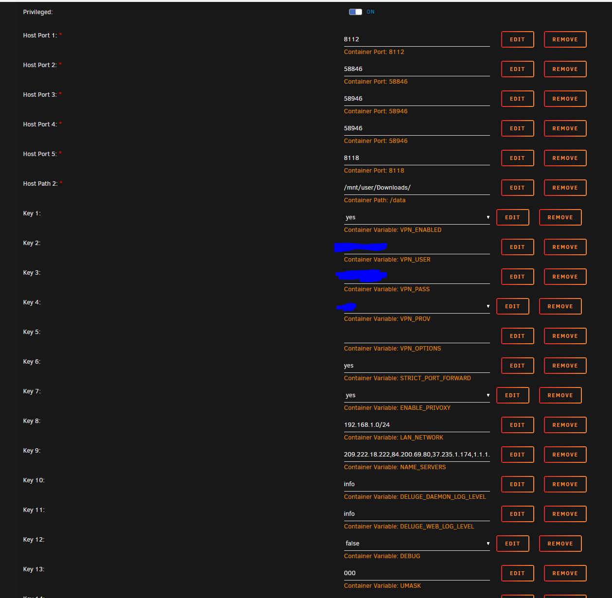

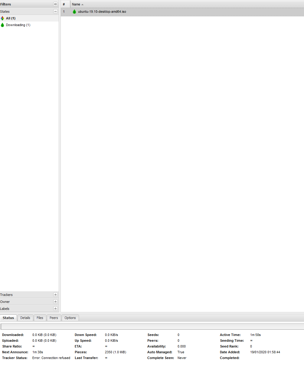

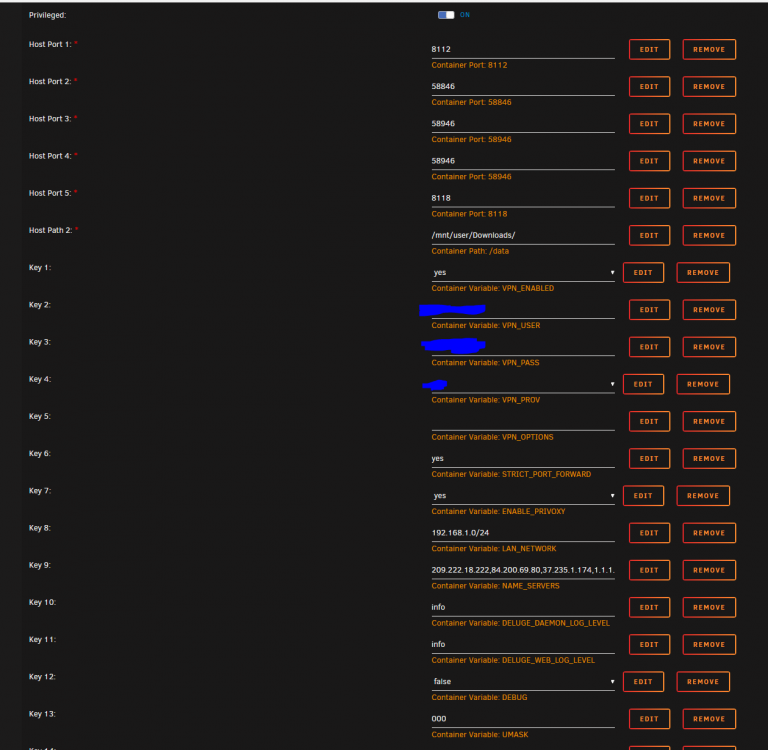

  4. Hello, I just started having this issue where it will not connect to any tracker, and no torrents work. The UI shows a Error: Authorative host not found; then shortly there after it says Error: Connection refused. I have attached picutures and logs of the error. I have tried re-downloading the the open vpn config/cert files, uninstalling and re-installing the docker but still the same issue. Noticed this about a week ago. Created by... ___. .__ .__ \_ |__ |__| ____ | |__ ____ ___ ___ | __ \| |/ \| | \_/ __ \\ \/ / | \_\ \ | | \ Y \ ___/ > < |___ /__|___| /___| /\___ >__/\_ \ \/ \/ \/ \/ \/ https://hub.docker.com/u/binhex/ 2020-01-18 21:38:07.714950 [info] System information Linux f2ed88915b73 4.19.88-Unraid #1 SMP Mon Dec 9 11:16:40 PST 2019 x86_64 GNU/Linux 2020-01-18 21:38:07.758980 [info] PUID defined as '99' 2020-01-18 21:38:07.907210 [info] PGID defined as '100' 2020-01-18 21:38:08.141160 [info] UMASK defined as '000' 2020-01-18 21:38:08.170928 [info] Permissions already set for volume mappings 2020-01-18 21:38:08.217063 [info] DELUGE_DAEMON_LOG_LEVEL defined as 'info' 2020-01-18 21:38:08.249767 [info] DELUGE_WEB_LOG_LEVEL defined as 'info' 2020-01-18 21:38:08.285385 [info] VPN_ENABLED defined as 'yes' 2020-01-18 21:38:08.332381 [info] OpenVPN config file (ovpn extension) is located at /config/openvpn/CA Toronto.ovpn 2020-01-18 21:38:08.418733 [info] VPN remote line defined as 'remote ca-toronto.privateinternetaccess.com 1198' 2020-01-18 21:38:08.455975 [info] VPN_REMOTE defined as 'ca-toronto.privateinternetaccess.com' 2020-01-18 21:38:08.490549 [info] VPN_PORT defined as '1198' 2020-01-18 21:38:08.528158 [info] VPN_PROTOCOL defined as 'udp' 2020-01-18 21:38:08.558831 [info] VPN_DEVICE_TYPE defined as 'tun0' 2020-01-18 21:38:08.585099 [info] VPN_PROV defined as 'pia' 2020-01-18 21:38:08.611793 [info] LAN_NETWORK defined as '192.168.1.0/24' 2020-01-18 21:38:08.638098 [info] NAME_SERVERS defined as '84.200.69.80,37.235.1.174,1.1.1.1,209.222.18.218,37.235.1.177,84.200.70.40' 2020-01-18 21:38:08.670693 [info] VPN_USER defined as 'myuid' 2020-01-18 21:38:08.702973 [info] VPN_PASS defined as 'mypwd' 2020-01-18 21:38:08.735579 [info] VPN_OPTIONS not defined (via -e VPN_OPTIONS) 2020-01-18 21:38:08.763552 [info] STRICT_PORT_FORWARD defined as 'yes' 2020-01-18 21:38:08.790918 [info] ENABLE_PRIVOXY defined as 'yes' 2020-01-18 21:38:08.841284 [info] Deleting files in /tmp (non recursive)... 2020-01-18 21:38:08.867187 [info] Starting Supervisor... 2020-01-18 21:38:09,104 INFO Included extra file "/etc/supervisor/conf.d/delugevpn.conf" during parsing 2020-01-18 21:38:09,104 INFO Set uid to user 0 succeeded 2020-01-18 21:38:09,107 INFO supervisord started with pid 6 2020-01-18 21:38:10,109 INFO spawned: 'start-script' with pid 168 2020-01-18 21:38:10,111 INFO spawned: 'watchdog-script' with pid 169 2020-01-18 21:38:10,112 INFO reaped unknown pid 7 2020-01-18 21:38:10,117 DEBG 'start-script' stdout output: [info] VPN is enabled, beginning configuration of VPN 2020-01-18 21:38:10,117 INFO success: start-script entered RUNNING state, process has stayed up for > than 0 seconds (startsecs) 2020-01-18 21:38:10,117 INFO success: watchdog-script entered RUNNING state, process has stayed up for > than 0 seconds (startsecs) 2020-01-18 21:38:10,217 DEBG 'start-script' stdout output: [info] Default route for container is 172.17.0.1 2020-01-18 21:38:10,222 DEBG 'start-script' stdout output: [info] Adding 84.200.69.80 to /etc/resolv.conf 2020-01-18 21:38:10,226 DEBG 'start-script' stdout output: [info] Adding 37.235.1.174 to /etc/resolv.conf 2020-01-18 21:38:10,230 DEBG 'start-script' stdout output: [info] Adding 1.1.1.1 to /etc/resolv.conf 2020-01-18 21:38:10,234 DEBG 'start-script' stdout output: [info] Adding 209.222.18.218 to /etc/resolv.conf 2020-01-18 21:38:10,238 DEBG 'start-script' stdout output: [info] Adding 37.235.1.177 to /etc/resolv.conf 2020-01-18 21:38:10,241 DEBG 'start-script' stdout output: [info] Adding 84.200.70.40 to /etc/resolv.conf 2020-01-18 21:38:10,430 DEBG 'start-script' stdout output: [info] Docker network defined as 172.17.0.0/16 2020-01-18 21:38:10,434 DEBG 'start-script' stdout output: [info] Adding 192.168.1.0/24 as route via docker eth0 2020-01-18 21:38:10,436 DEBG 'start-script' stdout output: [info] ip route defined as follows... -------------------- 2020-01-18 21:38:10,437 DEBG 'start-script' stdout output: default via 172.17.0.1 dev eth0 172.17.0.0/16 dev eth0 proto kernel scope link src 172.17.0.2 192.168.1.0/24 via 172.17.0.1 dev eth0 2020-01-18 21:38:10,437 DEBG 'start-script' stdout output: -------------------- 2020-01-18 21:38:10,440 DEBG 'start-script' stdout output: iptable_mangle 16384 1 ip_tables 24576 3 iptable_filter,iptable_nat,iptable_mangle 2020-01-18 21:38:10,441 DEBG 'start-script' stdout output: [info] iptable_mangle support detected, adding fwmark for tables 2020-01-18 21:38:10,503 DEBG 'start-script' stdout output: [info] iptables defined as follows... -------------------- 2020-01-18 21:38:10,505 DEBG 'start-script' stdout output: -P INPUT DROP -P FORWARD DROP -P OUTPUT DROP -A INPUT -s 172.17.0.0/16 -d 172.17.0.0/16 -j ACCEPT -A INPUT -i eth0 -p udp -m udp --sport 1198 -j ACCEPT -A INPUT -i eth0 -p tcp -m tcp --dport 8112 -j ACCEPT -A INPUT -i eth0 -p tcp -m tcp --sport 8112 -j ACCEPT -A INPUT -s 192.168.1.0/24 -i eth0 -p tcp -m tcp --dport 58846 -j ACCEPT -A INPUT -s 192.168.1.0/24 -d 172.17.0.0/16 -i eth0 -p tcp -j ACCEPT -A INPUT -p icmp -m icmp --icmp-type 0 -j ACCEPT -A INPUT -i lo -j ACCEPT -A INPUT -i tun0 -j ACCEPT -A OUTPUT -s 172.17.0.0/16 -d 172.17.0.0/16 -j ACCEPT -A OUTPUT -o eth0 -p udp -m udp --dport 1198 -j ACCEPT -A OUTPUT -o eth0 -p tcp -m tcp --dport 8112 -j ACCEPT -A OUTPUT -o eth0 -p tcp -m tcp --sport 8112 -j ACCEPT -A OUTPUT -d 192.168.1.0/24 -o eth0 -p tcp -m tcp --sport 58846 -j ACCEPT -A OUTPUT -s 172.17.0.0/16 -d 192.168.1.0/24 -o eth0 -p tcp -j ACCEPT -A OUTPUT -p icmp -m icmp --icmp-type 8 -j ACCEPT -A OUTPUT -o lo -j ACCEPT -A OUTPUT -o tun0 -j ACCEPT 2020-01-18 21:38:10,506 DEBG 'start-script' stdout output: -------------------- 2020-01-18 21:38:10,507 DEBG 'start-script' stdout output: [info] Starting OpenVPN... 2020-01-18 21:38:10,527 DEBG 'start-script' stdout output: Sat Jan 18 21:38:10 2020 WARNING: file 'credentials.conf' is group or others accessible Sat Jan 18 21:38:10 2020 OpenVPN 2.4.8 [git:makepkg/3976acda9bf10b5e+] x86_64-pc-linux-gnu [SSL (OpenSSL)] [LZO] [LZ4] [EPOLL] [PKCS11] [MH/PKTINFO] [AEAD] built on Oct 30 2019 Sat Jan 18 21:38:10 2020 library versions: OpenSSL 1.1.1d 10 Sep 2019, LZO 2.10 2020-01-18 21:38:10,527 DEBG 'start-script' stdout output: [info] OpenVPN started 2020-01-18 21:38:10,530 DEBG 'start-script' stdout output: Sat Jan 18 21:38:10 2020 NOTE: the current --script-security setting may allow this configuration to call user-defined scripts 2020-01-18 21:38:10,533 DEBG 'start-script' stdout output: Sat Jan 18 21:38:10 2020 TCP/UDP: Preserving recently used remote address: [AF_INET]172.98.67.91:1198 Sat Jan 18 21:38:10 2020 UDP link local: (not bound) Sat Jan 18 21:38:10 2020 UDP link remote: [AF_INET]172.98.67.91:1198 2020-01-18 21:38:10,661 DEBG 'start-script' stdout output: Sat Jan 18 21:38:10 2020 [5f36d0df1d243d7664c708226b428943] Peer Connection Initiated with [AF_INET]172.98.67.91:1198 2020-01-18 21:38:11,817 DEBG 'start-script' stdout output: Sat Jan 18 21:38:11 2020 TUN/TAP device tun0 opened Sat Jan 18 21:38:11 2020 /usr/bin/ip link set dev tun0 up mtu 1500 2020-01-18 21:38:11,819 DEBG 'start-script' stdout output: Sat Jan 18 21:38:11 2020 /usr/bin/ip addr add dev tun0 local 10.46.11.6 peer 10.46.11.5 2020-01-18 21:38:11,820 DEBG 'start-script' stdout output: Sat Jan 18 21:38:11 2020 /root/openvpnup.sh tun0 1500 1558 10.46.11.6 10.46.11.5 init 2020-01-18 21:38:11,828 DEBG 'start-script' stdout output: Sat Jan 18 21:38:11 2020 Initialization Sequence Completed 2020-01-18 21:38:11,953 DEBG 'start-script' stdout output: [info] Port forwarding is enabled [info] Checking endpoint 'ca-toronto.privateinternetaccess.com' is port forward enabled... 2020-01-18 21:38:11,962 DEBG 'start-script' stdout output: [info] Attempting to curl https://www.privateinternetaccess.com/vpninfo/servers?version=82... 2020-01-18 21:38:13,279 DEBG 'start-script' stdout output: [info] Curl successful for https://www.privateinternetaccess.com/vpninfo/servers?version=82, response code 200 2020-01-18 21:38:13,348 DEBG 'start-script' stdout output: [info] PIA endpoint 'ca-toronto.privateinternetaccess.com' is in the list of endpoints that support port forwarding 2020-01-18 21:38:13,348 DEBG 'start-script' stdout output: [info] List of PIA endpoints that support port forwarding:- [info] ca-toronto.privateinternetaccess.com [info] ca-montreal.privateinternetaccess.com [info] ca-vancouver.privateinternetaccess.com 2020-01-18 21:38:13,348 DEBG 'start-script' stdout output: [info] de-berlin.privateinternetaccess.com [info] de-frankfurt.privateinternetaccess.com [info] sweden.privateinternetaccess.com [info] swiss.privateinternetaccess.com [info] france.privateinternetaccess.com [info] czech.privateinternetaccess.com [info] spain.privateinternetaccess.com [info] ro.privateinternetaccess.com [info] israel.privateinternetaccess.com [info] Attempting to get dynamically assigned port... 2020-01-18 21:38:13,363 DEBG 'start-script' stdout output: [info] Attempting to curl http://209.222.18.222:2000/?client_id=d94e048d5fcaf9a0a06475e9c8d4217df176eac3b6a1ef5c9e2839060925dcf9... 2020-01-18 21:38:14,059 DEBG 'start-script' stdout output: [info] Curl successful for http://209.222.18.222:2000/?client_id=d94e048d5fcaf9a0a06475e9c8d4217df176eac3b6a1ef5c9e2839060925dcf9, response code 200 2020-01-18 21:38:14,089 DEBG 'start-script' stdout output: [info] Successfully assigned incoming port 24582 2020-01-18 21:38:14,090 DEBG 'start-script' stdout output: [info] Checking we can resolve name 'www.google.com' to address... 2020-01-18 21:38:14,119 DEBG 'start-script' stdout output: [info] DNS operational, we can resolve name 'www.google.com' to address '172.217.164.228' 2020-01-18 21:38:14,121 DEBG 'start-script' stdout output: [info] Attempting to get external IP using Name Server 'ns1.google.com'... 2020-01-18 21:38:14,521 DEBG 'start-script' stdout output: [info] Successfully retrieved external IP address 172.98.67.91 2020-01-18 21:38:14,987 DEBG 'watchdog-script' stdout output: [info] Deluge listening interface IP 0.0.0.0 and VPN provider IP 10.46.11.6 different, marking for reconfigure 2020-01-18 21:38:14,992 DEBG 'watchdog-script' stdout output: [info] Deluge not running 2020-01-18 21:38:14,996 DEBG 'watchdog-script' stdout output: [info] Deluge Web UI not running 2020-01-18 21:38:14,999 DEBG 'watchdog-script' stdout output: [info] Privoxy not running 2020-01-18 21:38:15,000 DEBG 'watchdog-script' stdout output: [info] Deluge incoming port 6890 and VPN incoming port 24582 different, marking for reconfigure 2020-01-18 21:38:15,000 DEBG 'watchdog-script' stdout output: [info] Attempting to start Deluge... 2020-01-18 21:38:15,000 DEBG 'watchdog-script' stdout output: [info] Removing deluge pid file (if it exists)... 2020-01-18 21:38:15,400 DEBG 'watchdog-script' stdout output: [info] Deluge key 'listen_interface' currently has a value of '10.2.11.10' [info] Deluge key 'listen_interface' will have a new value '10.46.11.6' [info] Writing changes to Deluge config file '/config/core.conf'... 2020-01-18 21:38:15,649 DEBG 'watchdog-script' stdout output: [info] Deluge key 'outgoing_interface' currently has a value of 'tun0' [info] Deluge key 'outgoing_interface' will have a new value 'tun0' [info] Writing changes to Deluge config file '/config/core.conf'... 2020-01-18 21:38:15,859 DEBG 'watchdog-script' stdout output: [info] Deluge key 'default_daemon' currently has a value of '43f602c0073a4c86a9433b9b76f85101' [info] Deluge key 'default_daemon' will have a new value '43f602c0073a4c86a9433b9b76f85101' [info] Writing changes to Deluge config file '/config/web.conf'... 2020-01-18 21:38:16,223 DEBG 'watchdog-script' stdout output: [info] Deluge process started [info] Waiting for Deluge process to start listening on port 58846... 2020-01-18 21:38:16,454 DEBG 'watchdog-script' stdout output: [info] Deluge process listening on port 58846 2020-01-18 21:38:16,775 DEBG 'watchdog-script' stderr output: Unable to initialize gettext/locale! 2020-01-18 21:38:16,776 DEBG 'watchdog-script' stderr output: 'ngettext' Traceback (most recent call last): File "/usr/lib/python3.8/site-packages/deluge/i18n/util.py", line 118, in setup_translation builtins.__dict__['_n'] = builtins.__dict__['ngettext'] KeyError: 'ngettext' 2020-01-18 21:38:19,124 DEBG 'watchdog-script' stdout output: Setting "random_port" to: False Configuration value successfully updated. 2020-01-18 21:38:19,537 DEBG 'watchdog-script' stderr output: Unable to initialize gettext/locale! 2020-01-18 21:38:19,538 DEBG 'watchdog-script' stderr output: 'ngettext' Traceback (most recent call last): File "/usr/lib/python3.8/site-packages/deluge/i18n/util.py", line 118, in setup_translation builtins.__dict__['_n'] = builtins.__dict__['ngettext'] KeyError: 'ngettext' 2020-01-18 21:38:21,524 DEBG 'watchdog-script' stdout output: Setting "listen_ports" to: (24582, 24582) Configuration value successfully updated. 2020-01-18 21:38:21,951 DEBG 'watchdog-script' stderr output: Unable to initialize gettext/locale! 2020-01-18 21:38:21,952 DEBG 'watchdog-script' stderr output: 'ngettext' Traceback (most recent call last): File "/usr/lib/python3.8/site-packages/deluge/i18n/util.py", line 118, in setup_translation builtins.__dict__['_n'] = builtins.__dict__['ngettext'] KeyError: 'ngettext' 2020-01-18 21:38:24,357 DEBG 'watchdog-script' stdout output: [info] No torrents with state 'Error' found 2020-01-18 21:38:24,357 DEBG 'watchdog-script' stdout output: [info] Starting Deluge Web UI... [info] Deluge Web UI started 2020-01-18 21:38:24,365 DEBG 'watchdog-script' stdout output: [info] Attempting to start Privoxy... 2020-01-18 21:38:24,653 DEBG 'watchdog-script' stderr output: Unable to initialize gettext/locale! 2020-01-18 21:38:24,653 DEBG 'watchdog-script' stderr output: 'ngettext' Traceback (most recent call last): File "/usr/lib/python3.8/site-packages/deluge/i18n/util.py", line 118, in setup_translation builtins.__dict__['_n'] = builtins.__dict__['ngettext'] KeyError: 'ngettext' 2020-01-18 21:38:25,373 DEBG 'watchdog-script' stdout output: [info] Privoxy process started [info] Waiting for Privoxy process to start listening on port 8118... 2020-01-18 21:38:25,382 DEBG 'watchdog-script' stdout output: [info] Privoxy process listening on port 8118
