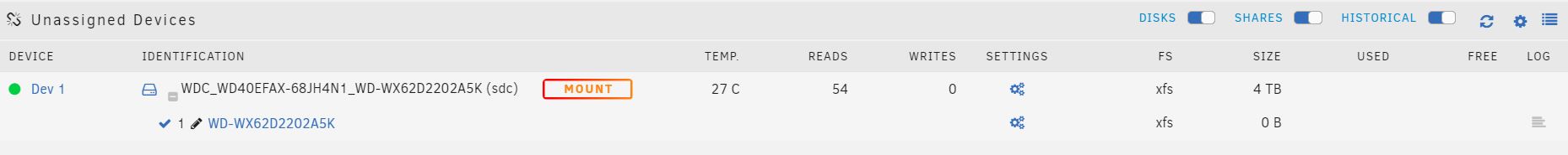

Thanks for the confirmation! I followed your steps very carefully and I can see disk3 mounted now and the contents are there! So current state is the array is started and we just have the new disk4 unassigned and that's showing as "Not Installed....Unmountable: not mounted". Diagnostics attached. Awaiting further instructions. Cheers! tower-diagnostics-20221006-1803.zip

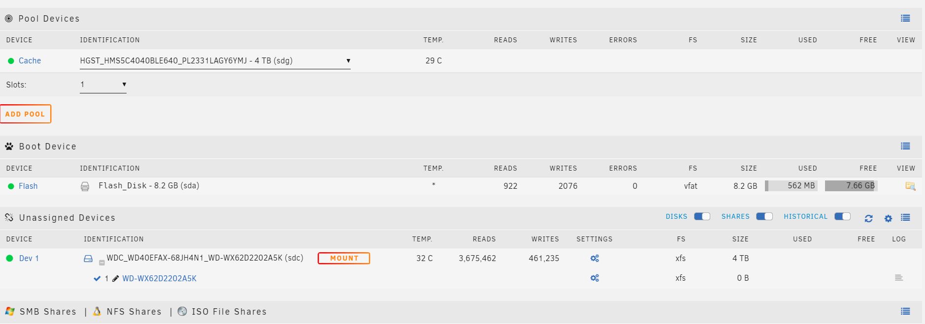

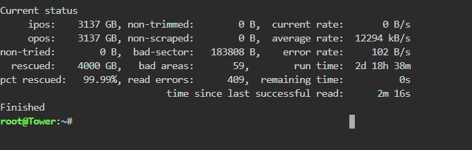

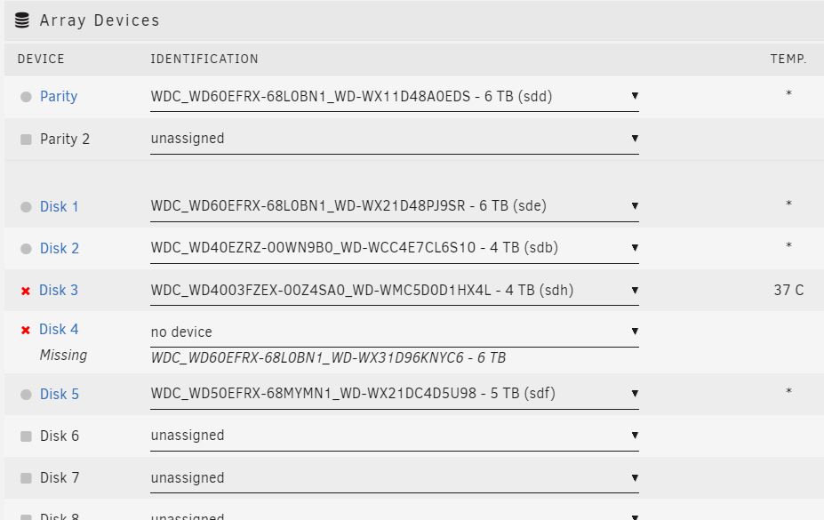

Process has completed...please see attached. (Both instances are gone from processes now). Just to recap where we're at now.... -Single Parity -Both Disk3 and Disk4 are listed as disabled, contents emulated. - Disk4 is "missing" because i physically removed it. This is the one that was clicking and i couldn't get UNRAID to recognize it. -Bought a replacement disk (sdc) and ran ddrescue to rescue contents from disk3. DDrescue process now finished. Please assist me with step by step instructions on how to proceed further! Many thanks for the attention and assistance!

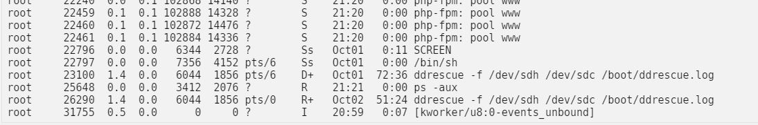

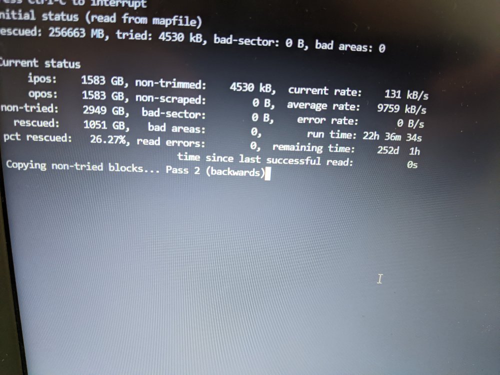

Okay i've got a question here...This is at 71.33% now...but i was looking at processes in Unraid and i noticed there are 2 of these processes running.....I've only got 1 terminal open unless when i used screen the other one kept running in the background??? I can see different Start dates for both processes...did i mess up here and that's why this is taking so long? However with that said...it's been going faster the last couple of hours...up 10% in one hour and i haven't touched anything....

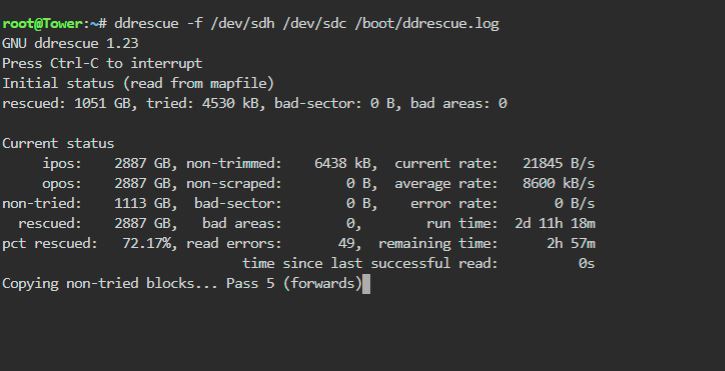

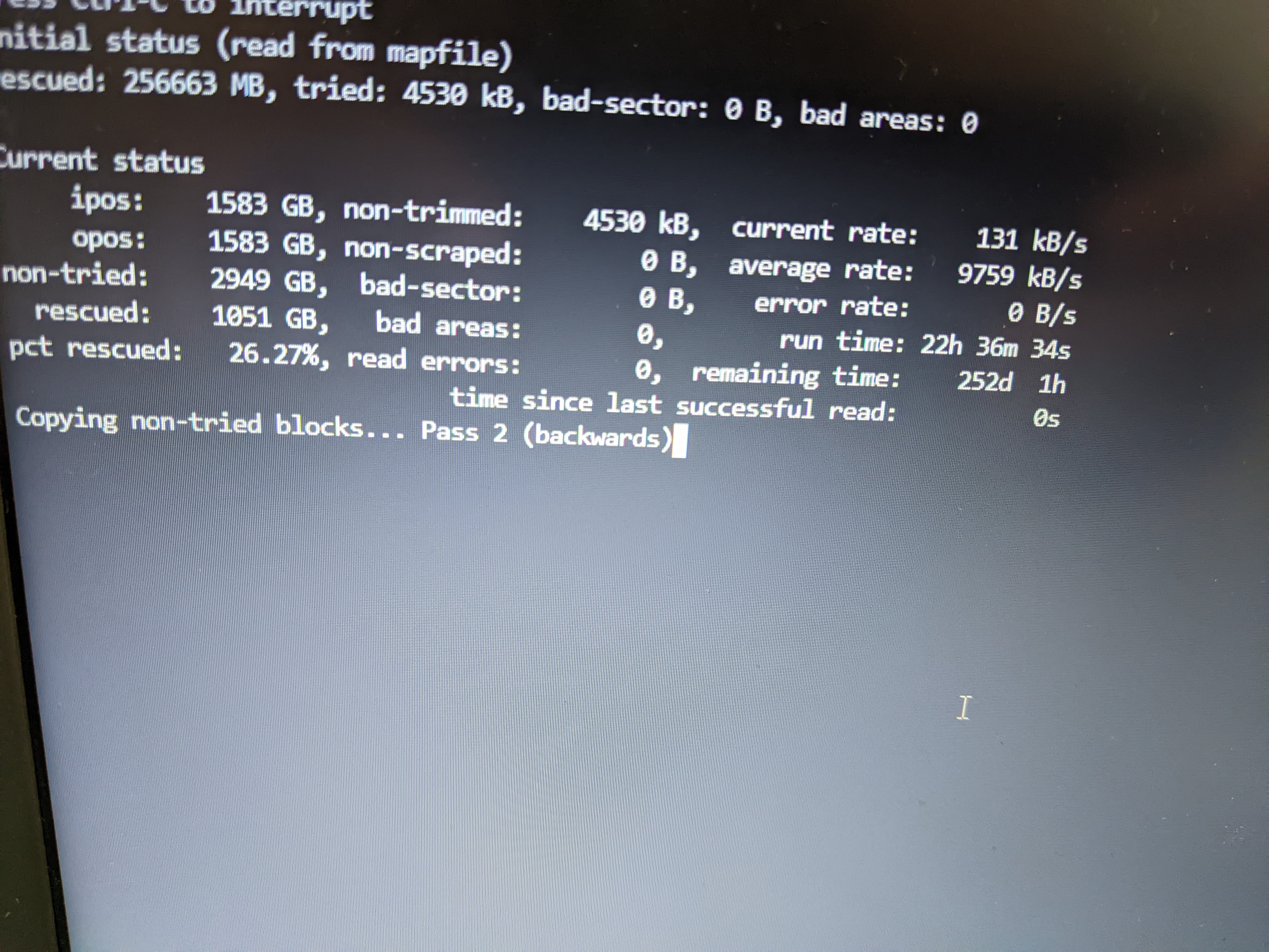

I'll definitely need help with the step by step after the rescue is done. This is taking incredibly long... It went up 3% overnight. Normal?

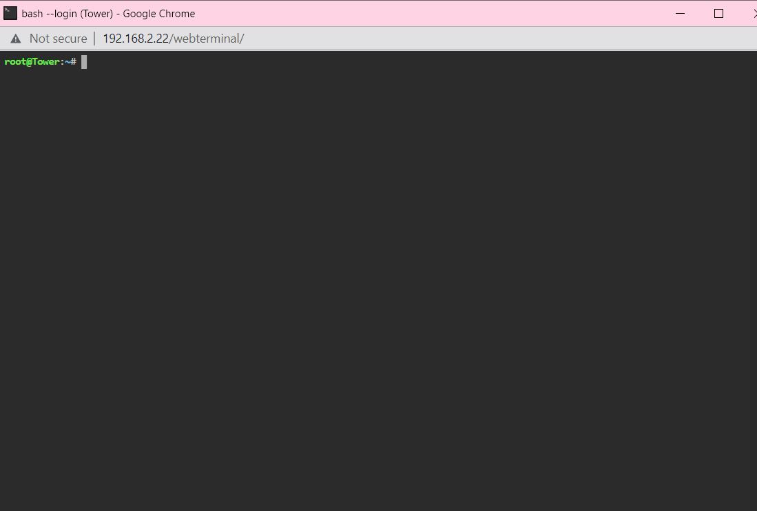

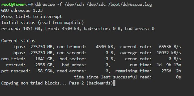

I can't tell if this process is still going....i entered this command "ddrescue -f /dev/sdh /dev/sdc /boot/ddrescue.log" and left it to run but looks like it either completed or timed out when my pc went to sleep...i issued this command again in the terminal and it started..i went away and came back and after a cpl hours and the terminal is blank just back at root...it does look like it wrote something as i see writes to the disk...is there any way to tell if this finished? Should i issue the command again (I'll change my laptop to not sleep, i don't know why that would cause the terminal to end though) ? Thank you kindly for your time and assistance. tower-diagnostics-20220930-1634.zip

Okay, I've read that post and trying to lay out the steps. Please excuse my ignorance as I don't okay around with unraid frequently. I picked up a replacement disk for disk 3 and I've got ddrescue running now. Once that is done that essentially becomes the new disk3 which had the bad sectors. So I'd now shut down the system. Remove the old disk3, do a new configuration, assign this new replacement disk as disk 3 and rebuild the array? That essentially salvages whatever I had on disk 3. So because parity is still fine the thinking is that it would be able to rebuild the contents of the dead disk 4? Would I need to add another replacement disk for disk4 or will it rebuild from parity with the existing disks?
