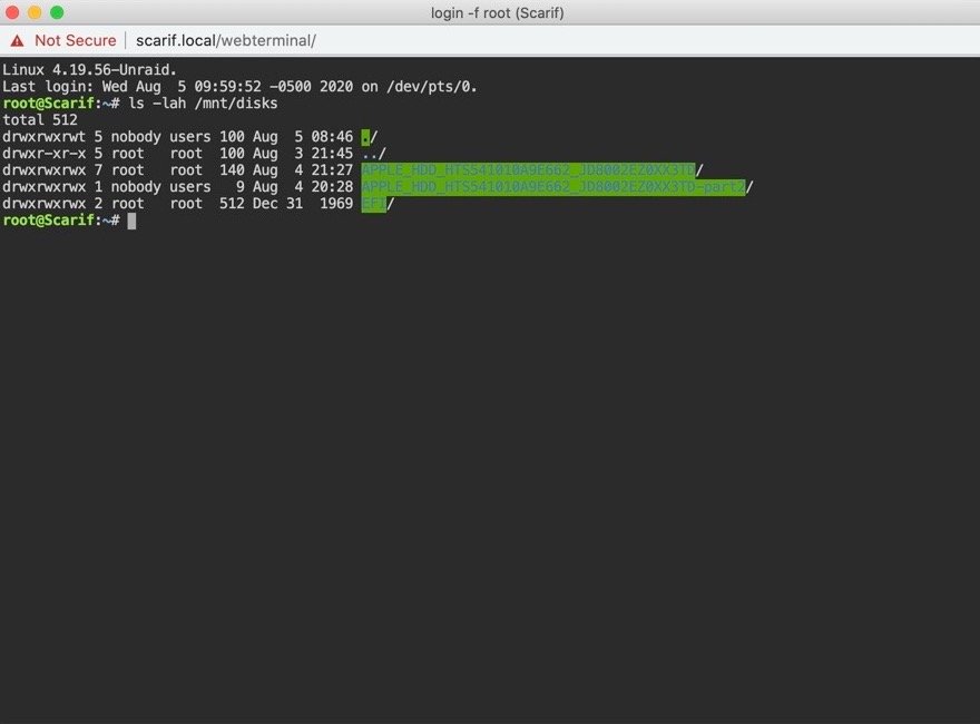

  2. Error is rsync: write failed on "/mnt/disks/APPLE_HDD_HTS_541010A9E662_JD8002EZOXX3TD": No space left on device (28) rsync error: error in file IO (code 11) at receiver.c(374) [receiver=3.1.3]

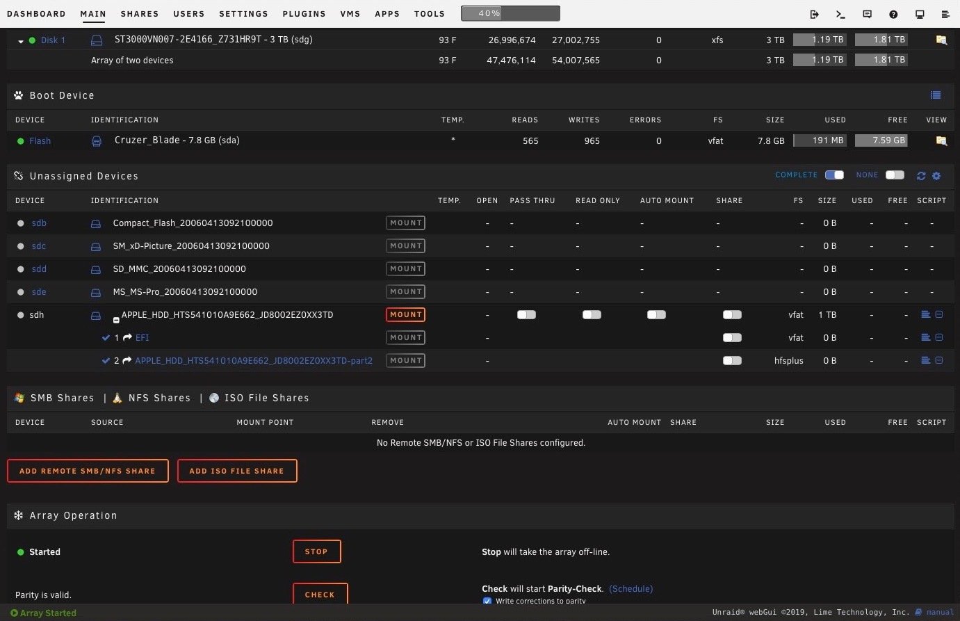

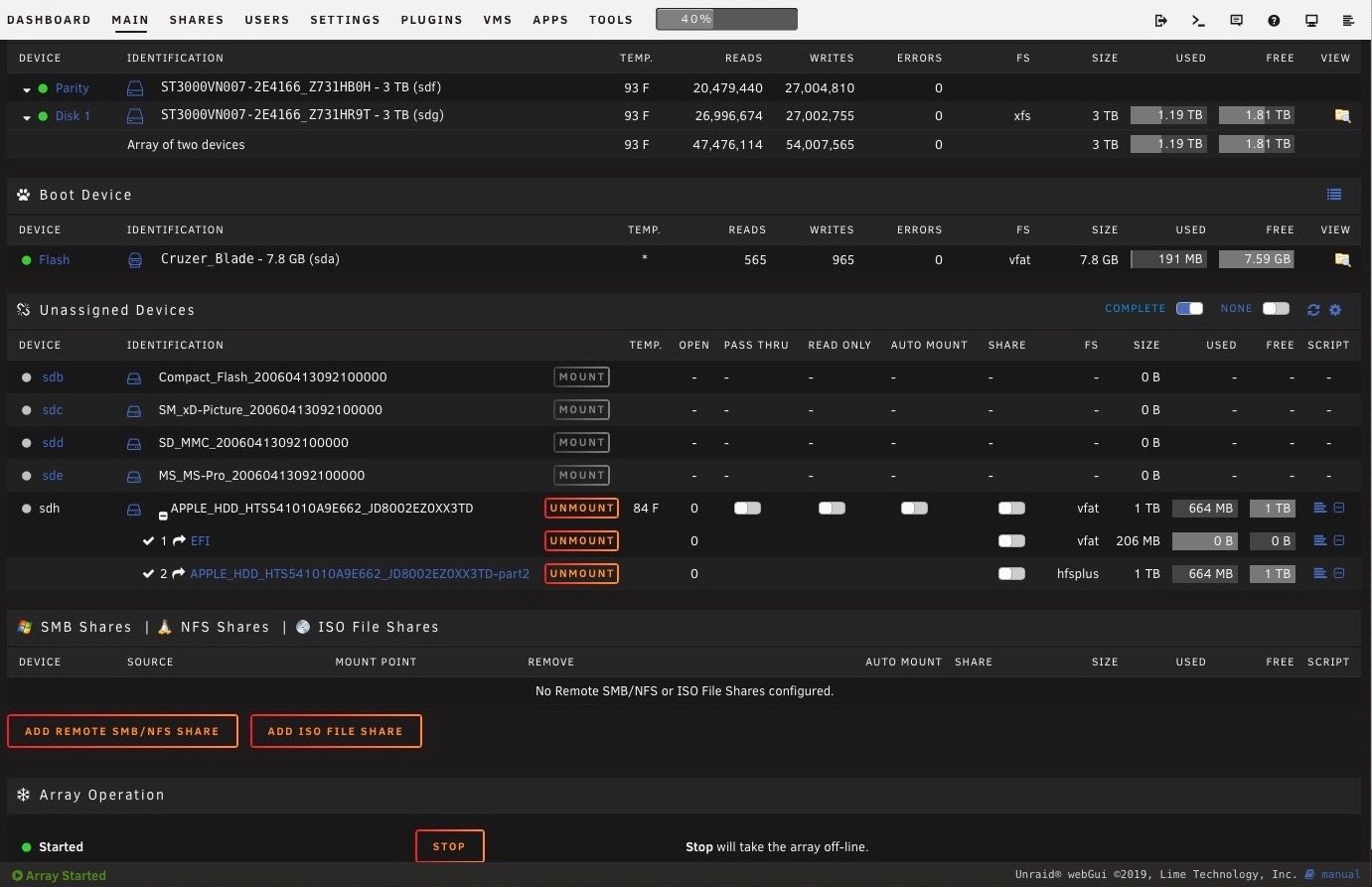

  3. Apologies, it was the one with the serial number but in order to condense, I replaced the serial number with "drive" Here is an image with the drive mounted.
  4. I'm away from my network right now, and had someone send me the screenshot, so while in the image the drive isn't mounted, when I was running rsync, both partitions were mounted. EFI had something like 11MB used of 212MB and the other about 600MB out of 1TB.
