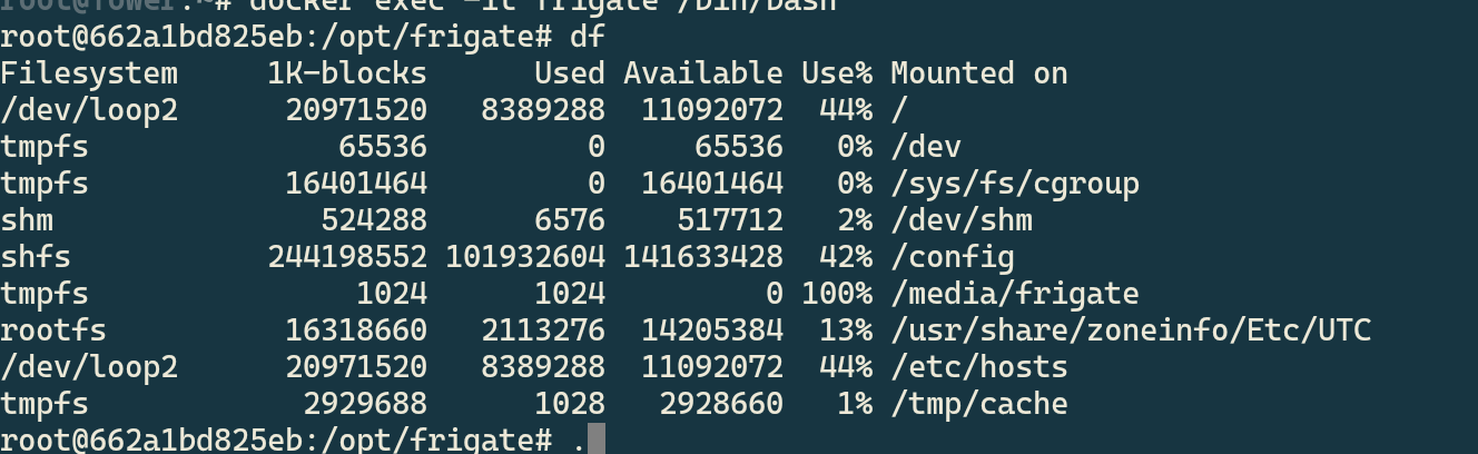

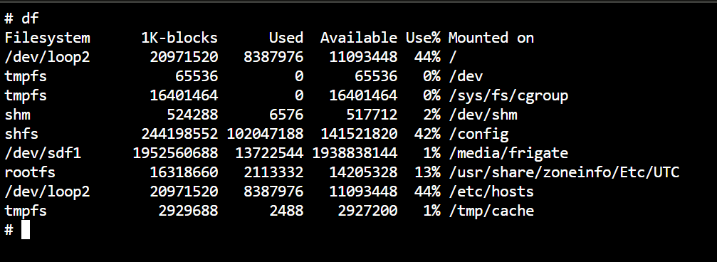

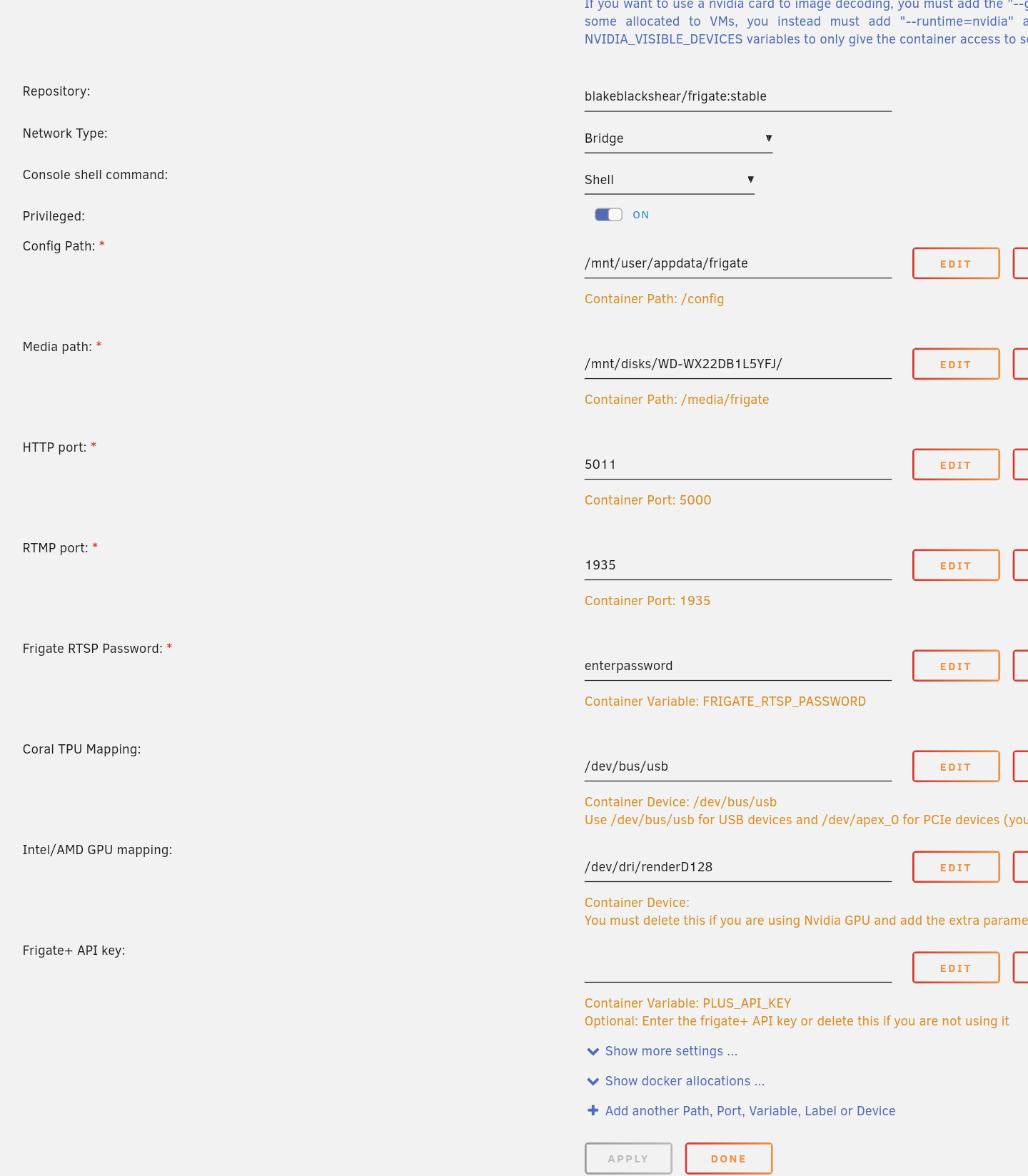

  1. Ok what I did tonight is just click the mount button next to the drive in unassigned devices (I am still a noob) and I've changed the access mode of the /media/frigate folder in the docker configuration to read/write slave and everything booted up correctly! Finger crossed and I'll see if everything is still ok tomorrow

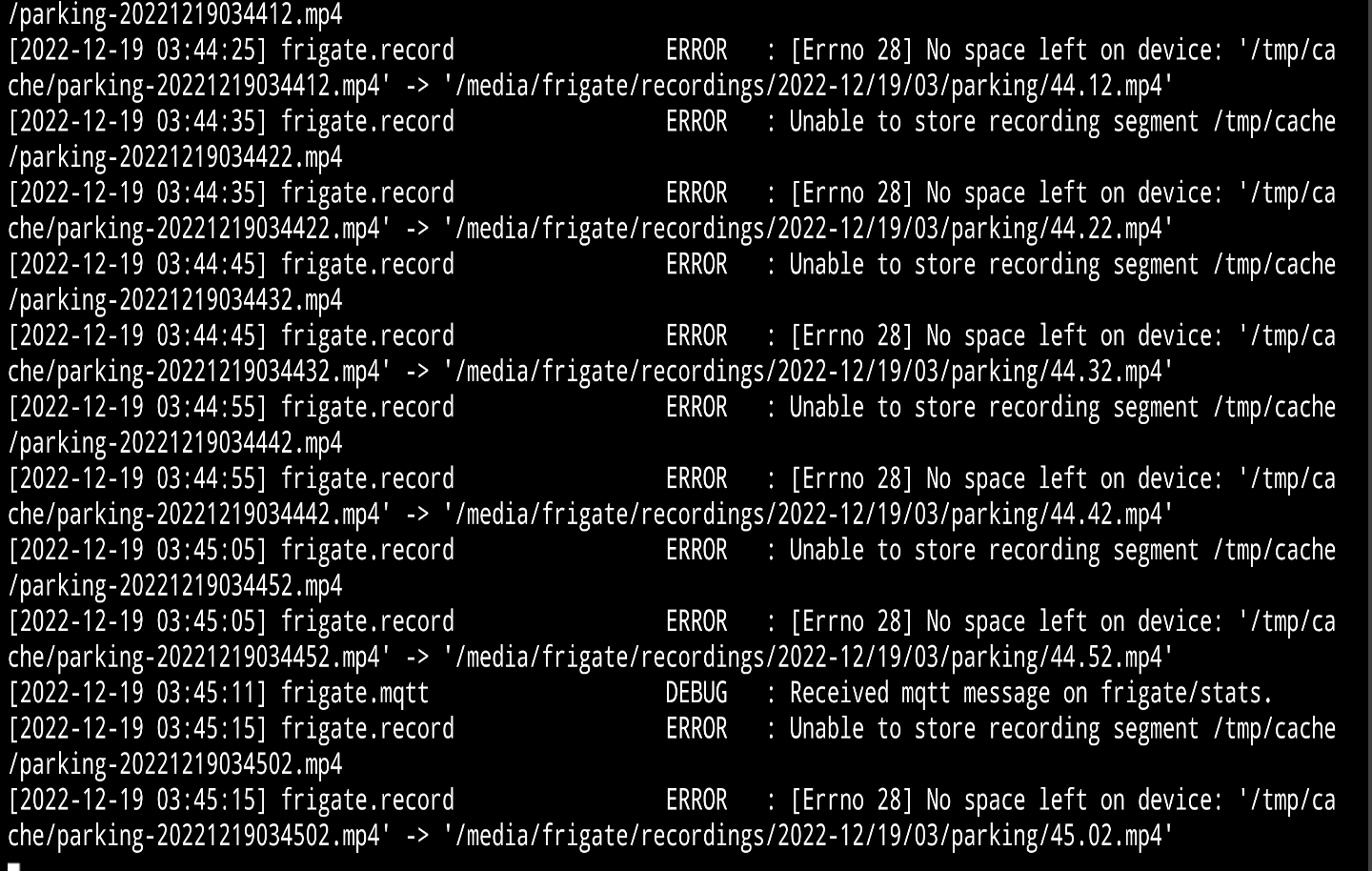

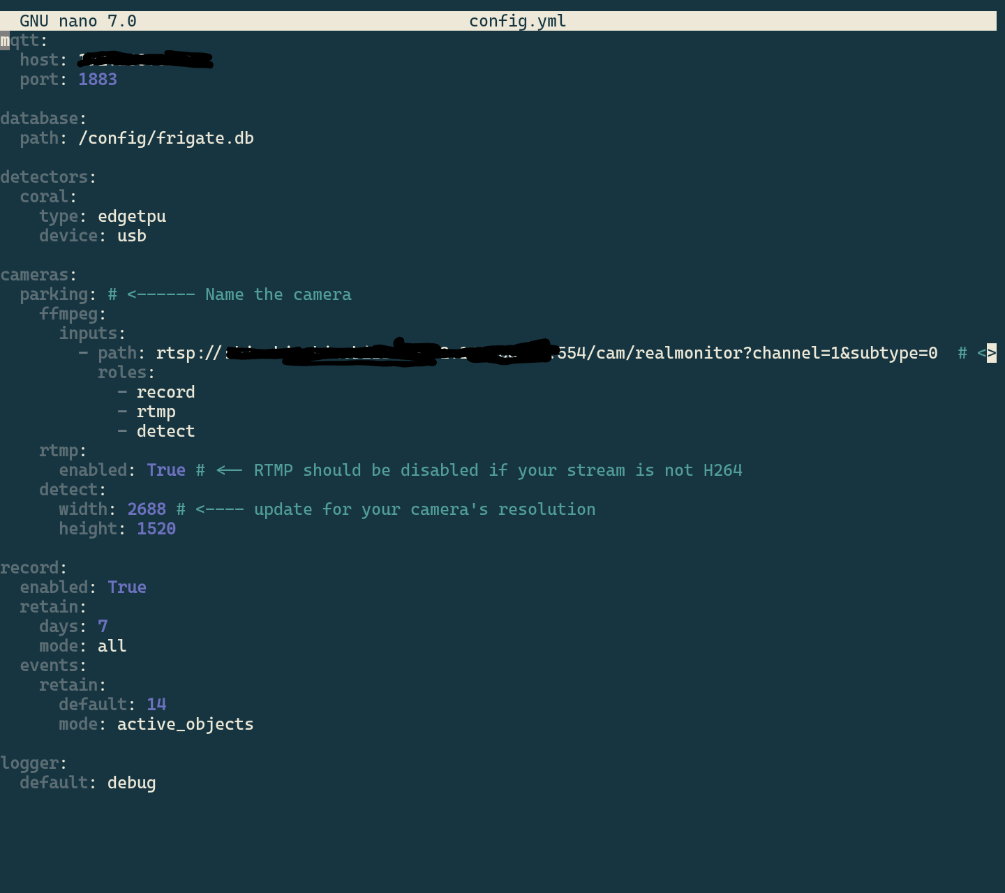

  2. Hi, I'm having problems with the Frigate Docker container. I've tried to troubleshoot as much as I can but I can't fix it. Everytime I start a fresh install it seems to work fine (detection with Coral and recording) but after a couple hours I get this storage error in the log : Errno 28 - No space left om device. I am passing a freshly formated 2 TB hard drive that is clearly not full. I also tried tweaking the tmpfs size from 1gb to 3gb for the /tmp/cache folder and it isn't working. I don't know what to do next
