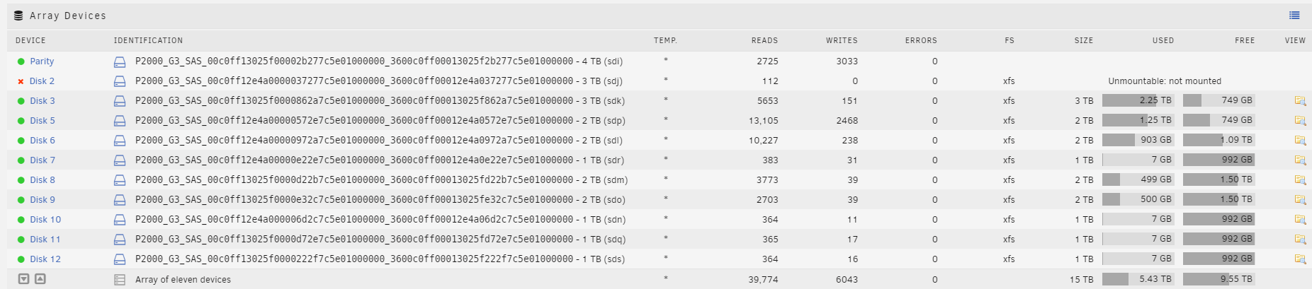

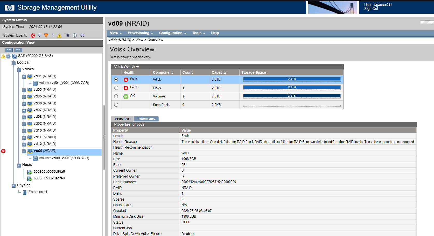

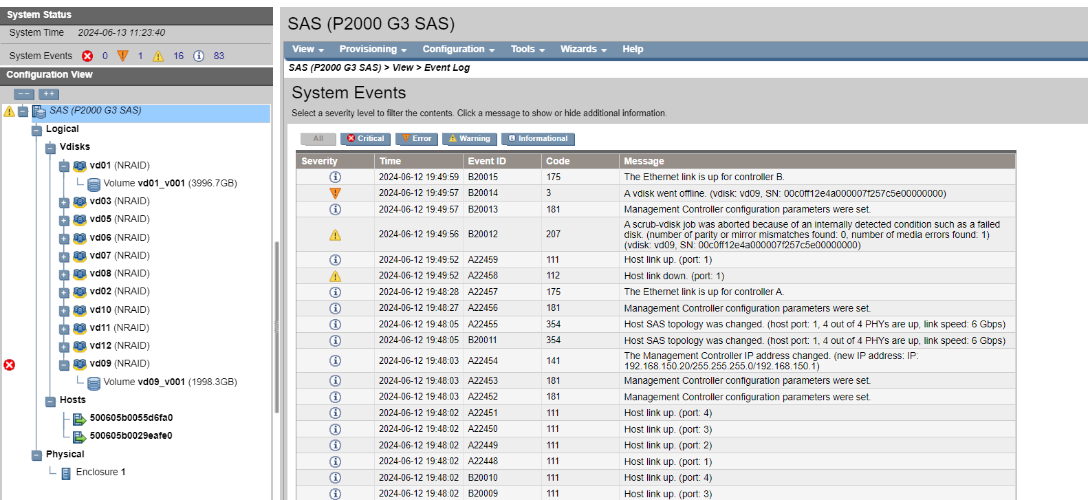

  1. The enclosure (P2000) is connected to the unraid server (DL360 G7) using the P2000 SAS connection. Each of the disks in the P2000 are a separate VDISK/Volume from each other. These vdisk are presented to Unraid as the disks used in the array. However, I have some new information from the P2000 enclosure. Unraid Disk5/P2000 Disk 9 is now throwing a fault. With Unraid Disk 2 not being completely rebuilt, I think I may have just lost all the information on those two disks since I cant rebuild either of them from only one parity drive.

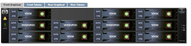

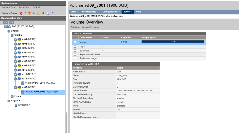

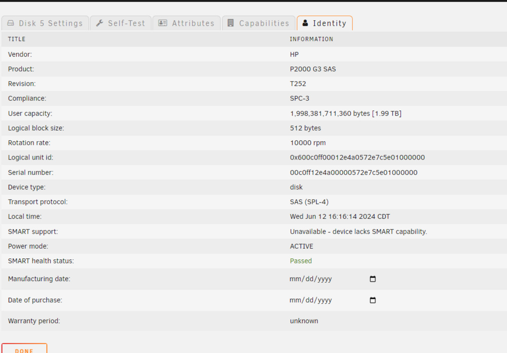

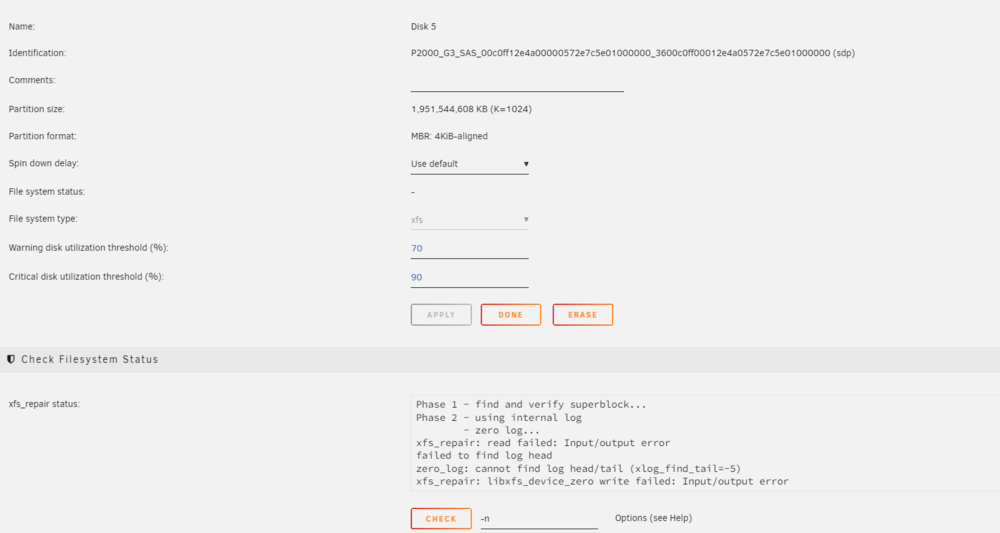

  3. The hard drive is in a HPE P2000 G3 Array. That system does not show anything about SMART capability that I can find. Also Unraid says that drive does not have SMART capability. I have attached pics of the systems. Note: Unraid is Disk 5 and Array is Disk 9.
  4. Here is SMART report for Disk5. tower-smart-20240612-0807.zip
  5. I think I might be screwed, but I wanted to get another opinion. I had Disk 2 go down. I got it back up and started rebuilding it. Left that to go over night and it hanged midway. So I reboot the system and start in maintenance mode. Disk 2 is disabled and emulated. Rebooted again, array attempted to start but then Disk 5 went "unmountable unsupported or no file system". Disk 5 is throwing errors everywhere, so I run a xfs_repair. It had issues ran it then with -n and it had issues and suggested running with -L. Did that and got another error. So now I think my disk 2 is emulated and disk 5 might be dead. Did I lose the entire array or is there a way to mitigate the damage and only lose information on disk 5 or disk2&5? tower-diagnostics-20240612-0652.zip tower-syslog-20240612-1103.zip
  6. Ok so I figured it out eventually and I am posting a follow-up with my solution to help anyone else that might be having the same issue. Edit from Itimpi below: Stopped the array Started the array in maintenance mode, went to disk and ran a check. Once check was done, I ran the same check but this time with no -n. Stop the array in maintenance mode Started the array normally Stop the array Remove the disk from the array Start the array normally so the disk will be registered as missing Stop the array Reassign the disk Start the array to begin rebuilding Wait for the rebuild to complete

  8. I started the arrary in maintenance mode like the documentation said and ran a check. Under "Running the Test using the webGui" and step 8 it says to come back to forums. So here is the output attached. I am unsure about the output however. Is the HDD dead, dieing, or should I continue the "Repairing a File System" section? HDD Check.txt
