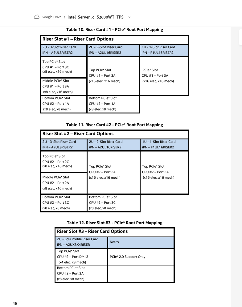

  2. So update, on my other unraid server - it is an asus x99 deluxe ii - i am running an LSI 9201-8i. So i took that and plugged it into my intel server within slot 2 of my riser card and attached to velociraptor HDDs into it. viola they both show up. I am assuming it is because this card has a PEX chip, which i think is under the heat sink.
  3. I give up on this stuff. I have tried in all three slots on the riser card with a new startech DUAL-M2-PCIE-CARD-B that is pcie 4.0 x8 as we talked about. It works but only the first slot is recognized of the two. So I took out the second m.2 stick from the startech card and placed it in a pcie 3.0 x1 card that I had laying around and placed that in the 3rd slot of the riser with the startech in the 1st slot. That works and both m.2's show up now in unraid. I do not understand what is going on. If we are going way beyond your capabilities, please let me know. I do need to try reddit again. Also do my ssd's need to be pcie 3.0? because they are 4.0. Also i changed all three slot bifurcation settings to default.
  4. x09c_ changed their profile photo
  5. Ok, so I think I am actually understanding this stuff now. Basically, if the card was a x8 interface (electrical) with a x16 slot (mechanical) then it would work in the top two slots.

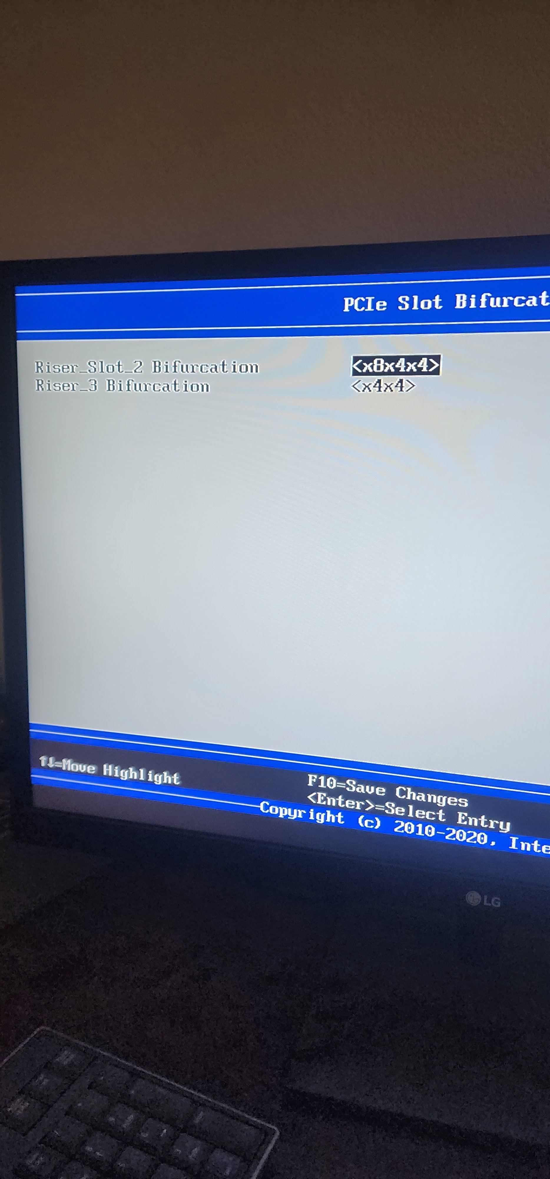

  6. you have been most helpful and I would love to pick your brain some more. If plugging the asus card into my x16 slot on the server board works, then why doesnt the same function occur with the riser card within the 1st two slots of the server board? Attached is a page from the TPS showing x8 elec and x16 mech for the 3 slot riser card and attached is a bios screen shot. the risercard is populated in riser slot 1, which makes it not show up in the bios. This happens when i switch it to riser slot two, then 1 and 3 show up.
  7. So just to clarify, the first two slots are riser slots and the 3rd is x16 slot. I plugged the asus card directly into the third slot, powered it on, and now the drives are missing. This is wierd.

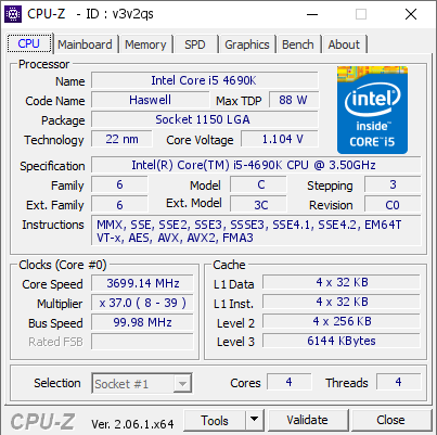

  10. Hello everyone, So i have some questions that perhaps people could help me understand. I would like to know the following: If buying a cpu that has a high single core performance (lets say newer generation) that has p cores and e cores, does that mean each p core separately is amazing; for instance if i assign 1 p core for a vm and another p core for a minecraft game? Now lets say i have an older cpu (such as an intel core i7 6950x) that does not have p cores, does each core still peak separately from each other or does that cpu need those cores together? my daughter has the following: and even though it says 3.5ghz with core 0, do the other three cores just suck? Maybe i have answered my own question, but just want some people to help me break it down. Thanks.
