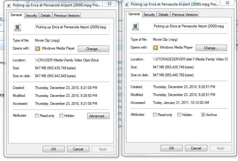

I checked and the time was setup as if my local time was UTC.  So changed to NTP and verifed that UTC is not correct.  Deleted the destination file, recopied from the source to destination with the same results.  I am not very familiar with Linux, so assume I have something jacked up somewhere.  Here is a screen shot of the two time stamps on the file copied.  On the right is the destination (unRAID) and the left is the source (Win 7).  Notice they appear to have been created 7 minutes apart and modified 1 second later than the other.  Maybe its a Windows 7 thing too.  I'm going to try this on a MAC to see if its different.
picture attached.
