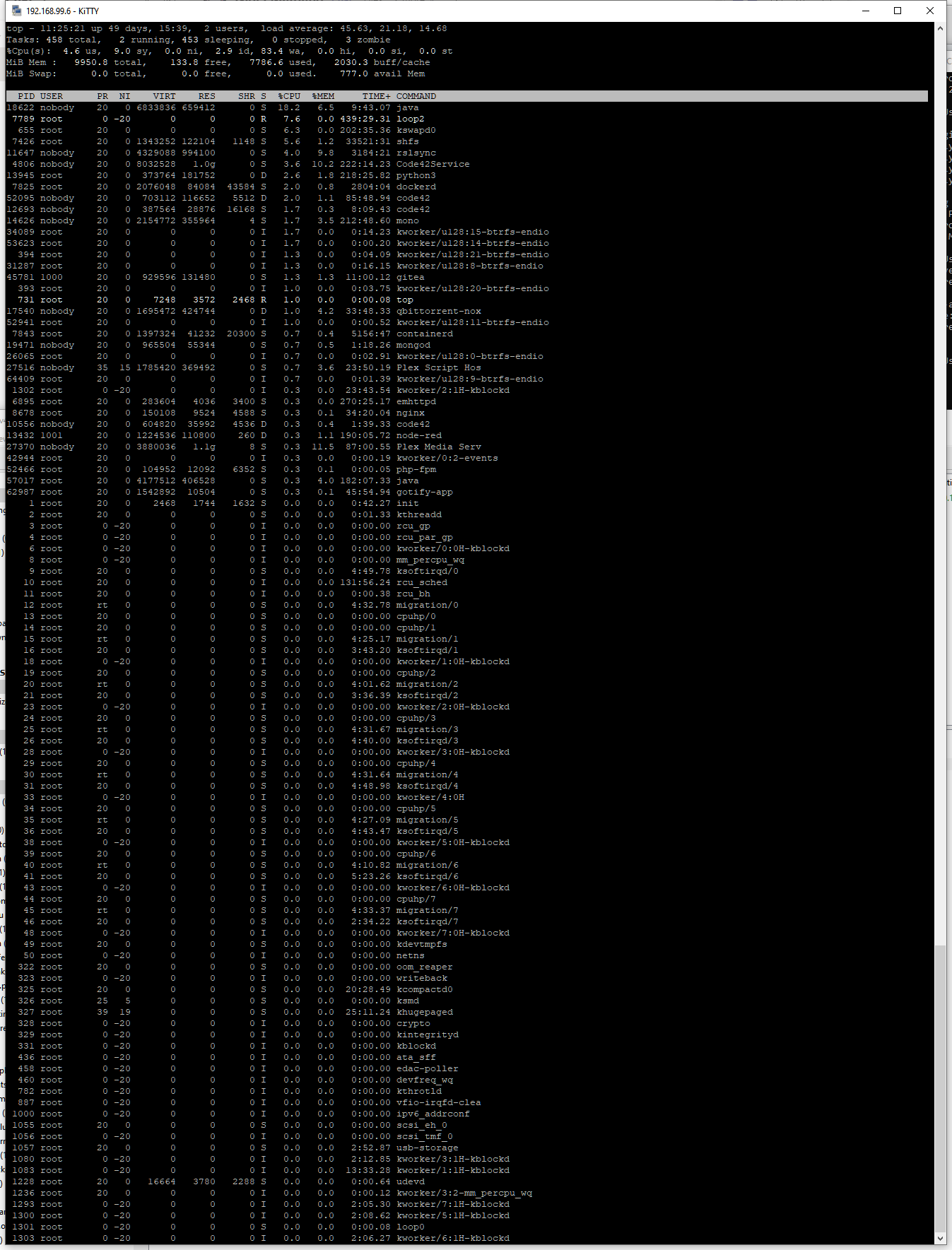

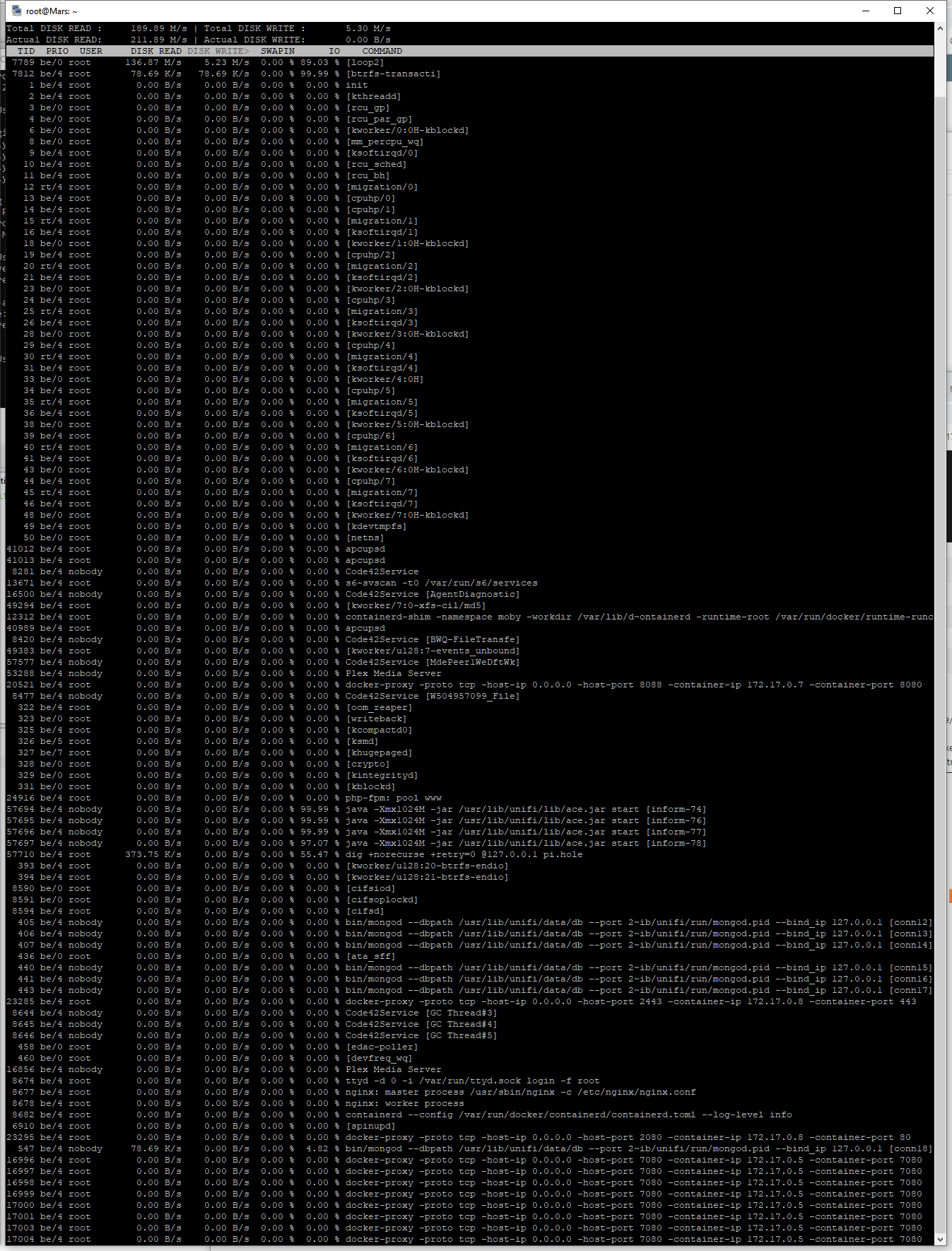

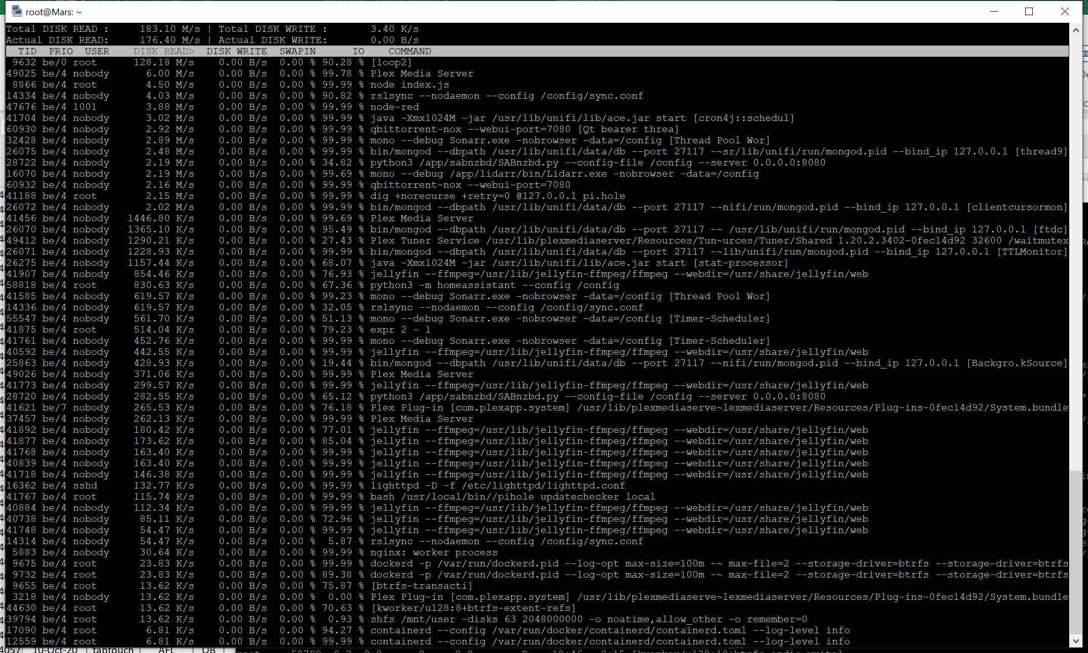

iotop shows high read rate on loop2 (/dev/loop2 is the docker image) and also a number of the apps seem to start reading for some unknown reason. e.g. from a while ago so dockers running are slightly different. There is no particular reason that all these apps would be reading simultaneously.

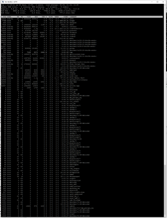

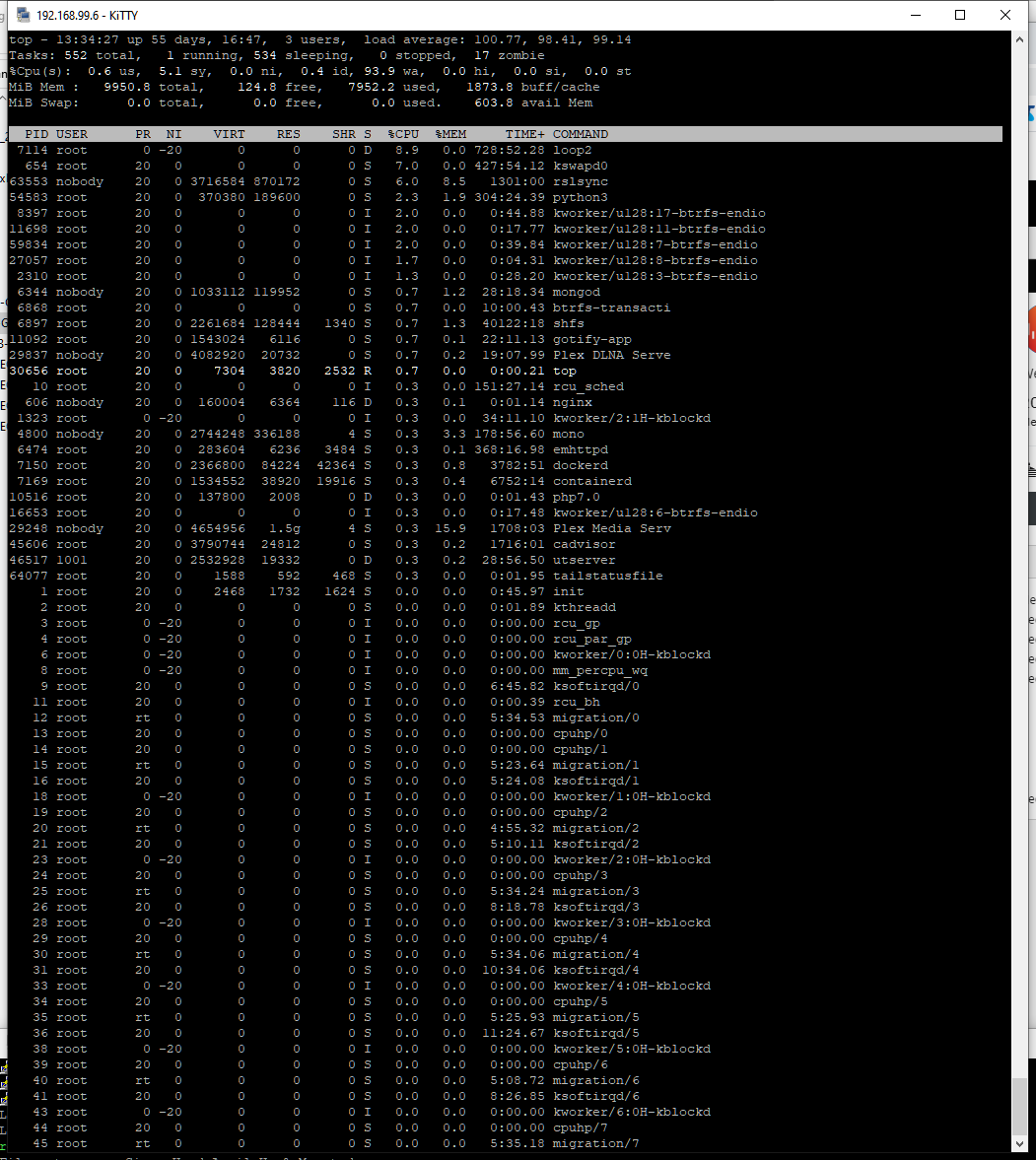

and top (albeit at a different time):
The unRAID server itself remains quite responsive, but all the dockers basically stop operating properly. e.g. pihole stops serving DNS queries. Webservers for others stop responding. "docker ps" sometimes hangs (well gets blocked somewhat indefinitely)
