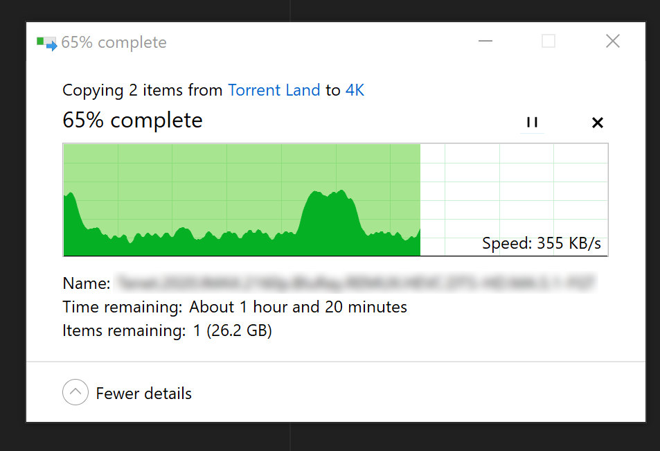

Hello. Hoping someone can offer some help. I'm seeing extremely slow writes to the cache of my new unraid server. I'll  try to set out what I've been doing below, along with things I've tried. I'll gladly provide any more info if you need it. I've attached my diagnostics as seems to be the norm, and also a screengrab of a large transfer (c. 80GB) to show the issue. I took the diagnostics during the transfer in the screenshot.

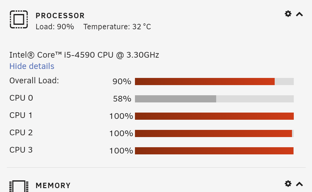

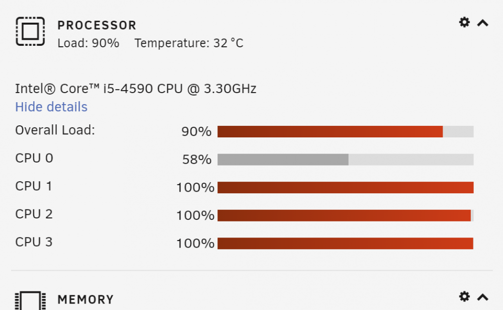

I also noticed that the CPU is pretty much pinned while the transfer is going on (screenshot also attached), but when I looked in the processes tool, I couldn't see anything with high usage. Is this normal? CPU is an i5-4590.

Speeds were ok for the first couple of transfers I made, about 85MB/s, then suddenly dropped mid transfer to 20MB/s and have pretty much stayed there since.

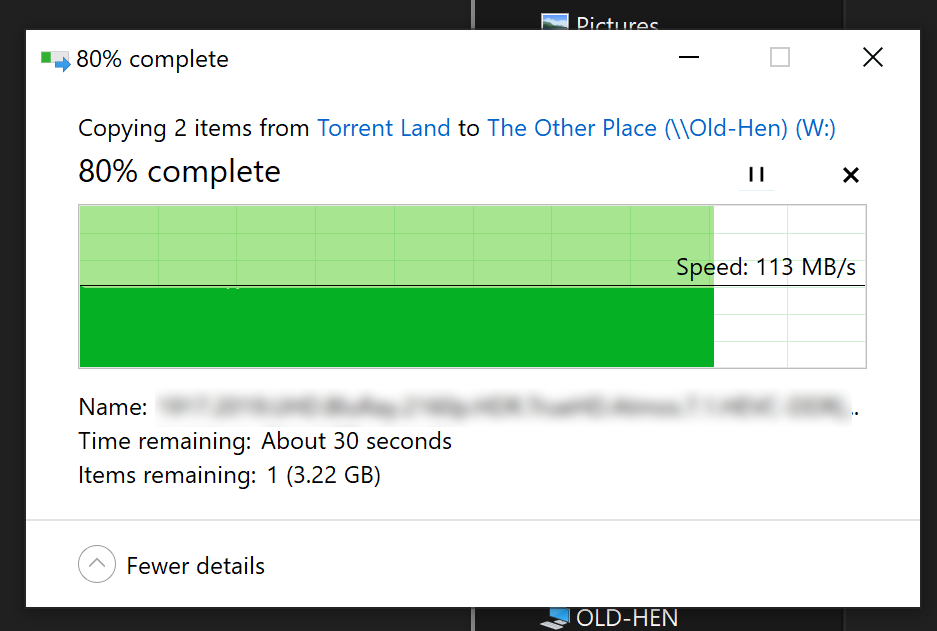

This look like a device problem, is it faster if you transfer directly to the array with turbo write enable?
I turned on reconstruct write and copied a 13GB file to a share with cache set to "no" to test this. The copy averaged about 95MB/s. Stable speeds throughout.

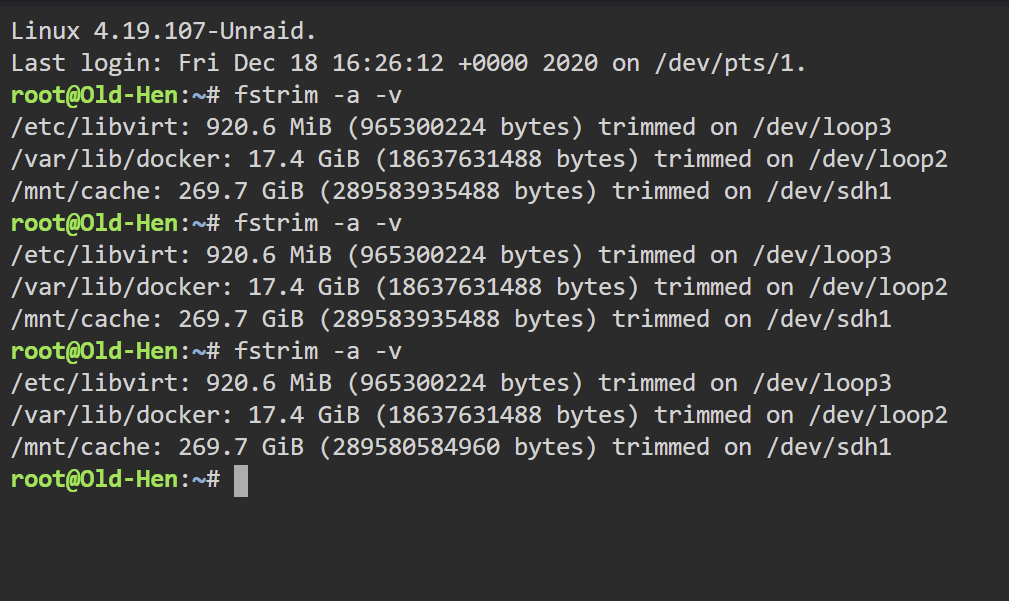

I've also attached a screengrab of me running trim 3 times in a row on the SSDs. The results are always the same. Is this right?
Not all SSDs can sustain fast writes, especially QLC based SSDs like the ones you're using, recommend using a 3D TLC model, like the 860 EVO, Crucial MX500, WD Red/Blue, etc.
Fair enough, they are economical SSDs, however I'd expect them to manage more than 20MB/s. I'd also expect them not to drop to 350KB/s pretty much ever!  Wouldn't you?

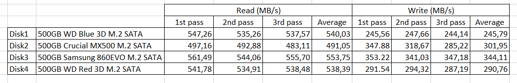

And for reference here are my own tests with the models I mentioned, I had them installed as a small array, so no trim, transfer size was around 26GB in large files:

2 minutes ago, toptable said:
How about that trim thing, is that normal?
Yep.
