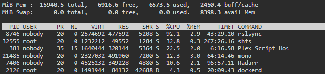

Push. Also, maybe it is connected, to the fact that from time to time the utilizatiion of ram and cpu is at 100% even, if I don't run anything specific.

Now I run diagnostics while the usage is very high, maybe that helps
I think plex takes a lot of memory
mule-diagnostics-20201229-1447.zip
Does usage go down when you stop plex?
