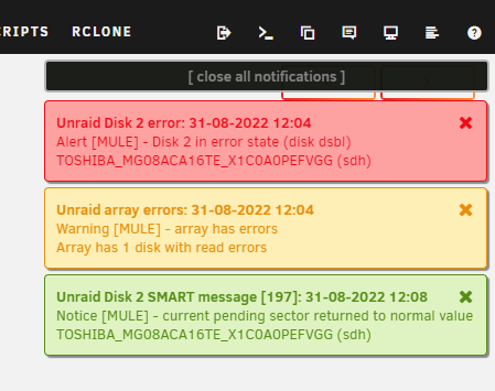

  10. The rebuild went well and it showed no errors. I run the diagnostics as suggested by you again (also checked and replaced all the necessary cables). Here are the diagnostics. Could you have a last look? Thank you so much! mule-diagnostics-20220903-1017.zip
  11. Thank you so much for the fast help. I will do so. The rebuilding works in the same way as for a replaced disc, doesn't it? Hm, I don't think so. I will double check and replace any necessary cable. Hopefully, that solves the issue. Does it make sense to run and post diagnostics after the whole changing and rebuilding?
  12. Dear all, yesterday unraid short Disk 2 in error state for one of my hard drives. Now there is a red cross next to the drive and the Error count next to the hard drive shows 33 (it was 0 previously). I run an extended smart self-test which took almost a day and shows 'completed without error'. I can attach it if needed, for now I 'only' post the diagnostics as suggested on the help page. Also since then unraid showed a yellow and even a green message about the drive (see screenshot attached). I didn't move my server, didn't even touch it. There was a parity check running (once a month automatically) but when the error message first occurred it was actually paused. Could you tell me what is going on? Thank you very much, any help is much appreciated! mule-diagnostics-20220901-0921.zip
