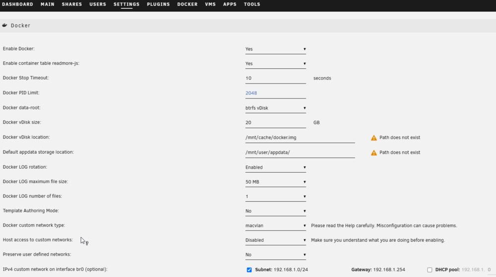

I have lost all my VM's and Docker Service failed to start.
I saw that my cache drive is Unmountable: Unsupported or no file system

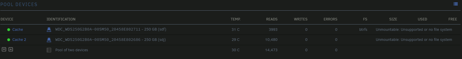

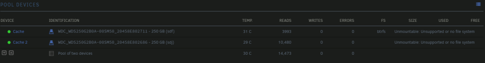

I think that the problem is that cache drive is Unmountable: Unsupported or no file system
Can I format it ?

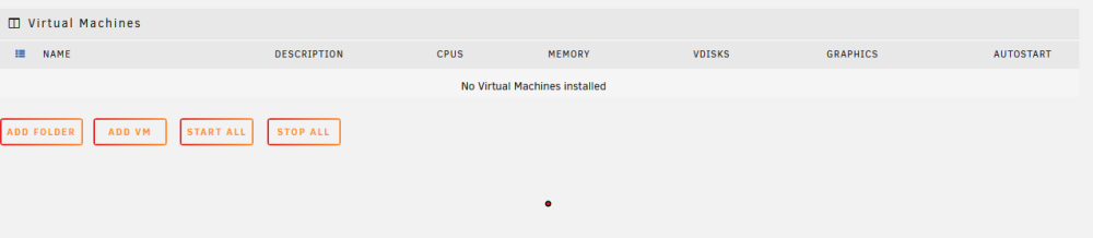

All my docker data and vm's are  saved and accessible as you can see in the screenshot

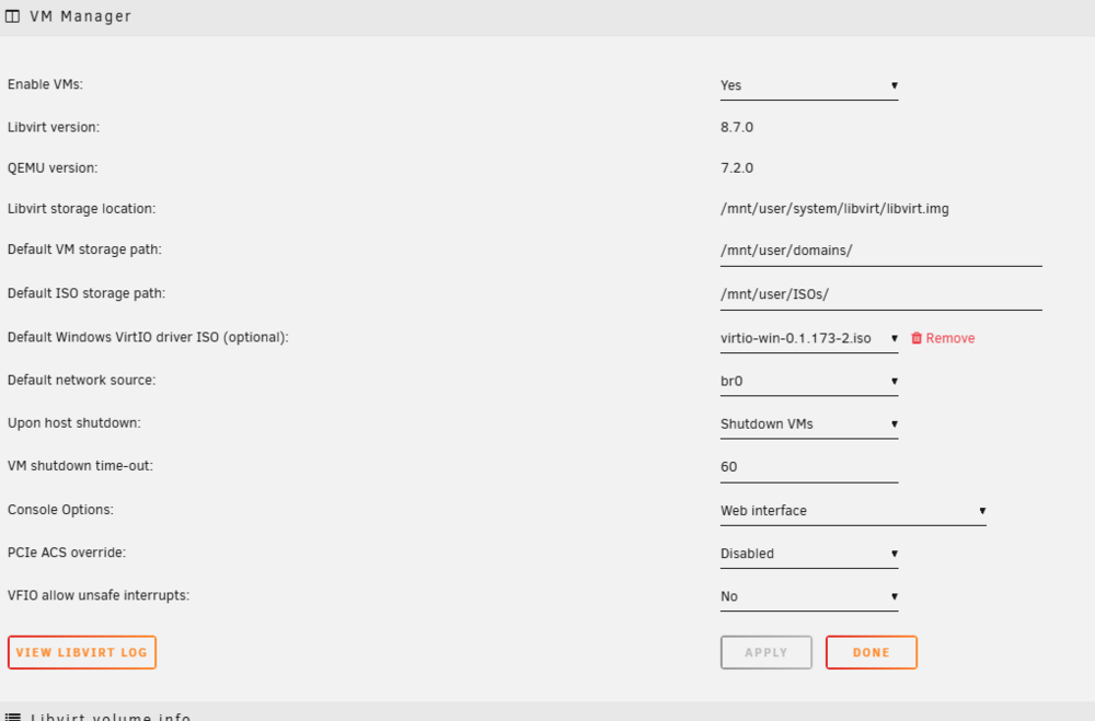

By the way how can I add my vm's again to the VM tab so I can acess them ?

Now that i already have the vmdk files , how can i put them back on again ?
