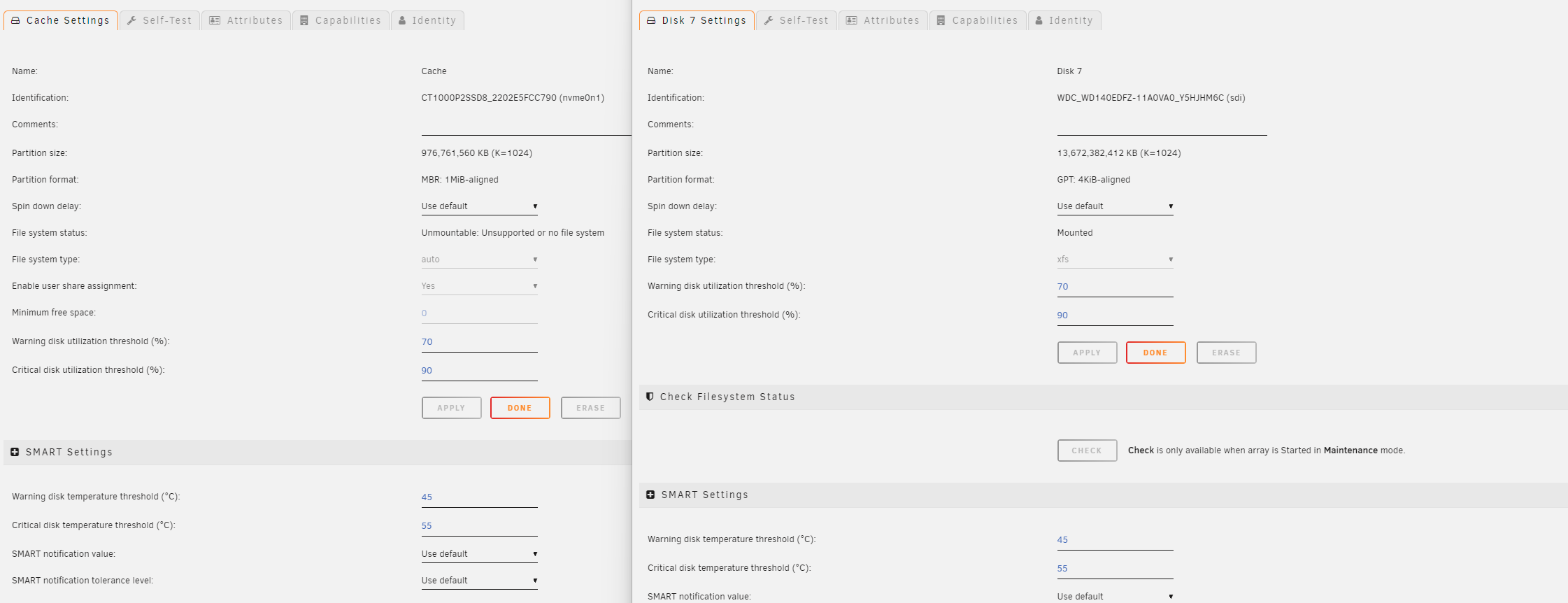

20 minutes ago, JorgeB said:
It should have.
That's not correct, type:
xfs_repair /dev/nvme0n1p1
This is what is shows in the GUI.
Ran the above code and got this.
Phase 1 - find and verify superblock...
Phase 2 - using internal log
        - zero log...
ERROR: The filesystem has valuable metadata changes in a log which needs to
be replayed.  Mount the filesystem to replay the log, and unmount it before
re-running xfs_repair.  If you are unable to mount the filesystem, then use
the -L option to destroy the log and attempt a repair.
Note that destroying the log may cause corruption -- please attempt a mount
of the filesystem before doing this.
You should now run without -n and adding -L.  A mount has already failed by this point.
Filesystem is set to auto, you must set it to xfs to use the GUI.
Thanks! That seems to have done the trick!
