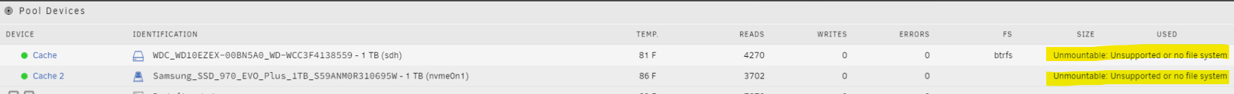

  7. My cache drives are showing up as "unmountable: unsupported or no file system." I am unable to stop/start my array and assign these drives but the highlighted message below keeps showing. Unraid will let me format these but I don't want to lose my appdata contents. Any help or guidance would be appreciated.
  8. @JorgeB can you take a look at my diagnostics file? It looks like you've had success helping others ... now I need help too
