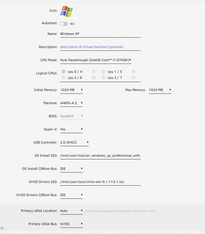

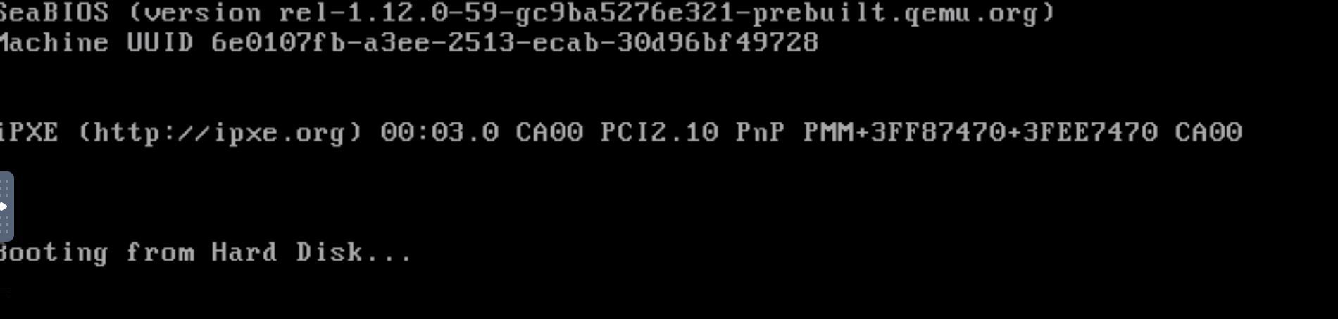

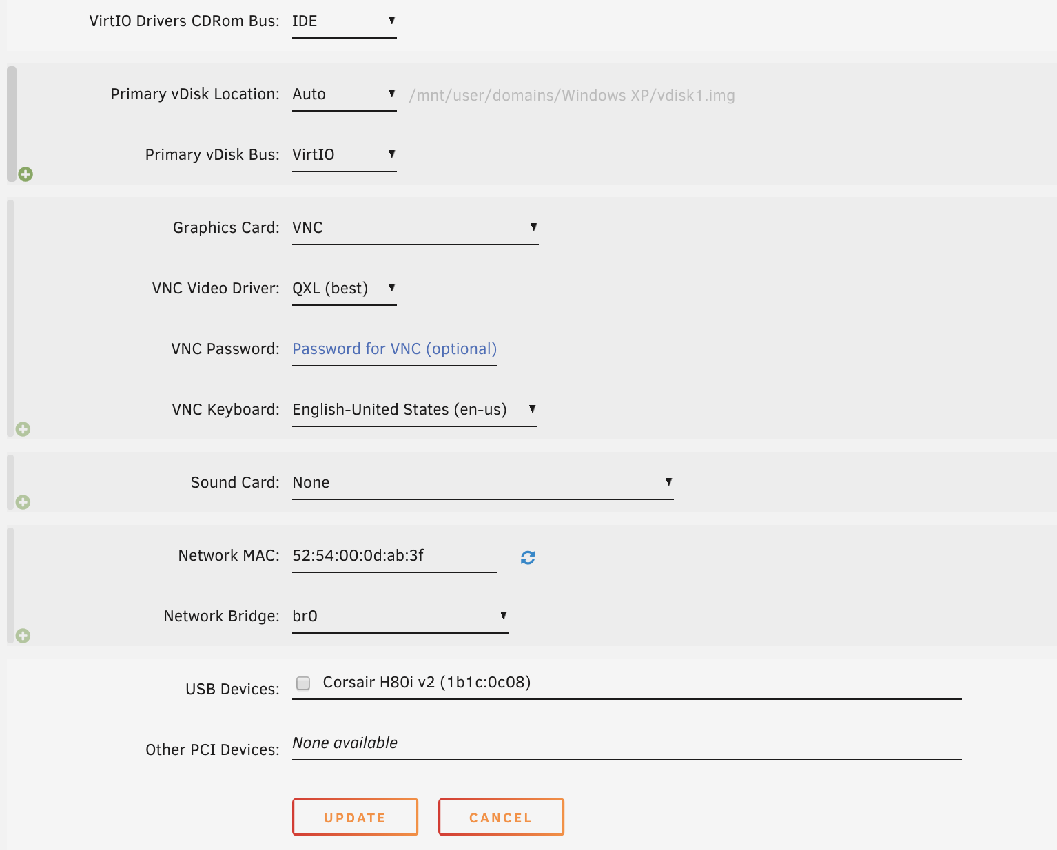

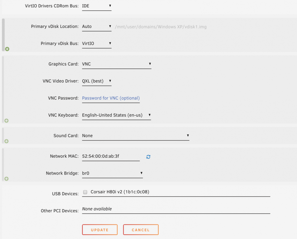

I have some old windows XP based music software and files that I created a long time ago. They won't run on windows 7.  So, I am trying to get an XP VM based on a Windows XP SP3 to run but am struggling.  I have tried a number of virtIO drivers and but every time it halts at "Booting from hard drive" and pegs a single cpu at 100% until force shut down.
Suggestions and help is appreciated.
Logs and Images below:

hello,
Try to change vdiisk bus to ide or sata and assign 2 core to the VM

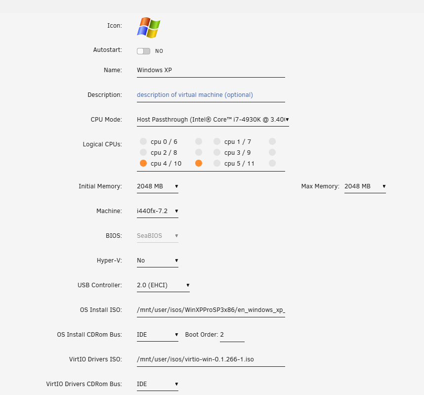

Made some progress based on assistance from rachid596 and also gareth_iowc.

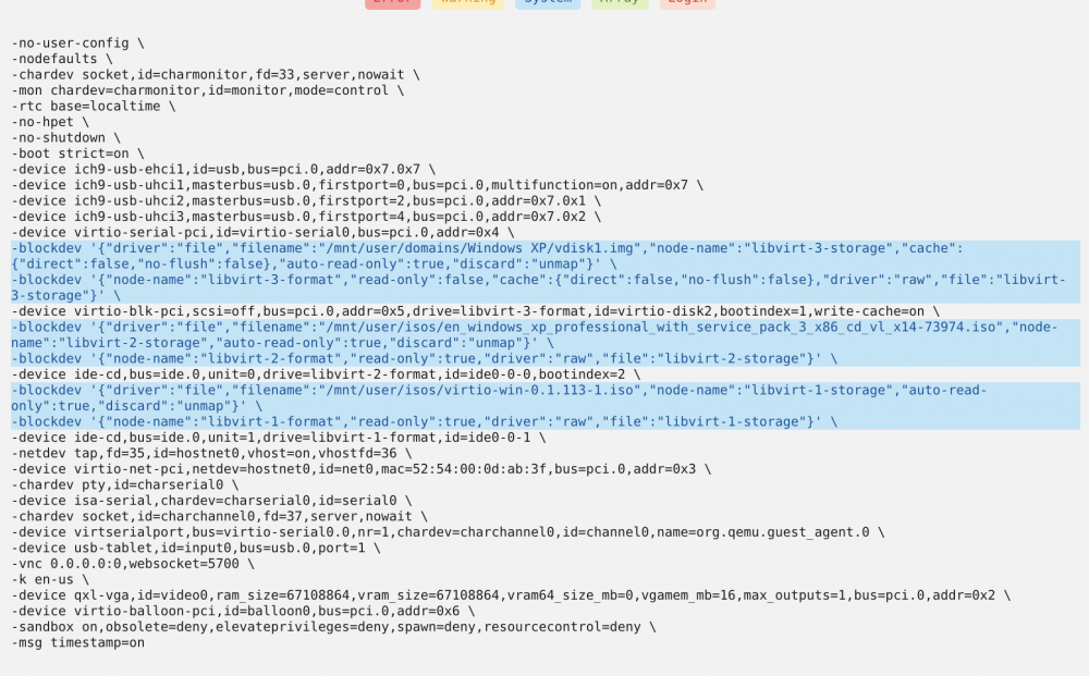

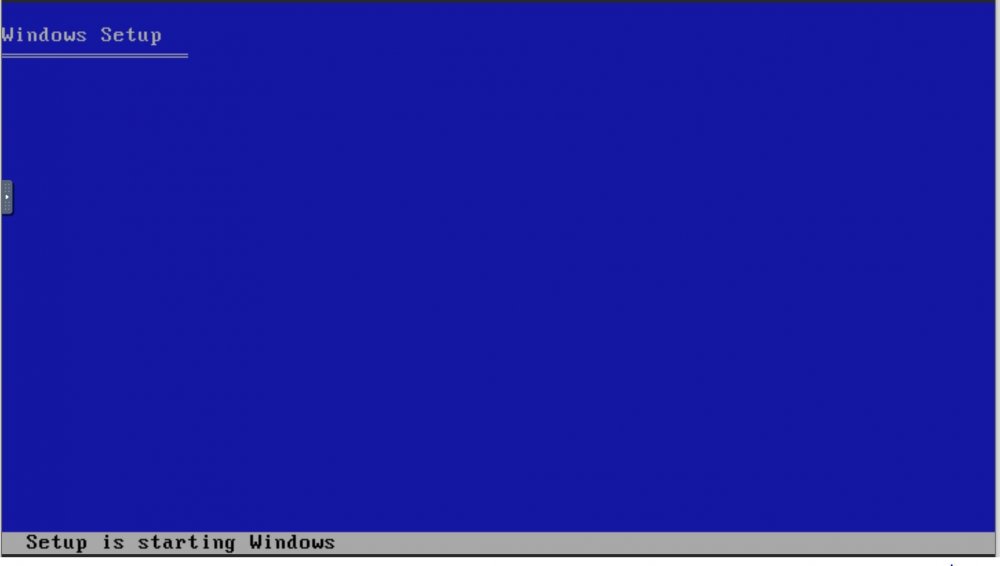

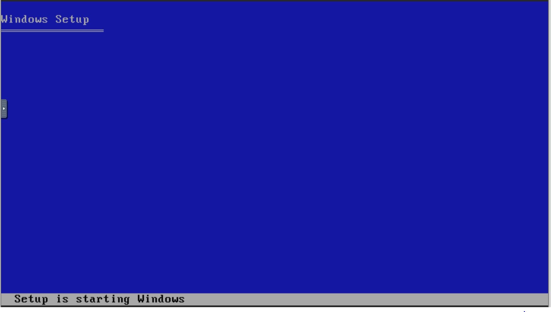

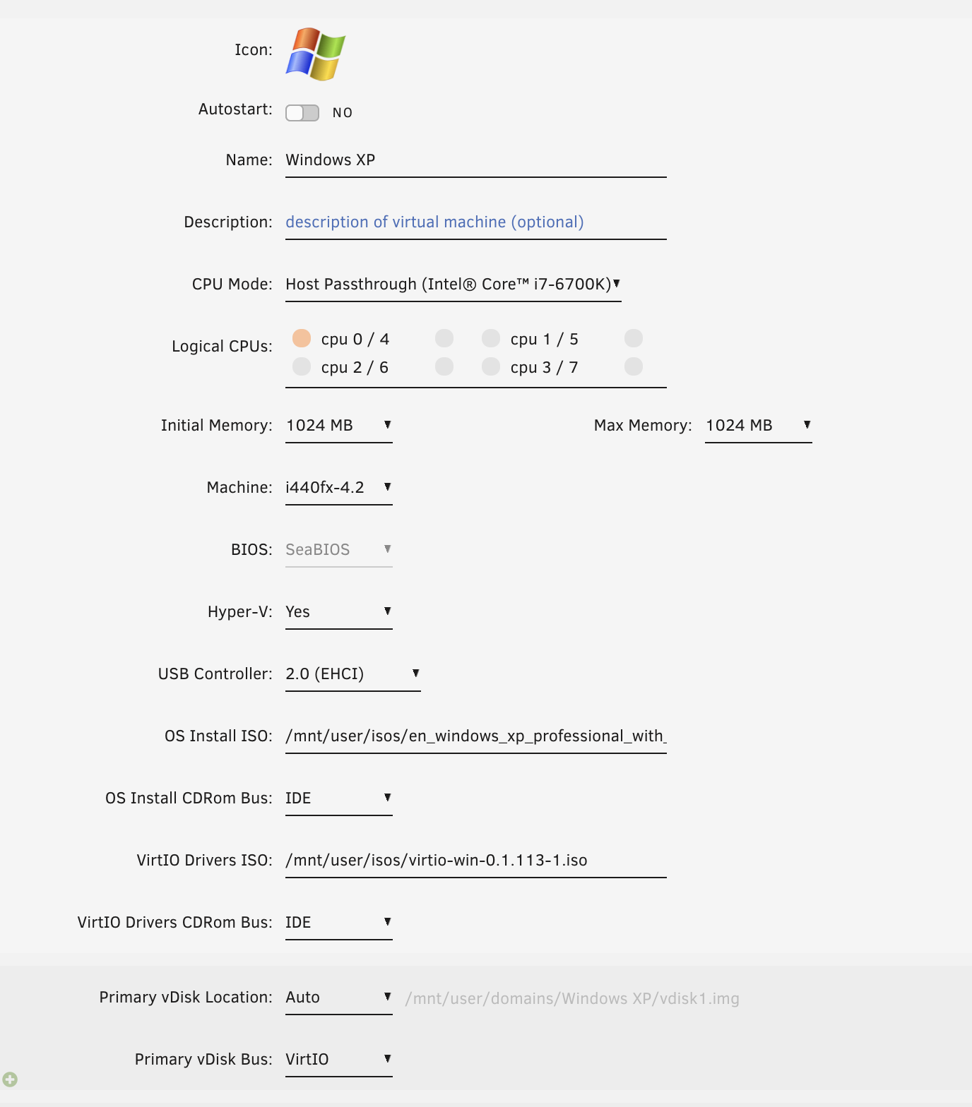

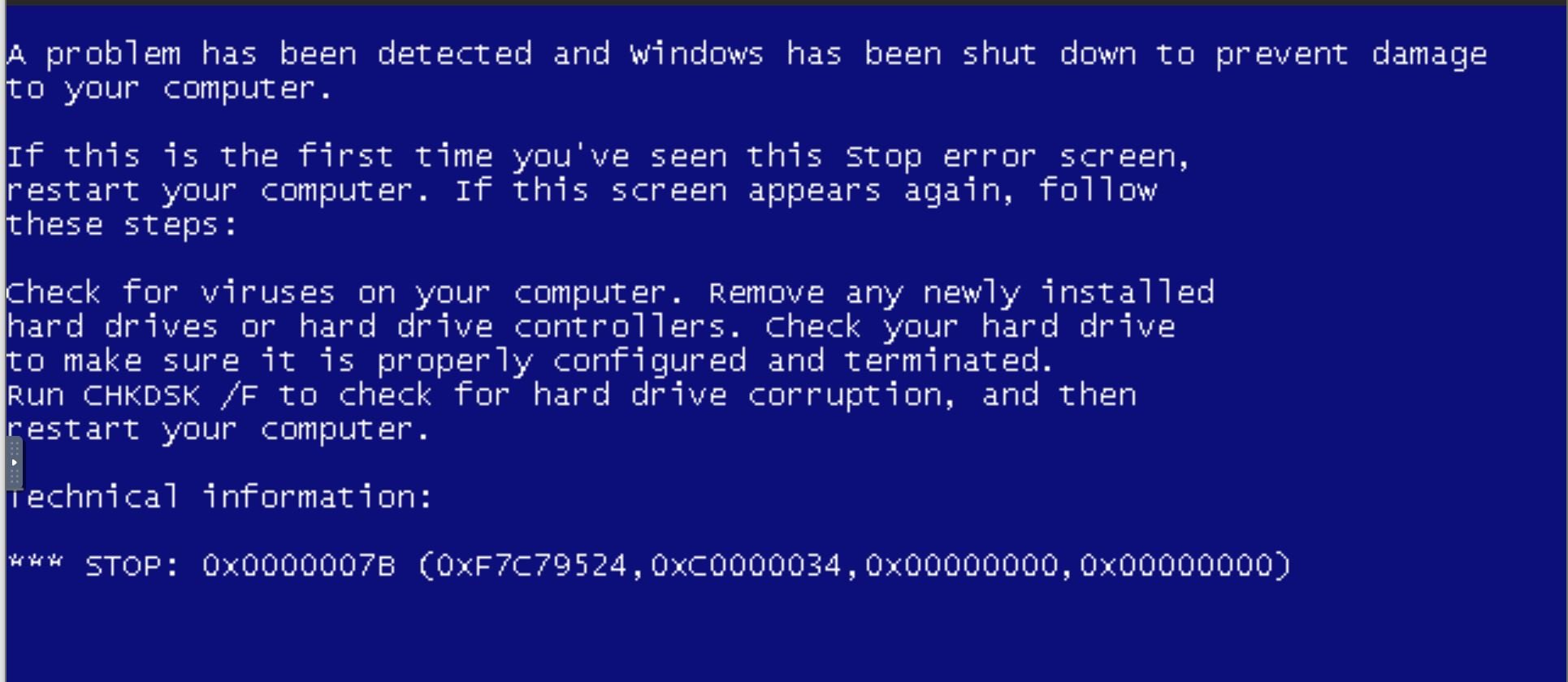

The XP VM now appears to boot the ISO and begin installing.  However, I now get a blue screen right when it says "starting windows," see the image below.  After the blue screen I need to force quit the VM. Then it WILL NOT boot/install again.  In that see is "booting from HDD" with no action.   I can destroy the VM and setup new and end up in the same loop.
 Screen shots and config file below.  I wonder if my XP SP3 ISO is somehow corrupted or the HDD doesn't function.

 This is just before the blue screen:
Blue Screen:
This is what I see if I restart after the blue screen.

You could try rebuilding the VM using Q35 rather than i440 machine type.  That's got me out of a few pickles in the past.
Have you selected your target install disk by this point? It's been a while since I did an XP install? Was there an opportunity to load custom drivers before this point? You might need to load vistor and other drivers from the viirtio iso?
Beyond that, I'd be stumped.
I can try Q35.  Yes, there is an opportunity to load drivers.  I am just not sure what to load.  I will see if I can show a screen shot of the options. Thanks
When you have the opportunity to load drivers, take it!
You need to follow the driver installation sequence described here;
http://lime-technology.com/wiki/index.php/UnRAID_6/VM_Management#Step_5:_Install_the_VirtIO_drivers_from_inside_the_VM_.28Windows_Guests_Only.29
That's actually for post-OS-install updates, but you my be getting that BSD because Windows Setup doesn't have drivers for some of your VM devices. You need to load the relevant drivers from the ISO as part of the setup process. (you need to do this for Win10, why not XP?)
That page specifically indicates that the viostor drivers should be installed last. You'll need to load  Balloon, NetKVM and vioserial drivers first, then viostor. You do them one at a time, so its a bit repeditive.

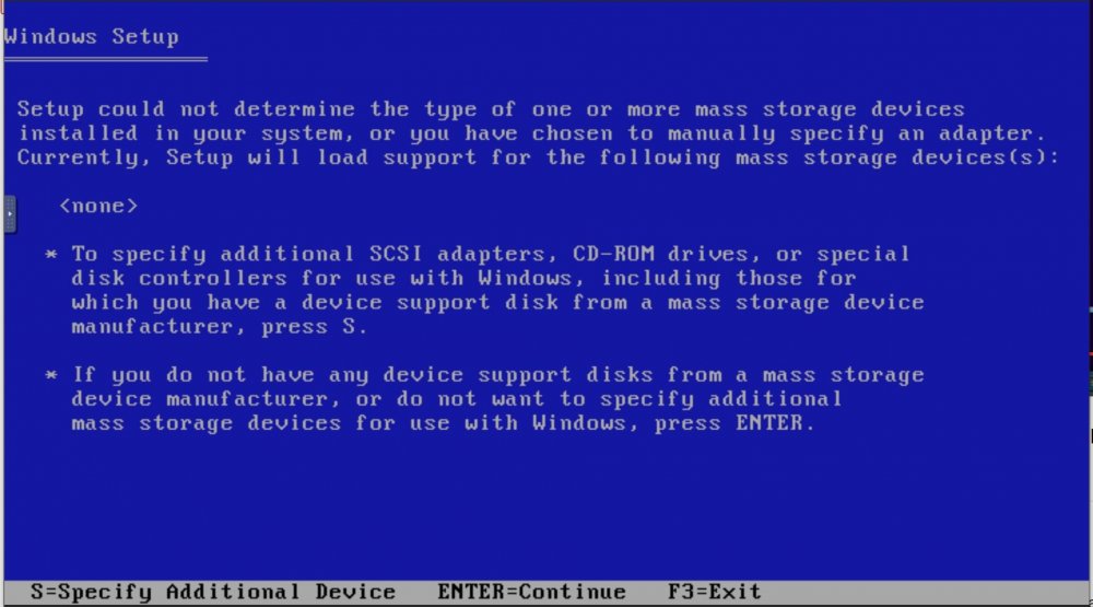

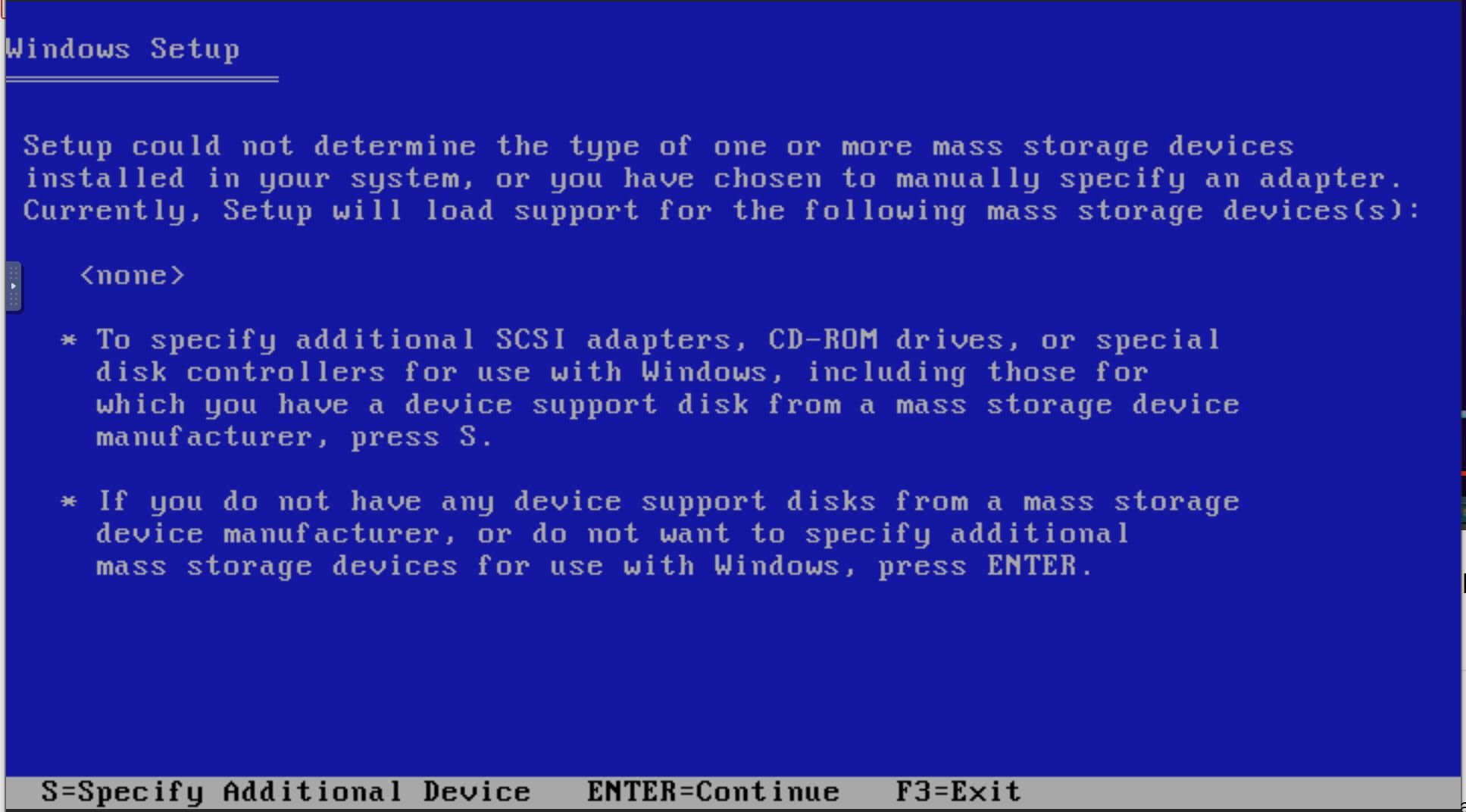

Q35 didn't solve the problem  However, pressing F6 while loading brought up the following screen (see image).  It seems that it can't find a mass storage device to save to.
At least that is how I read it.  Pressing S resulted in no additional drivers found. I wasn't able to see a way to load the drivers.
This seems like progress.  Suggestions?719543323_setup6.thumb.JPG.f1e520caf9ddbeaa1ba6bdbe511acb4d.JPG
More good news. I found this for you;
https://www.raymond.cc/blog/install-xp-setup-did-not-find-any-hard-disk-drives-installed-in-your-computer/
It looks lies WinXP doesn't support SATA for install, and VIRTIO is causing a problem for you. Also, it seems that the drivers need to be on floppy (!) or USB, so likely why pressing 'S' results in no dice.
Try setting your primary vDisk bus to IDE specifically. Or see if you can follow the instructions oin the above article.
Good luck!
For some reason I am not able to find a way to open an load the drivers in XP setup.  Pressing F6 should work as shown in the image above.  However, no options exist to load drivers when I press S.
I wonder if I need to add a virtual floppy drive.

30 minutes ago, dubbly said:
clarified above.  The issue is that the VirtIO drivers on the ISO aren't available to install.  I wonder if I need to add a virtual floppy or something. It keeps asking for one.
Yes, it seems XP needs a floppy at that point, or a USB spoofed as a floppy.
Did you try to et primary vDisk bus to 'IDE' in VM config?

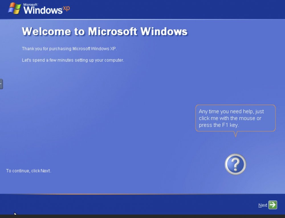

Ahh... I somehow missed your post about the floppy!  I read it and also found the following which was the key.   I followed the instructions and blam!  Thank you so much for your suggestion. It was key.
Result! Well done on the perseverance.

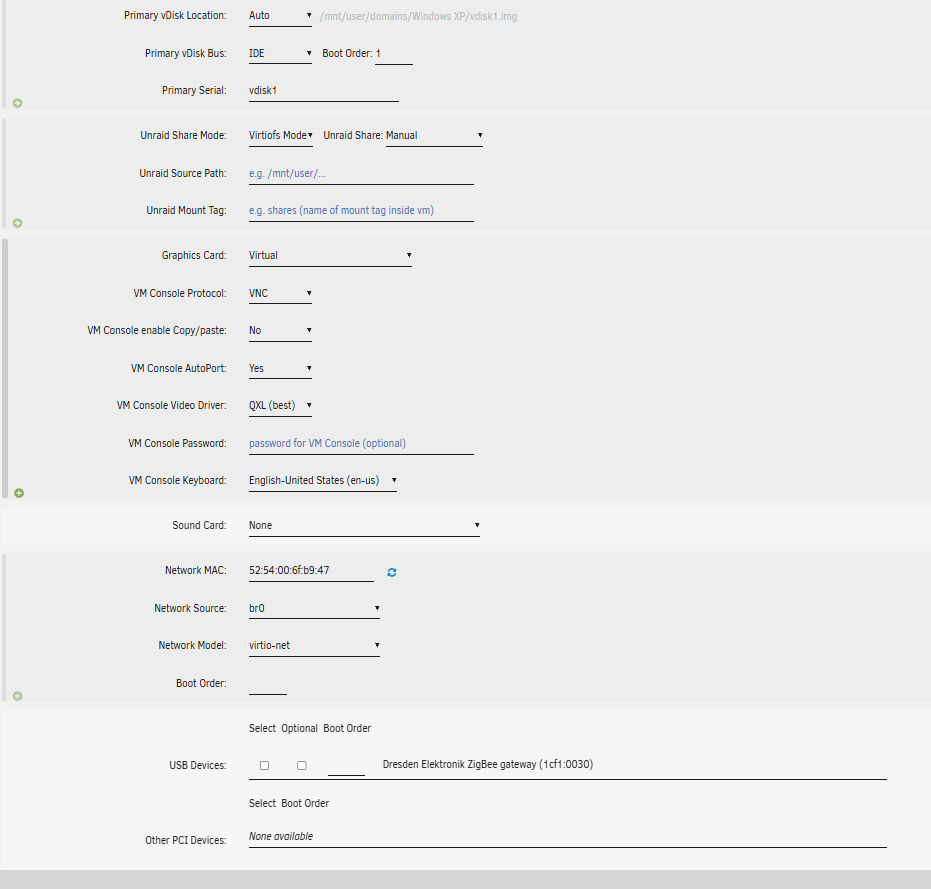

Can anyone post a screenshshot and/or instructions for doing this?  It seems there was a solution a few years ago but Unraid has had updates since then.  I am not having much luck.

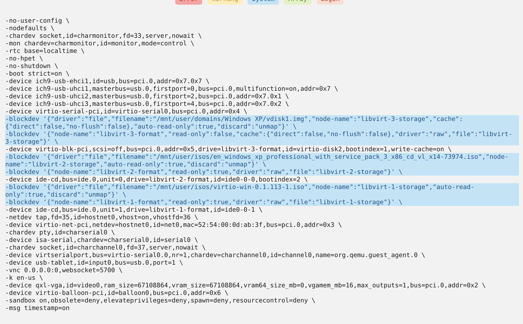

Has anyone had issues with XP under Unraid 7.0? I had a VM working fine previously, but at some point something happened to make it unusably slow. I used the linked floppy to try to reinstall and even the install is glacial. My assigned cpu core is at 100% immediatly upon booting the vm which makes me think it's a QEMU problem somewhere. Both Q35 and i440fx, I've tried multiple version numbers and at this point almost every combination of settings. My Windows 10 daily driver vm with a gpu passed through is fine though so I'm not sure what's up.
