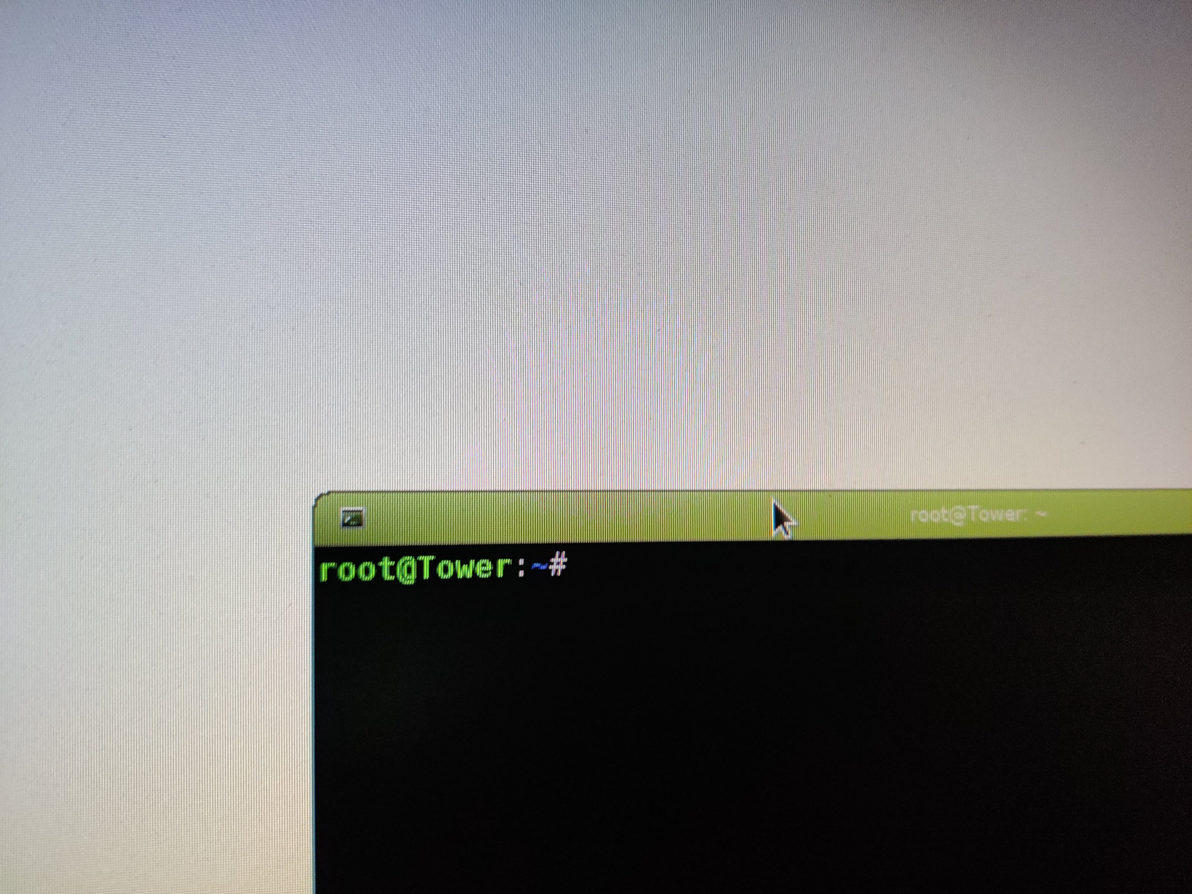

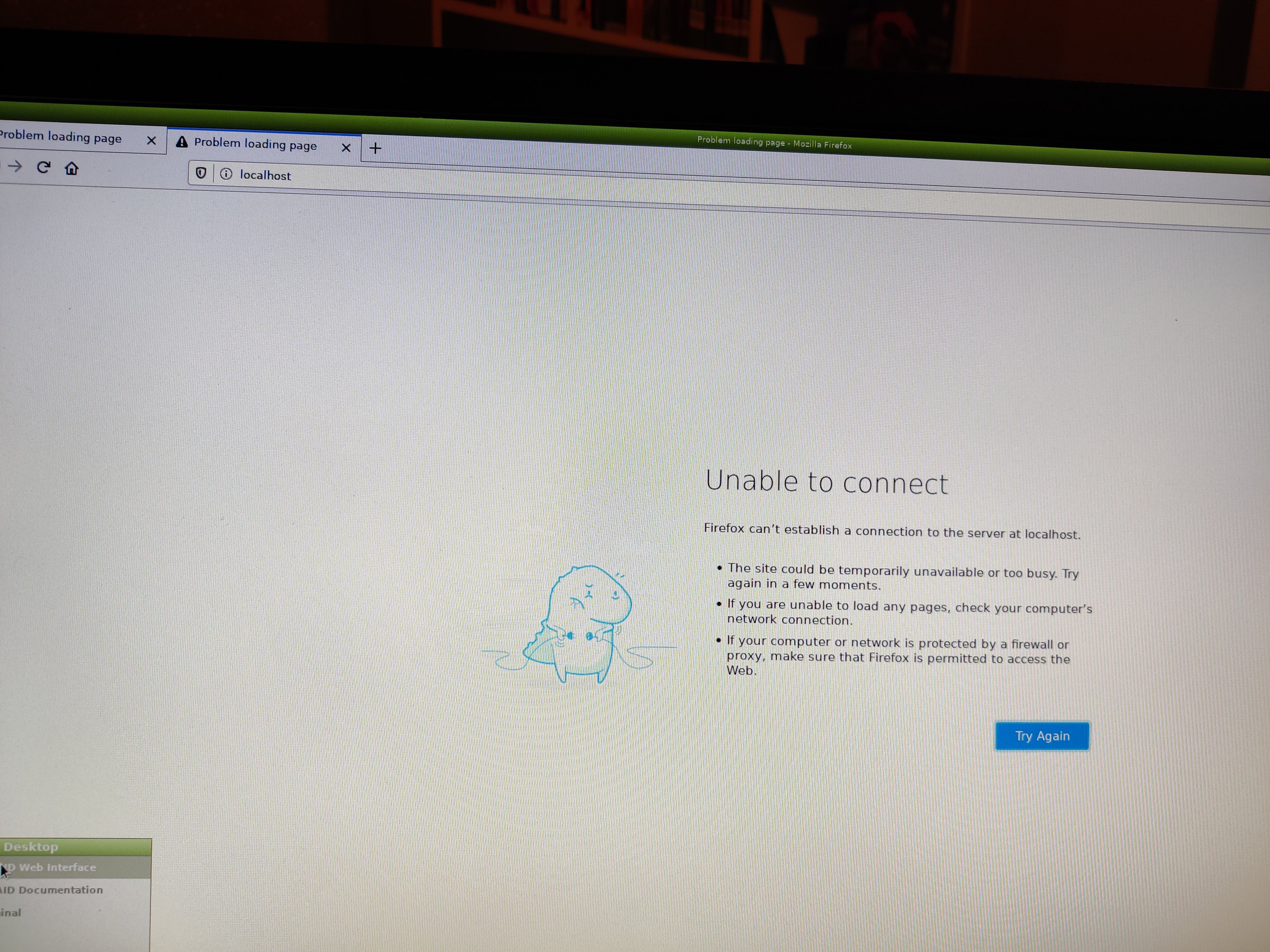

Cant access it with remote and when I boot with gui the browser tries to open localhost but it says "unable to connect" and when I open the terminal the PC name is wrong.
When set it up I named it "Lootbox" but now it says root@tower, which was the default at the begining.

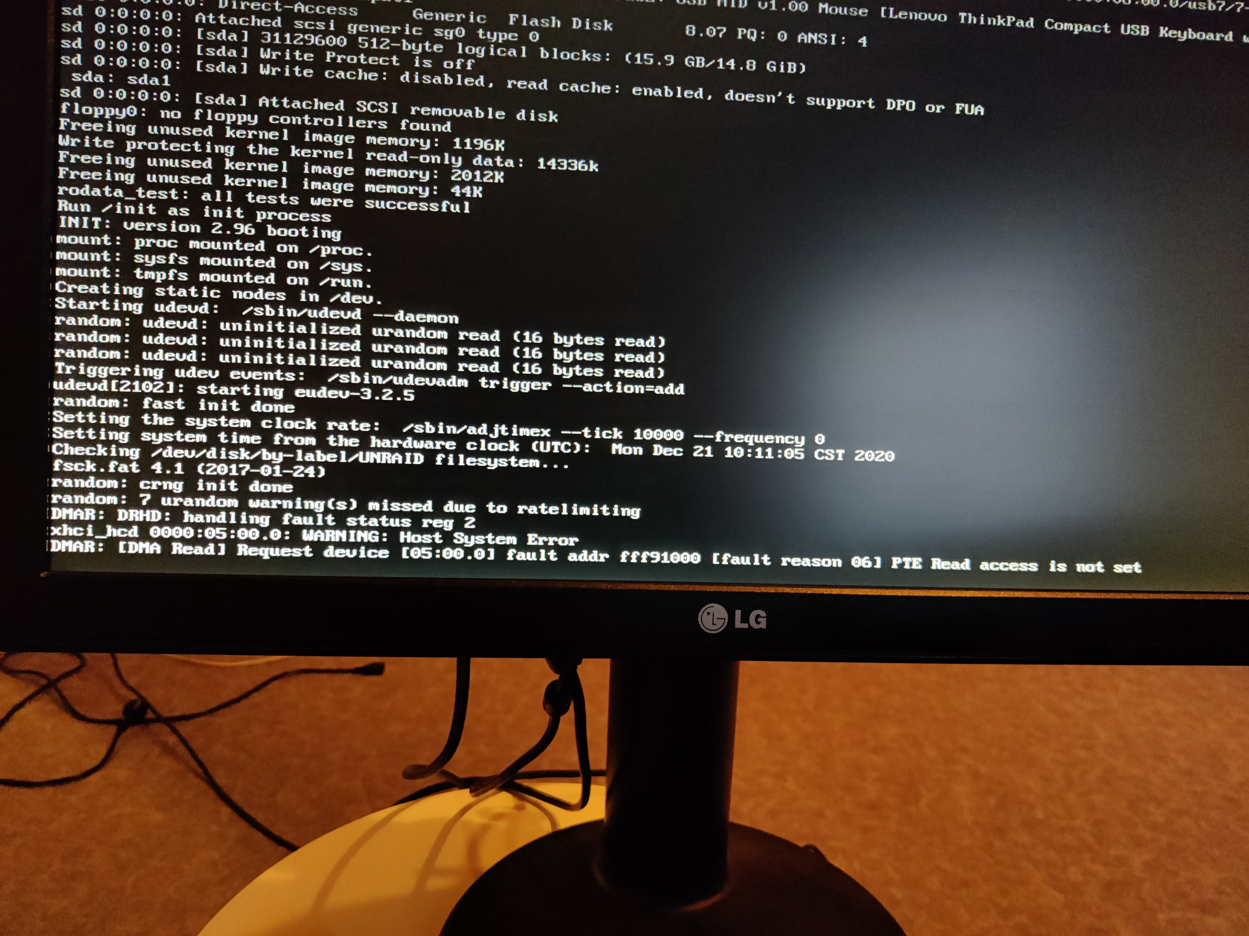

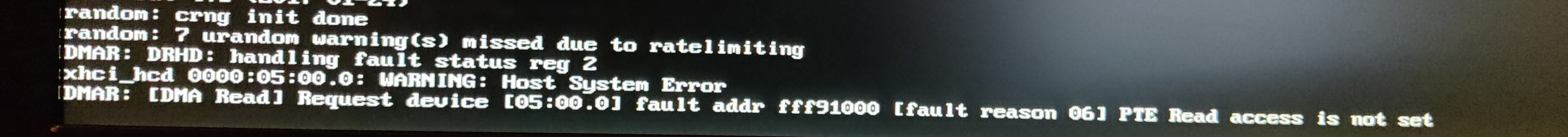

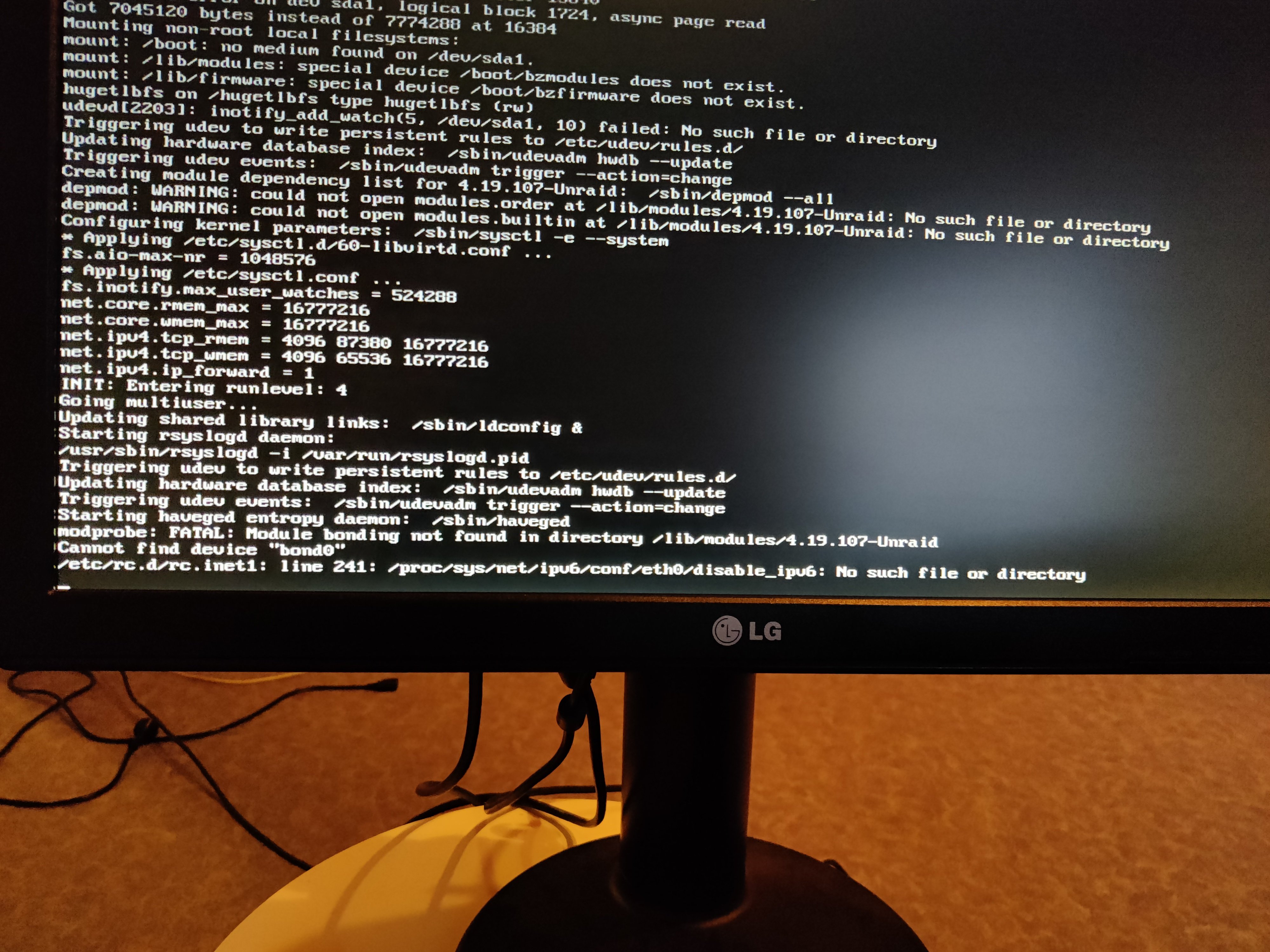

Looks as if Unraid is failing to find the USB stick for the later stages of the boot process.   It might be worth plugging it into a Windows/Mac system and running a check on it, and also make sure you have not disturbed it’s connection into the server.    Also if possible use a USB2 port (they tend to be more reliable than USB3 ones) and Unraid does not need the performance of USB3 after initial load into RAM.
I tested it on a very small form factor Dell optiplex and it booted into unraid just as it is supposed to.
I have only used USB3 ports so far, I´ll try booting from a 2.0 port next.
I was going by your screenshot that said “No medium found on /dev/sda1” which is normally the Unraid boot device and then there were subsequent messages that stated that files on /boot (where the Unraid boot drive gets mounted) could not be found.   That suggested to me an issue with the flash drive.
OK i just tried it and booted into non safe gui mode and it worked, thanks a lot!!!
