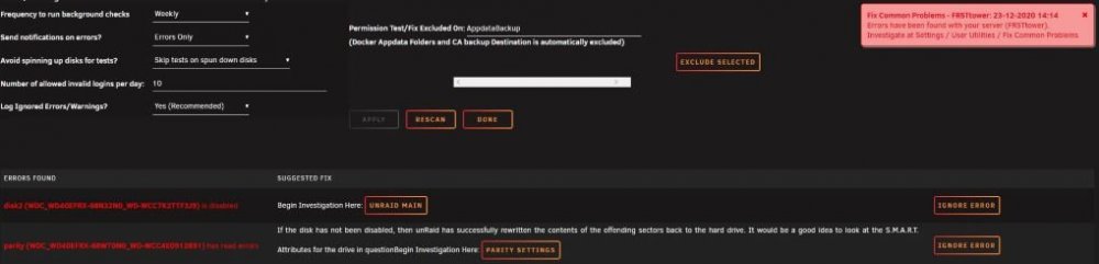

I just recently rebuild the array, it was working fine for a few weeks until last week we had a sudden black out I had to manually shut down the system luckily I decided to use and old UPS w/ new battery's and it worked fine for a few days. When the disk went down I had YouTube-DL, Krusader and Plex on. For some reason I was not able to shutdown Krusader before I had to force shutdown the system. I have two disk on the dashboard with error's thumbs down on the smart report. If you need further information I will reply your request asap. I also grabbed diagnostics before I shut down the computer and is attached.

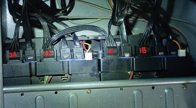

So I have 2 cables with 3 (4 pin molex.) One cable was powering 1.5 bays. I believe that was creating this issue, so now 2 cables are using 2 (4 pin molex) I wont be using the third molex from now on. I am currently rebuilding the drive if anyone can read the diagnostics file and can give me further information such as if any drive is failing because of potential power issues or something non related, would be great. Thank you

You should really avoid the Marvell controller on those boards (first four white ports), they are are known issue, also good to post new diags since there's no SMART for a couple of disks in the previous ones, and the initial error with parity is logged as a disk problem.
