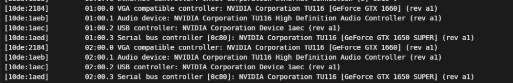

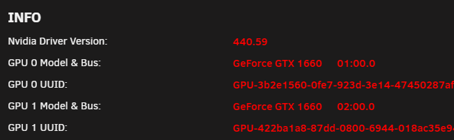

Gpus are seen in nvidia-smi, system devices and what's left of the unraid nvidia plugin.
image.png.178be2414b011cb5dffb32e3e1b21752.pngimage.thumb.png.2bbfd685671b34833bb90ce825460d40.png

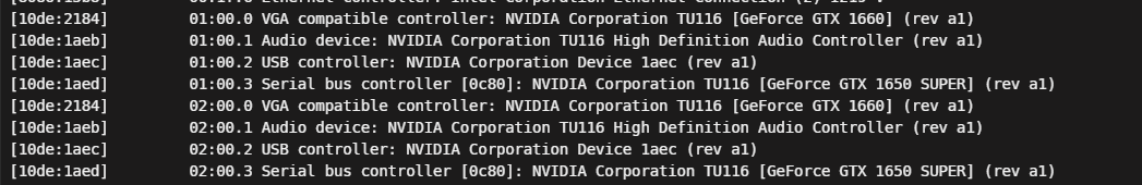

I don't seem to have an option to do anything but list devices in tools>system devices. the only button is "done". (array spun down as well)
am i missing something perhaps? is that a 6.9 feature?

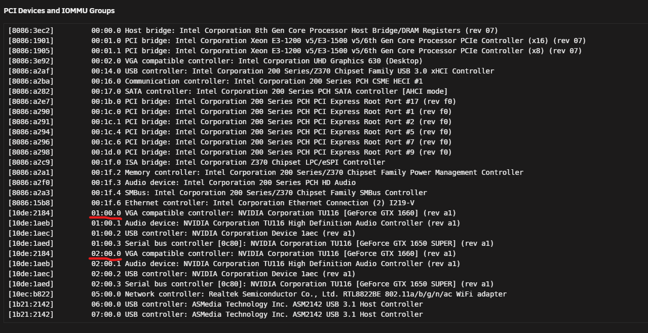

It doesn't say no iommu groups available, vtd is enabled, bios updated as well (thanks for the reminder ;) )
I got the plugin, but it only shows group 0 when building a config.
I assume they're in two groups due to the way they're listed, but i'm not 100% on that.
It's just so weird because it worked just a few months ago using windows and handbrake to convert videos to hevc.
