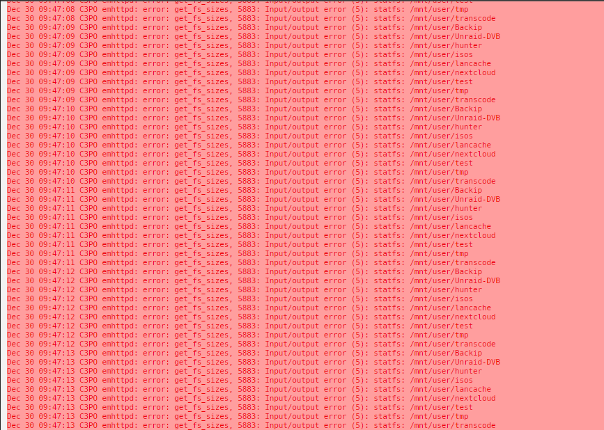

The rebuild finished this morning. It rebuilt fine. SMART passes. I noticed some docker apps were acting funky with database issues. This lead me to the big red picture attached.

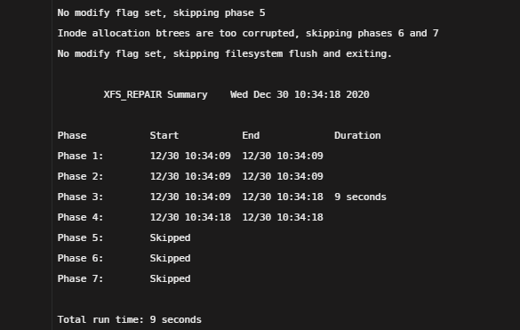

So I followed the Wiki and put it in Maintenance Mode and did the Filesystem Check on the disk(xfs_repair -nv) which scrolled quite a bit and resulted in yeah corruption as shown in the 2nd image attached.

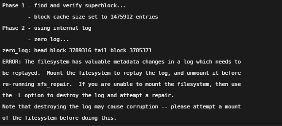

So still following the wiki, and still in Maintenance Mode as it says for XFS, I do 'xfs_repair -v' and this is where things get contradictory and I am stuck. See 3rd attached image.

Use -L.
21 minutes ago, JorgeB said:
Use -L.
