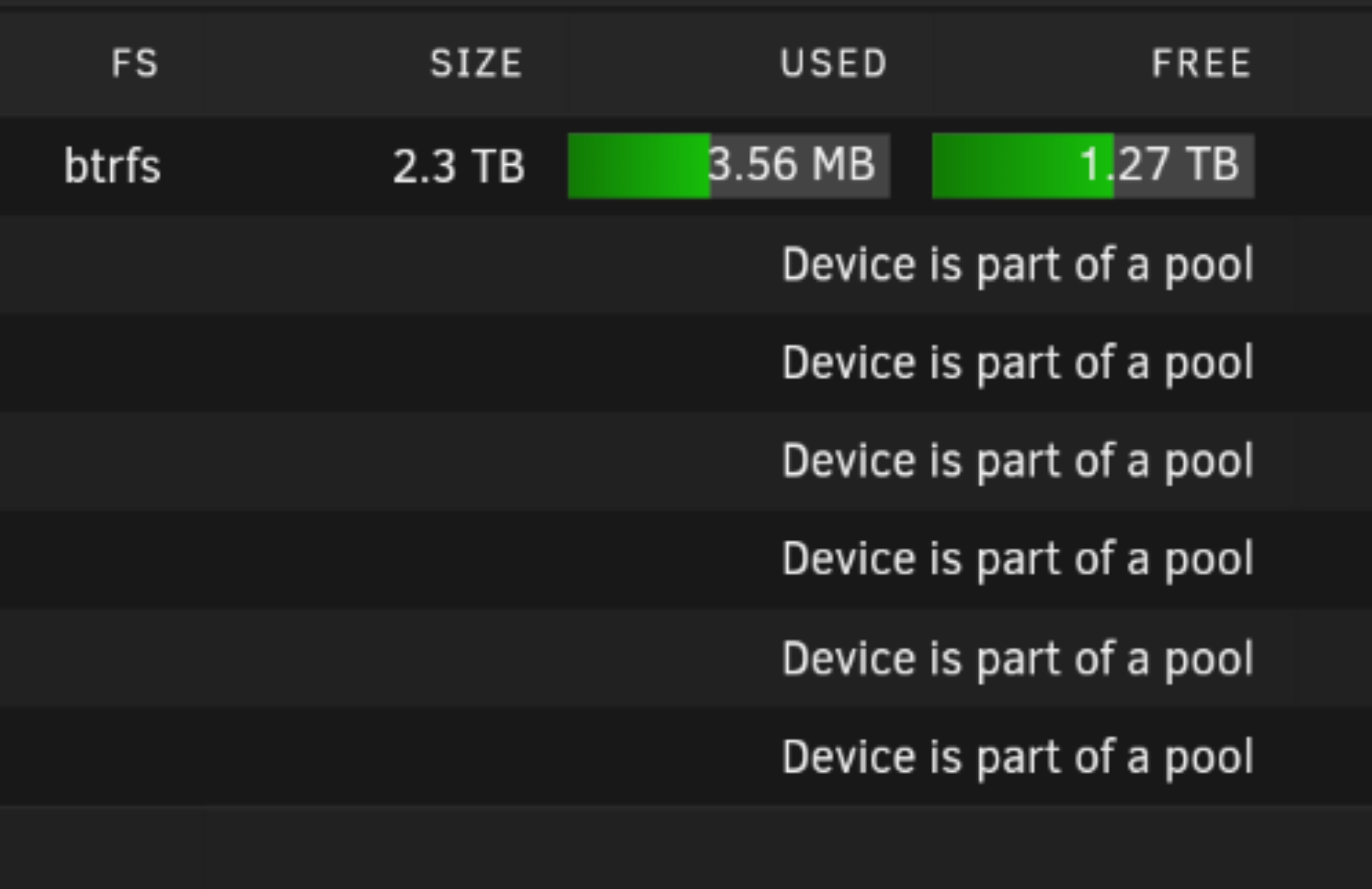

Hello, I am hoping to have someone sanity check me on whether or not these numbers make sense or not. As can be seen in the screenshot, I have 7 cache disks of varying size. Sometimes the cache pool will says 2TB total, but sometimes it will says 2.3TB. The USED and FREE numbers don't add up to anywhere close to 2 or 2.3 TB.
Most recently, I deleted my cache pool and completely reformatted all the drives, thinking that may solve the problem, however, it currently shows that of 2.3TB, I have 3.56MB used, and 1.27TB available. Another interesting note is that the bars seem to indicate that 3.56MB ~= 1.27TB.
From trying to look into this problem, I understand there's an issue with free space calculations in btrfs, but this all just seems a little off considering that I don't recall having an issue like this before and wanted to get some other eyes on it.

btrfs raid1 with an odd number of devices gives incorrect free space, and it will change as you fill it up, that's a known btrfs bug, total size e used space should be correct, strange about the pool size.
BTW, total usable space will be 2.25TB
Thanks for the info. JorgeB! Though it makes me wonder, why include the Free Space at all if it's known to be buggy and there's nothing Unraid can do about it? Seems to me that the cache always has at least a good idea of how much space is actually being used, so it seems like it would look much better if there was only the used metric there, and if the bar filled up as a percentage of the used space over the calculated space (2TB/2.3TB in my case). Even if the total drive space does fluctuate a bit, 3MB/2.3TB vs 3MB/2TB or 200GB/2.3TB vs 200GB/2TB seems like it would look much better than an arbitrary 3MB ~= 50%.
