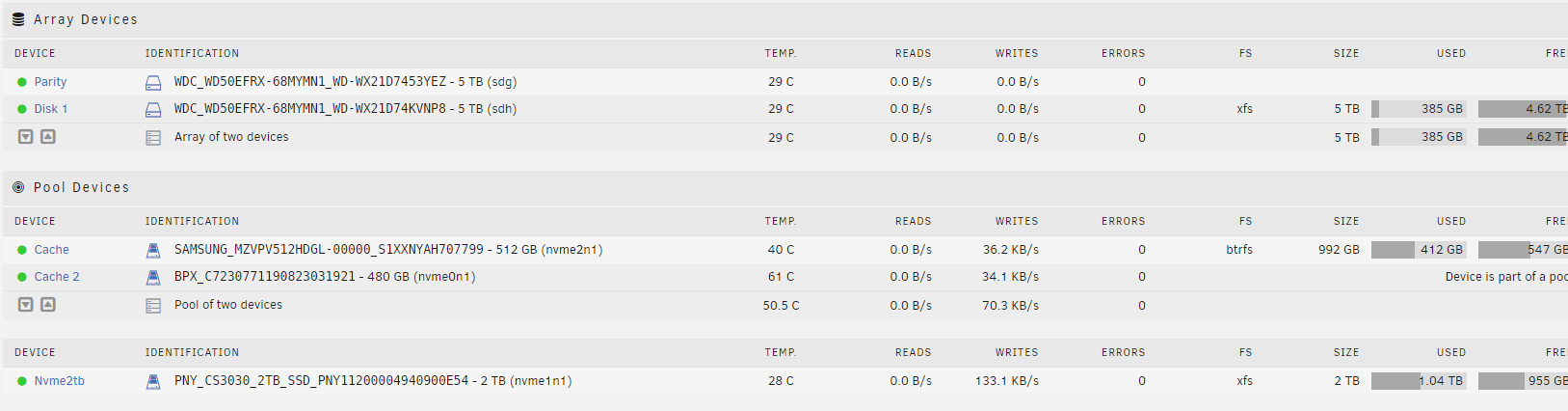

I've been running happily running unraid for over four years to host two Windows 10 gaming PCs. Performance is excellent and now that I'm running the VMs 100% on NVME I find that I don't use the array (2 * 5TB HDDs) at all. Any additional storage for the VMs is mapped to my NAS.
I'd like to repurpose the HDDs elsewhere so is it possible to build and run an Unraid VM host without an array?
I'm currently running ver 6.9.0-beta 30. Disc setup below.

You DO have to have at least 1 drive in the array.    However if you never intend to store anything on it you could just use a small flash drive to satisfy this requirement.
