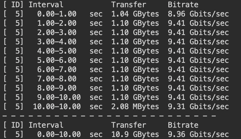

With this setup, perf3 yields:
imageproxy.php?img=&key=e5eec7c5c933ca16258019727_ScreenShot2021-01-02at1_55_22PM.png.6c060c899fcd098d789e12ed3b018dc3.png
This equates to 1.17GB/s, which is great for zero tuning. But I've never achieved anywhere near that on smb transfers on Unraid, until today.

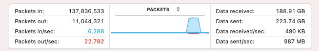

The resulting smb single large file transfer speeds:
My receive speed is essentially the same now as iperf3, with the send being about 15% slower (which also matches an unposted iperf3 result.) Again, this is on mtu 1500.

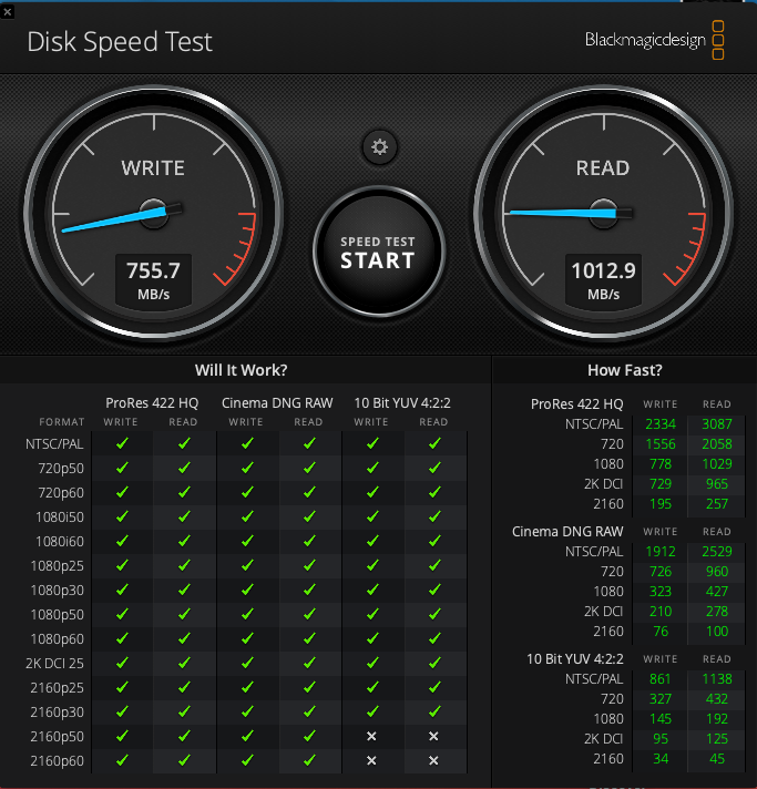

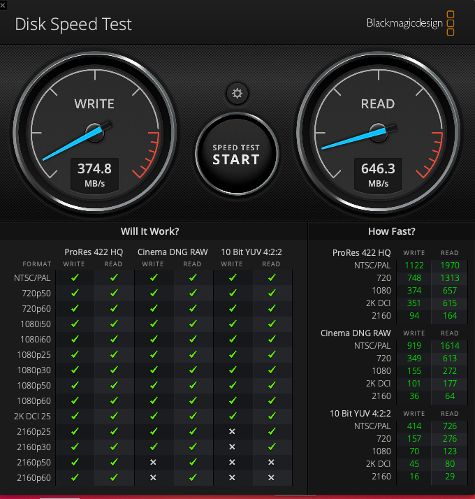

Since I still have access to the original folder via the normal user share (shfs) way, here is another comparison
Normal user share:
Workaround:

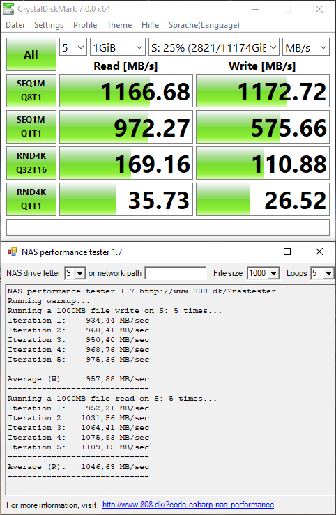

Now benchmark \\tower\disk1 with Blackmagic Disk Speed. If your result is higher than your maximum HDD speed, than you are benchmarking your RAM and not the disk. This is my test result of disk1 with Crystal Disk Mark:
2138043389_2020-09-2822_36_28.png.24ba855ce89f4b8dc05ecf756d631346.png.087789bf1d1debff2622f6a4399a381c.png
Those values are impossible for an HDD.
