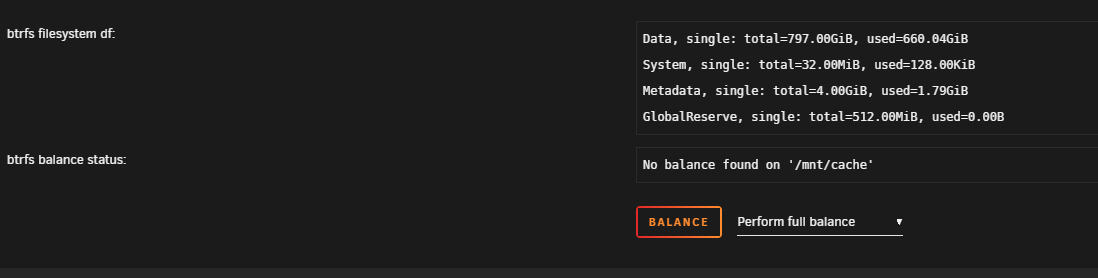

OK I guess I really screwed things up.
exactly what I didn't want to do.
Here is what cache is saying now.  The second balance happened, but btrfs is still running keeping me from stopping the array.
It also now says single instead of Raid1.  I can't show a picture of the main page because I can't stop the array.  But I have cache pool set to 2 slots, and the first slot is this drive, and the second is set to no device.
How do I recover?  The system is running, but I see a lot of these in the log file:

Convert the pool to raid1 then remove the old device.
