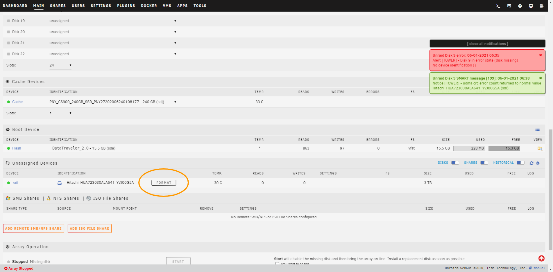

Just replaced a smaller disk with a slightly larger one and know I need to preclear first (yes, the plugin is installed) - but thought I needed to hit the "format" button as shown in the attached - but it's greyed out - what am I missing?

You don't format the disk outside or inside the array, rebuilding will create the filesystem.

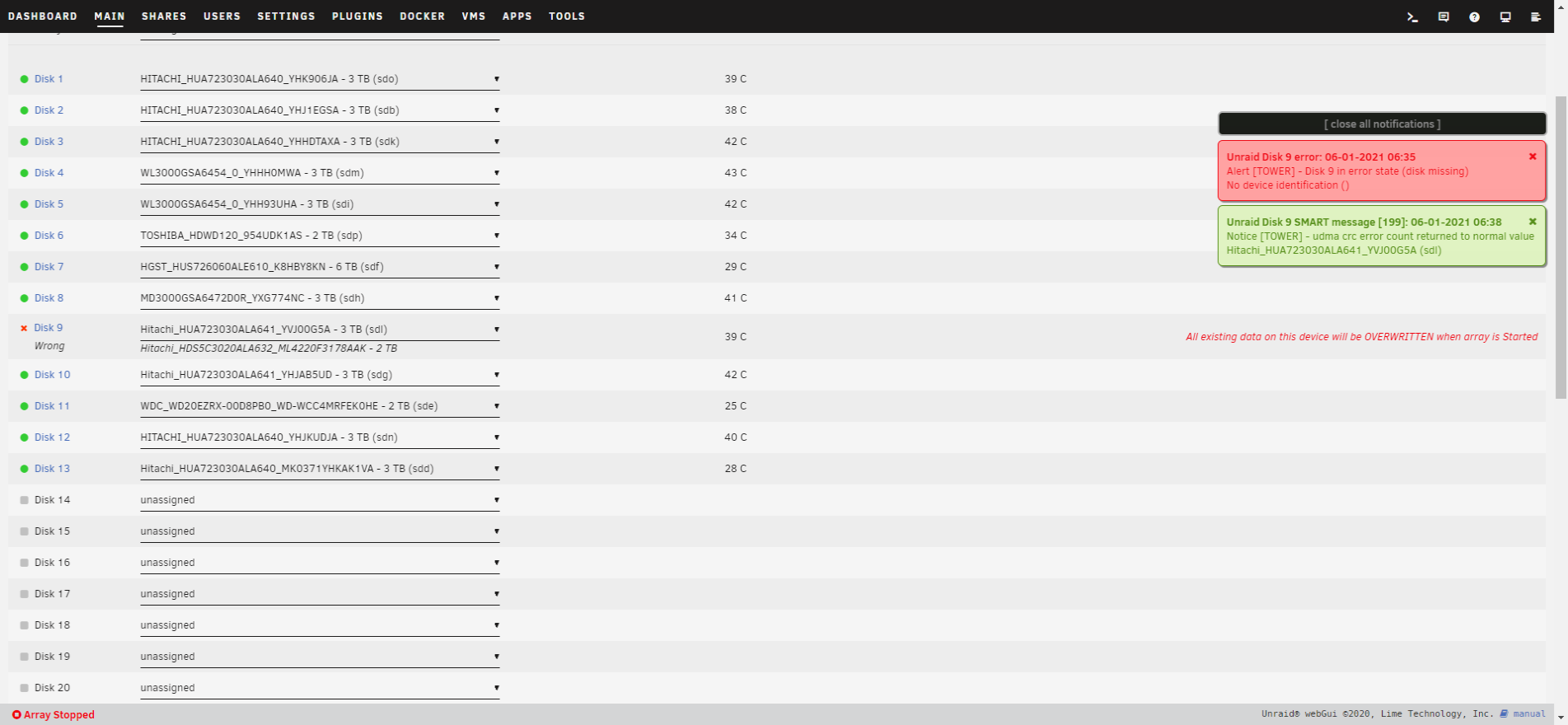

Just start the array from here (attached) and all will be fine?Tower-Main2.thumb.png.a6f3b6f6e933a77596ce15675dcb132b.png
It will rebuild whatever is showing on the emulated disk, that should already show you data, and you can see that after starting the array with that disk unassigned.
