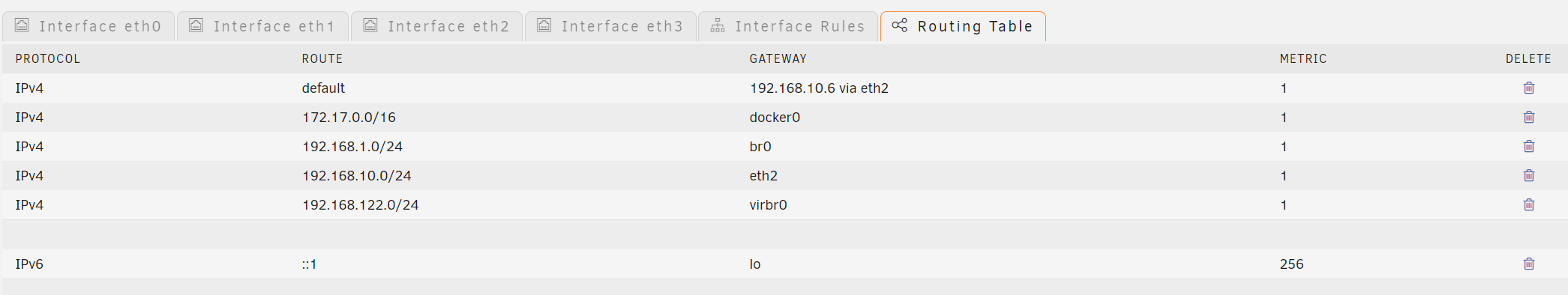

This is where the mistake is... the default route is set as 192.168.10.6 via eth2.
That is my internal and not externally connected network.
The default route should be 192.168.1.250 (my router) via eth0 (my uplink)

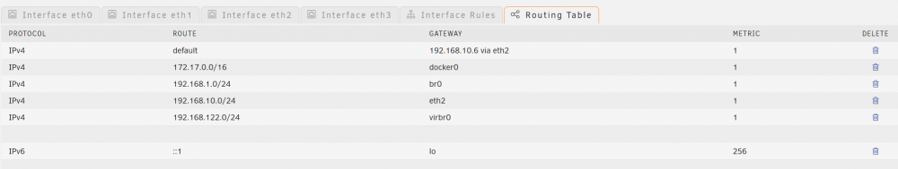

I added the correct route, but now I have two.. pressing the wastebin icon on the wrong one does not work..
I removed the extra route via console:
route del default gw 192.168.10.6 eth2
Its gone in settings now... But this is the way it was earlier... I -think- this will reset itself after a reboot again.. Which is also logical since this was done in the non persistent memory.. Where does unraid store its route information in boot/config ?
