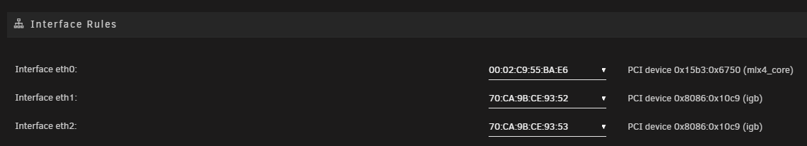

You can re-order them in Settings / Network Settings under "Interface Rules" (at least you can in unRAID 6.9, not sure how recent this feature is).  Here I have reordered my interfaces, so upon rebooting, my 10GBe (mlx4_core) is assigned whatever network settings I have configured for eth0:
If you get stuck, you can edit these assignments manually at /boot/config/network-rules.cfg
