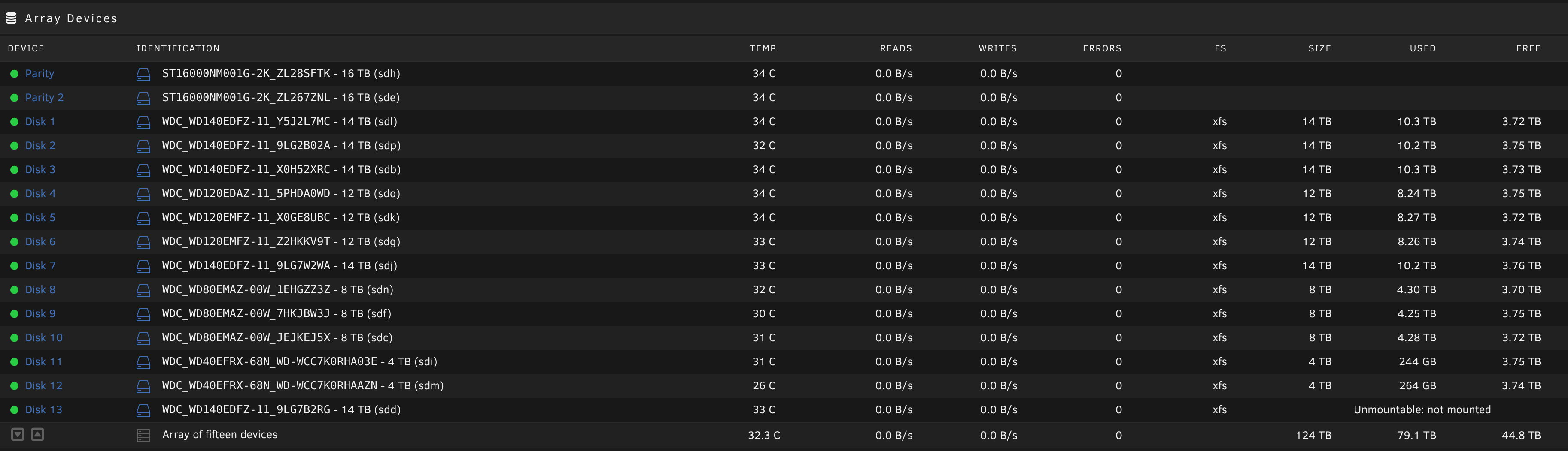

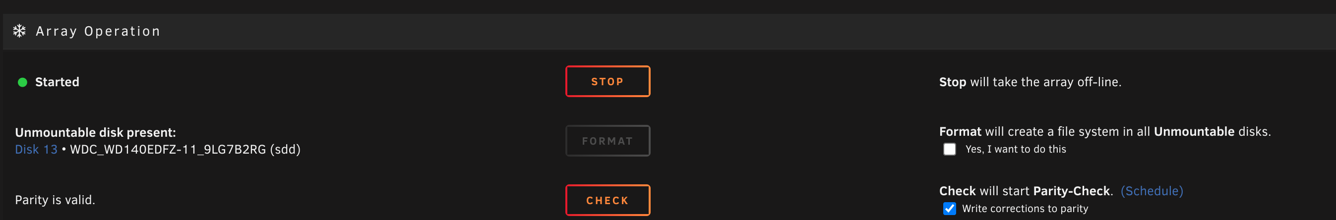

I am trying to add a new disc to the array and it unmounts after reboot. I did the standard preclear, format, mount, & added it to the array. It temporarily showed the new disc as part of the array, but after a reboot, it drops it back down to the bottom and says "Unmountable: not mounted".

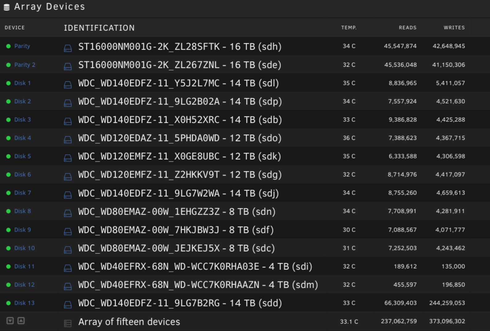

The two things that stand out are the excessive amounts of reads and writes on this disc as well as how it unmounts after showing mounted and part of the array.

Attached are screen shots of the discs as well as the logs.
2028513523_CleanShot2021-01-20at10_21.59@2x.thumb.png.d11bb59e792b2948f7401689a962ed57.png
Whats the safe next move? I just want to make sure I dont do anything to lose data. Do I attempted to format unmountable discs and adding to the array again?

Since you rebooted before getting that syslog nothing to see except the fact that disk13 isn't mounting, probably because it hasn't been formatted.
