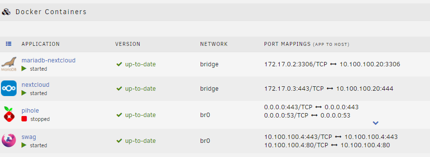

Hey guys. Having some issues with nextcloud/swag setup. Hoping someone can point me in the right direction here. What I am trying to accomplish is to use SSL/Letsencrypt to access my resources ONLY locally. In unraid I've configured swag in bridge0 network which is on my local network.
I created a DNS record of nextcloud.mydomain.com pointing to 10.100.100.4 (SWAG proxy)
Configured the config file for nextcloud as per below
Configured the .conf file in SWAG for nextcloud as per below
When I try to access nextcloud.mydomain.com it gives me a 502 Bad Gateway
When I try to access via the IP of 10.100.100.20:444 it rewrites the url to nextcloud.mydomain.com and I get a bad gateway. Not sure what I'm doing wrong here. Any pointers?

Bumping for visibility
No particular help (sorry), I don't use Swag.
Have you tried NGINXProxyManager?  Much easier to use and no config files to mess with.
Just forward the port on the firewall and create a Proxy Host.  Job done.
Can you clarify what you mean by forwarding  the port on the firewall? I'm trying to keep everything internal and not open any ports on the FW for any external access.
Sorry I meant on your router.  If I remember you forward ports 80 and 443.  I forward to 180 and 1443 and set these up in NGINX in the docker container.
It's really straight forward and works really reliably.
