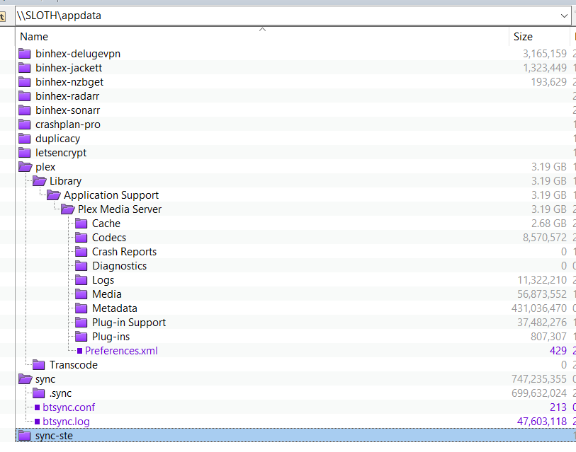

Also the contents of my appdata seems like it looks like it has the right config see attached and files etc, I've tried restoring various versions from as far back as a week.
Could there be a permissions issue causing it not to be able to read this?
The thing I recently changed was removing a cache drive, but I set the cache settings to move from cache back to array and ran mover and ensured the cache drive was empty before removing.
