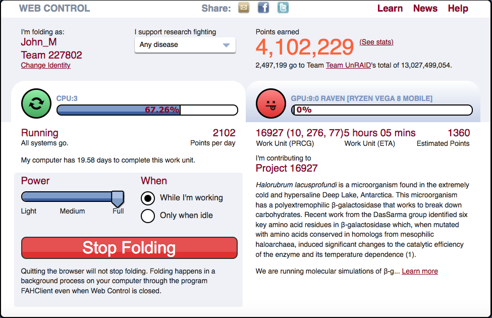

There is no support in the Linux version of Plex for hardware encode or decode using AMD GPUs, therefore there is none in the Docker version. There is in the Windows version but it's provided "as is" and it may not work for everyone. Docker containers can make use of AMD iGPUs if they are written to make use of them. For example, the FoldingAtHome container detects the iGPU in Ryzen APUs but there is no support for OpenCL built into the container so the iGPU can't be used. If OpenCL support were to be added then it could be used. Passing an iGPU through to a VM is problematic. I've never had any success.
