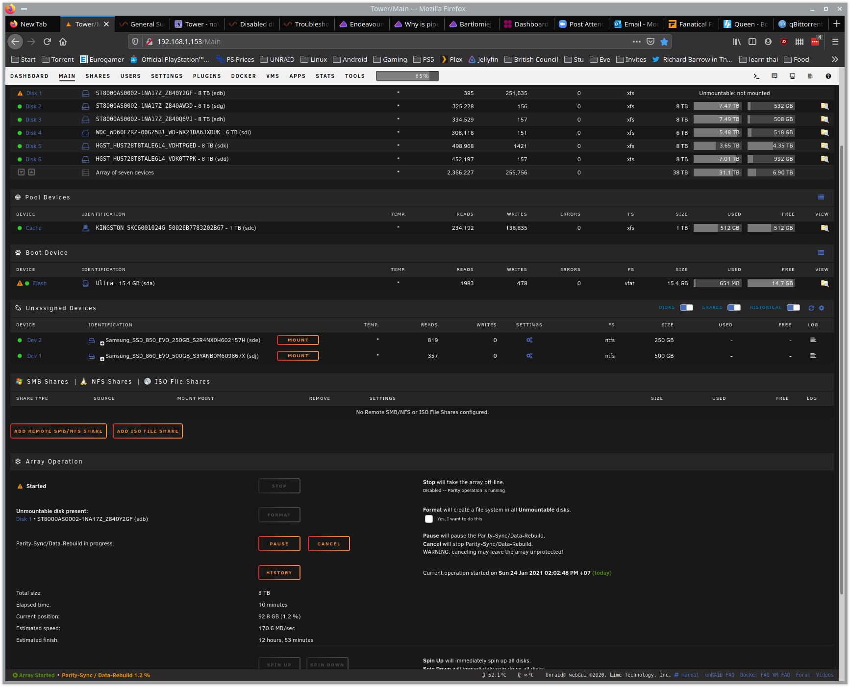

The disk wasn't unmountable until after I followed the instruction linked in my original post from the wiki, just as disabled.

The last part that I bolded I didn't get to do, as soon as I started the array it only offered me the choice to format or rebuild parity, so I chose rebuild parity.

Do you mean rebuild parity or rebuild the data drive?  If the data drive was showing as unmountable at that point then the rebuild would also result in an unmountabje drive.  The correct way to fix an umountable drive is to run a file system check/repair.   Ideally this is done on the 'emulated' drive before doing a rebuild so that you still have the original drive unchanged if needed for any data recovery attempt.
Tried checking and it still isn't mountable.
Repeated with - L and still unmountable.

Sorry, I restarted the array and the drive showed. I didn't realise that the device menu display would not change.
Data is back with the drive being emulated and it's rebuilding from parity.
Thank you very much for your support.
