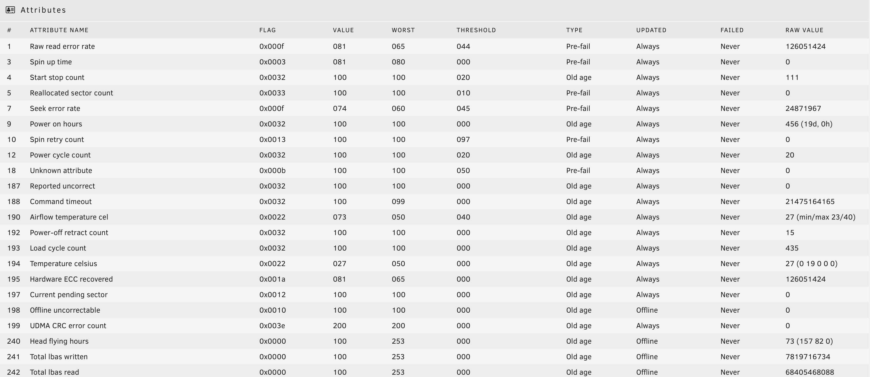

THis is the result of the short test.  The long test is still running.  I attached a screen print as the below text is poorly delimited.
Attributes
#ATTRIBUTE NAMEFLAGVALUEWORSTTHRESHOLDTYPEUPDATEDFAILEDRAW VALUE
1 Raw read error rate0x000f081065044 Pre-fail Always Never 126051424
3 Spin up time0x0003081080000Pre-failAlwaysNever0
4 Start stop count0x0032100100020Old ageAlwaysNever111
5 Reallocated sector count0x0033100100010Pre-failAlwaysNever0
7 Seek error rate0x000f074060045Pre-failAlwaysNever24871967
9 Po wer on hours0x0032100100000Old ageAlwaysNever456 (19d, 0h)
10 Spin retry count0x0013100100097Pre-failAlwaysNever0
12 Power cycle count0x0032100100020Old ageAlwaysNever20
18 Unknown attribute0x000b100100050Pre-failAlwaysNever0
187 Reported uncorrect0x0032100100000Old ageAlwaysNever0
188 Command timeout0x0032100099000Old ageAlwaysNever21475164165
190 Airflow temperature cel0x0022073050040Old ageAlwaysNever27 (min/max 23/40)
192 Power-off retract count0x0032100100000Old ageAlwaysNever15
193 Load cycle count0x0032100100000Old ageAlwaysNever435
194 Temperature celsius0x0022027050000Old ageAlwaysNever27 (0 19 0 0 0)
195 Hardware ECC recovered0x001a081065000Old ageAlwaysNever126051424
197 Current pending sector0x0012100100000Old ageAlwaysNever0
198 Offline uncorrectable0x0010100100000Old ageOfflineNever0
199 UDMA CRC error count0x003e200200000Old ageAlwaysNever0
240 Head flying hours0x0000100253000Old ageOfflineNever73 (157 82 0)
241 Total lbas written0x0000100253000Old ageOfflineNever7819716734
242 Total lbas read0x0000100253000Old ageOfflineNever68405468088
Diagnostics would have given us everything you posted there plus everything else we asked for.
