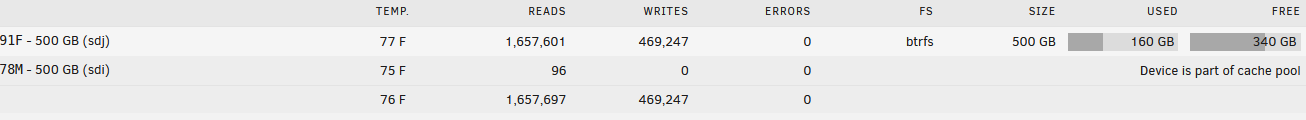

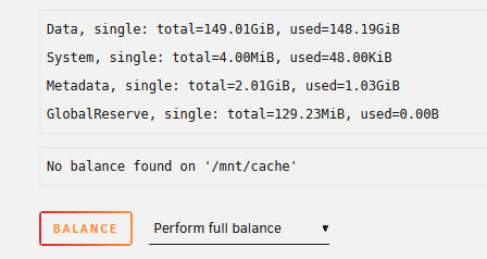

The current cache drive in my system started throwing some reallocated sector count and uncorrectable error count errors a few weeks ago. I recently purchased a new SSD to create a cache pool, however when trying to balance the drives it fails after a certain point. The counters also don't increase on the second drive, as I've seen it should with other examples. I'm assuming it's failing due to the bad sectors on the primary SSD. What is my recourse? What's the easiest way to backup/restore onto the new cache drive without bringing it into a new pool?

Current pool is just one device (sdj), and it has read errors:

It failed the extended test, so it should be replaced, you can also try a full device write/discard to see if it clears the errors (all data would be deleted).

 I started doing that and most of the data moved, but the mover keeps stopping with about 50GB left, and I get a toast error when saying that the drive "uncorrectable error count" incremented again. I used the built in explorer to figure out what files are still there, and there was a large VM image, that I just removed by using the terminal. The last thing that's really needs to be moved from there is the docker.img.
Now, when I invoke the mover, it just refreshes the page and does nothing. Same from the terminal, it goes started and finished in a snap.
