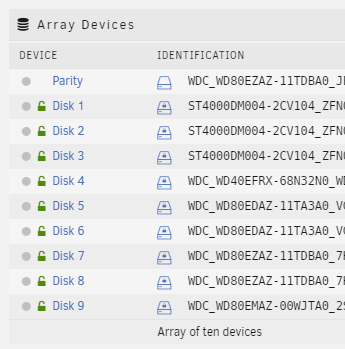

Hey there, by investigating the high powerdraw of my system I stumbled upon a very bad quirk in my system.
The system shows all disks as spun down but they are actually spun up! I can feel them vibrating or spinning back up, after I forced them to spin down.
That is a HUGE difference of nearly 40W!!! Not to talk about the always running disks that should be spun down to enhance their lifespan.

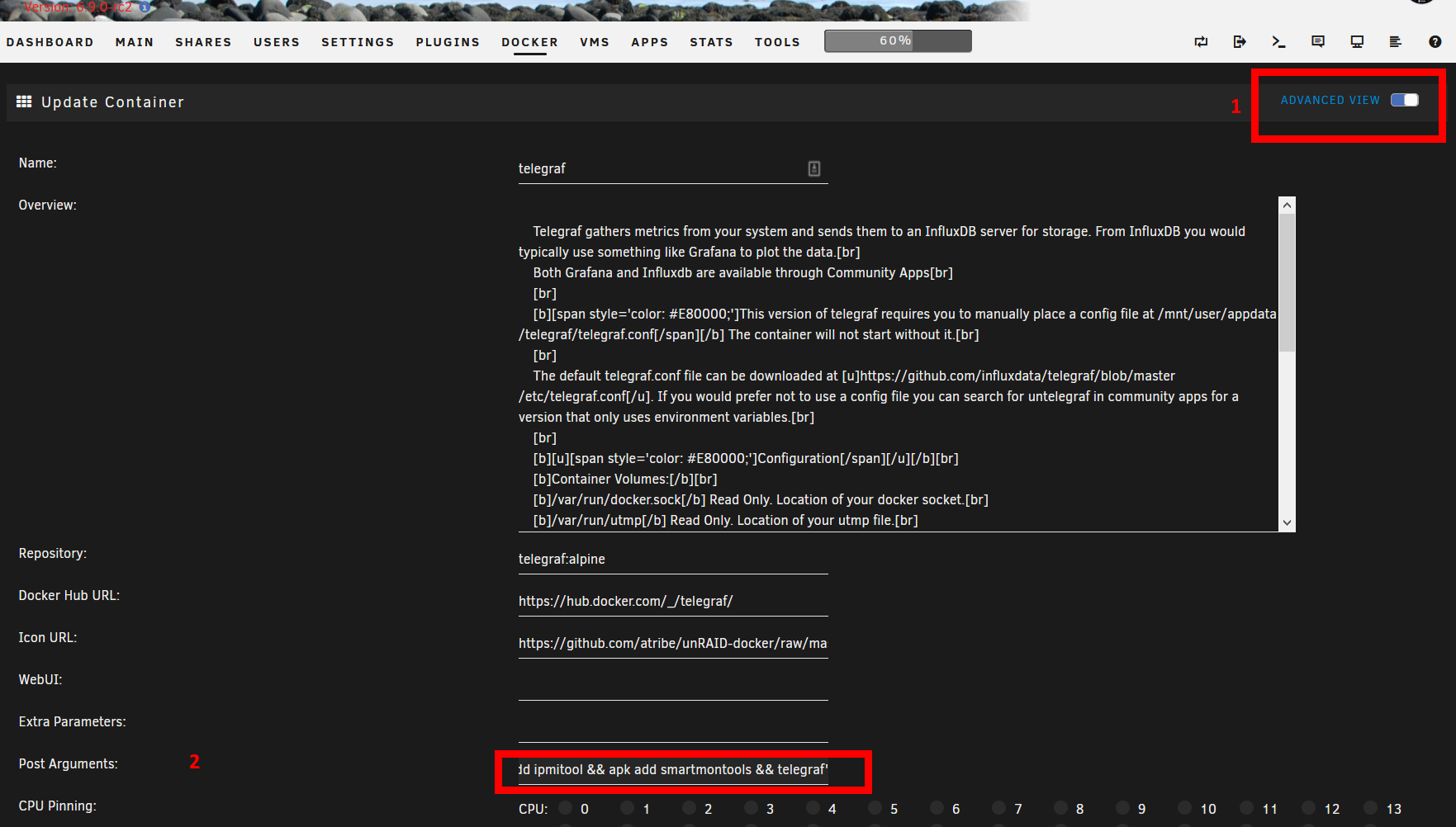

This was not the case for me. I've  restarted my dockers one by one and it looks like that "telegraf" is keeping the disks spun up. Trying to figure out now why though.
Whoops, my bad you are right, I got confused with the startup temp issue. :/
If memory serve*, the issue with telegraph is that some components are either not up-to-date or missing.
I think It can be fixed with post arguments in the docker template.
* recent experience show that my memory is not always to be trusted. :D :D
I've disabled the plugin "HDDTemps" in the telegraf config. It would be awesome to get the functionality back up to monitor the HDD temps via grafana. But unti that I am happy that the HDDs stay spun down.
I am tackling the issue in the next few days, if I find the time for it.
Maybe you could explain the "post agrument" idea a little further?
Thanks!
I am certainly not an expert here, but I think I read about it on one of the numerous topics about the spin issue on RCs (in Bug reports / Prerelease).
From what I get, you can have any docker container run a set of command at startup with the post arguments (available in Advanced View).
I am certainly not a Linux guy so I just run the recommended commands from UUD, I did not dig too much on what specific command can help for spin down.
