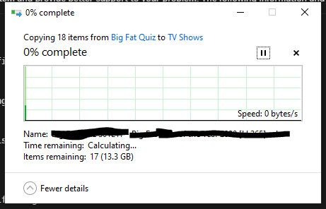

Hi all,
I have been pouring over this form and the reddit channel, I am having some major issues writing to my disks using midnight commander this evening.
My system:
  1. Ryzen 1600
  2. 16gb DDR4
  3. Asrock B450m Pro4-F
Order of events:
  1. Installed 2 new drives last week, have been reshuffling items to reduce spin time on drives since then.
  2. Moved 2tb from Disk 1 to Disk 2 (avg 30-40MB/s) no issues there.
  3. Moved 1tb from disk 3 to disk 4 (as above, no issues there.
  4. Currently am trying to move about 100gb from Disk 2 to disk 3 (avg speed 1MB/s), constant freezing.
  5. I did reorder the disks using this: (i need a specific order...it's an OCD thing).
  6. Writing first attempted directly from mnt/disk3 to mnt/disk4, waited overnight and had an average of 1MB/s to 0.5MB/s.
  7. Then moved from mnt/disk3 to mnt/disks/1tbNVME (unassigned), read time from Disk2 slower than expected (avg 60MB/s).
  8. Finally, now trying to copy from mnt/disks/1tbNVME to ANY drive on array, or between drives yields under 1MB/s writes.
  9. Attempted turning on turbo writes, same issue.
  10. Attempted multiple restarts.
  11. When attempting, Midnight commander appears to freeze, needs to be manually killed for the array to spindown.
note - I also adjusted the Disk Cache 'vm.dirty_background_ratio' (%): to 2 / 4 (previous was 1 / 2) using tips and tweaks.
Before you ask ;-):
  • 5 data drives (connected via IT flashed H310)
    • 3 of the drives are SMR, expecting a write penalty but this is well over and above, plus #7 above should have decreased this variable a lot.
  • 1 parity (directly to mobo)
  • 1 cache (directly to mobo)
  • 3 unassigned drives (directly to motherboard
  • I am ONLY writing from /mnt/disk to /mnt/disk, never to or from shares.
It's almost like my system is running out of cache and it's unable to write anymore to any drive?
Lastly, my cache is basically full, I have tried using mover for a small set of files but did not experience this delay or write issue.
The diagnostics are attached, this is with a move after a Fresh reboot, so let me know if there is some more tests I should do for more data.
adam-htpc-diagnostics-20210220-0102.zip
