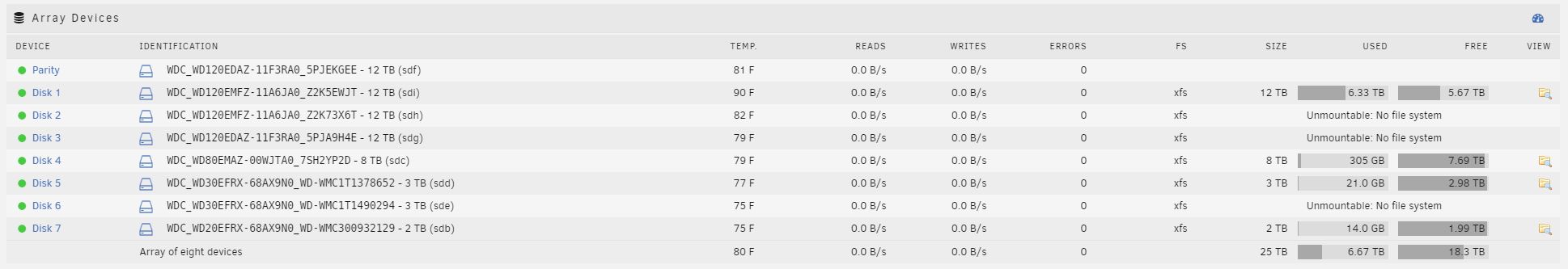

Unfortunately, something also happened to three of my drives.  It's saying "Unmountable: No file system" and I have no idea why.

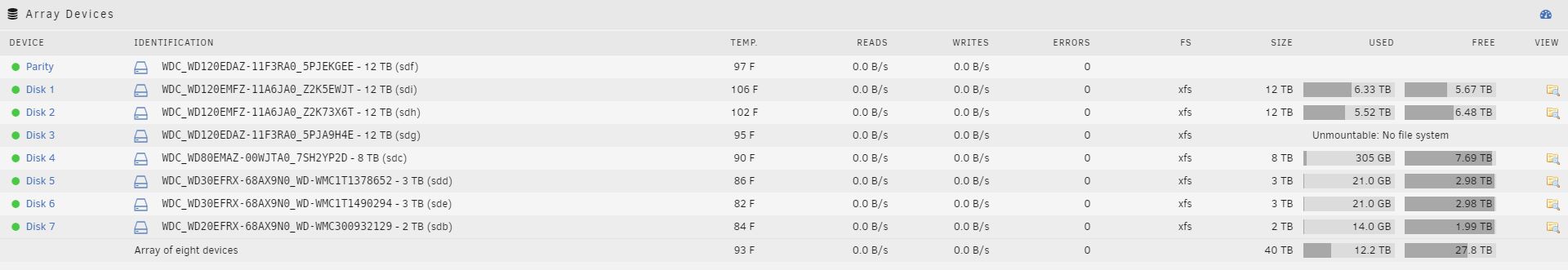

Thank you.  I tried xfs_repair with the -L option and it seems to have fixed two of the drives.
Unfortunately, the 3rd drive is still unmountable even thou xfs_repair seems to suggest it was able to fix it.

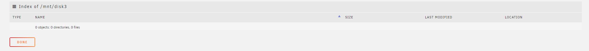

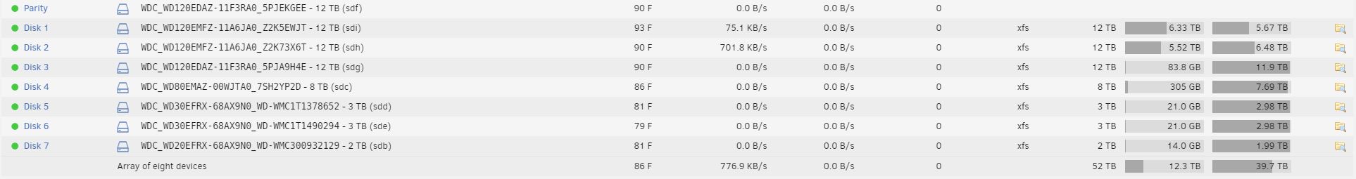

I changed it and it mounts now.  Unfortunately, it shows 83GB used, but it should have been around the same usage as the other 12 TB drives.  Looking at the disk itself, there's nothing in there.
Am I out of options?
Edited by SloppyJoe
