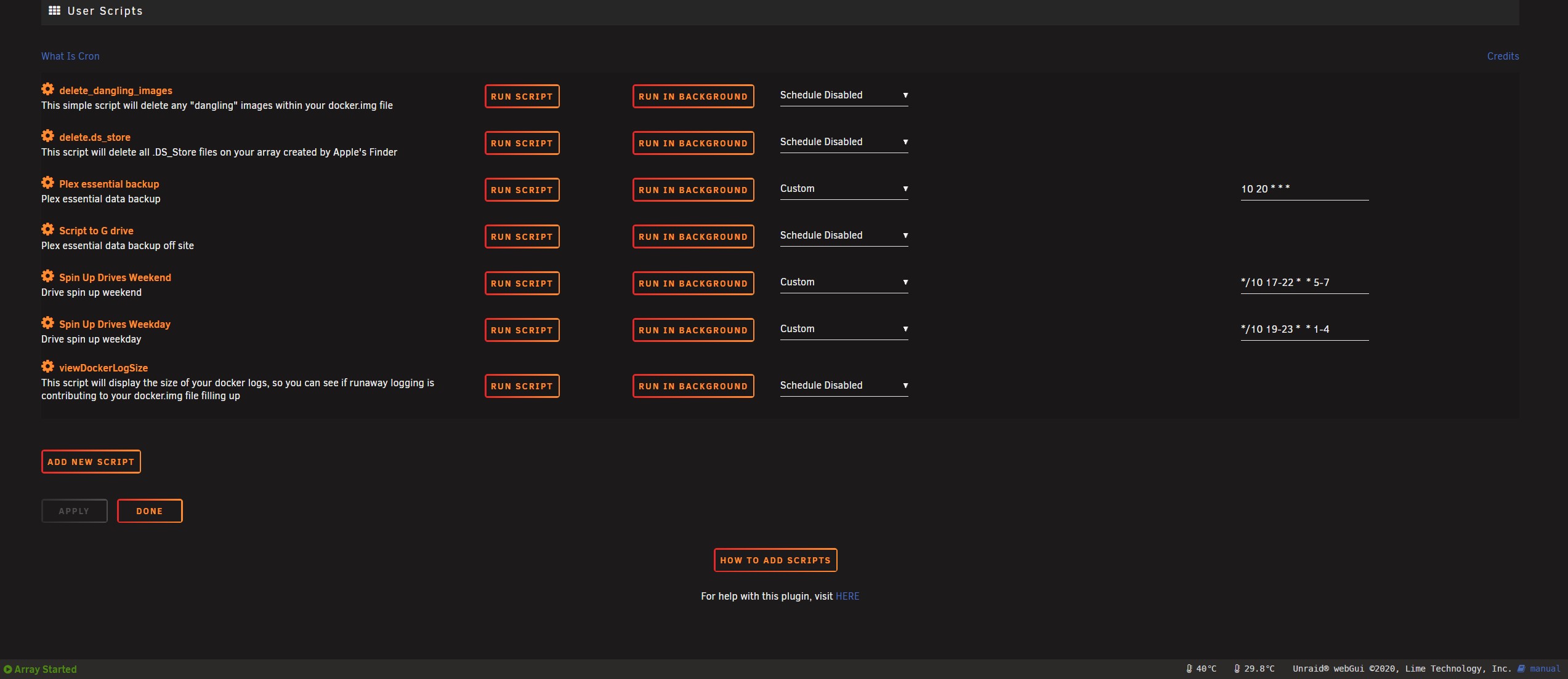

Hi mate thanks for your reply very much appreciated, typed in terminal with +1 and nothing deleted but no errors, i changed to +0 and deleted folder see below
ive now lost the option buttons for the logs in user scripts page

the user scripts logs don't persist after a reboot, so that's ok.

Ok will do thanks very much will the log buttons reappear ??
they sure will! once your scripts run again, there will be a log entry.
