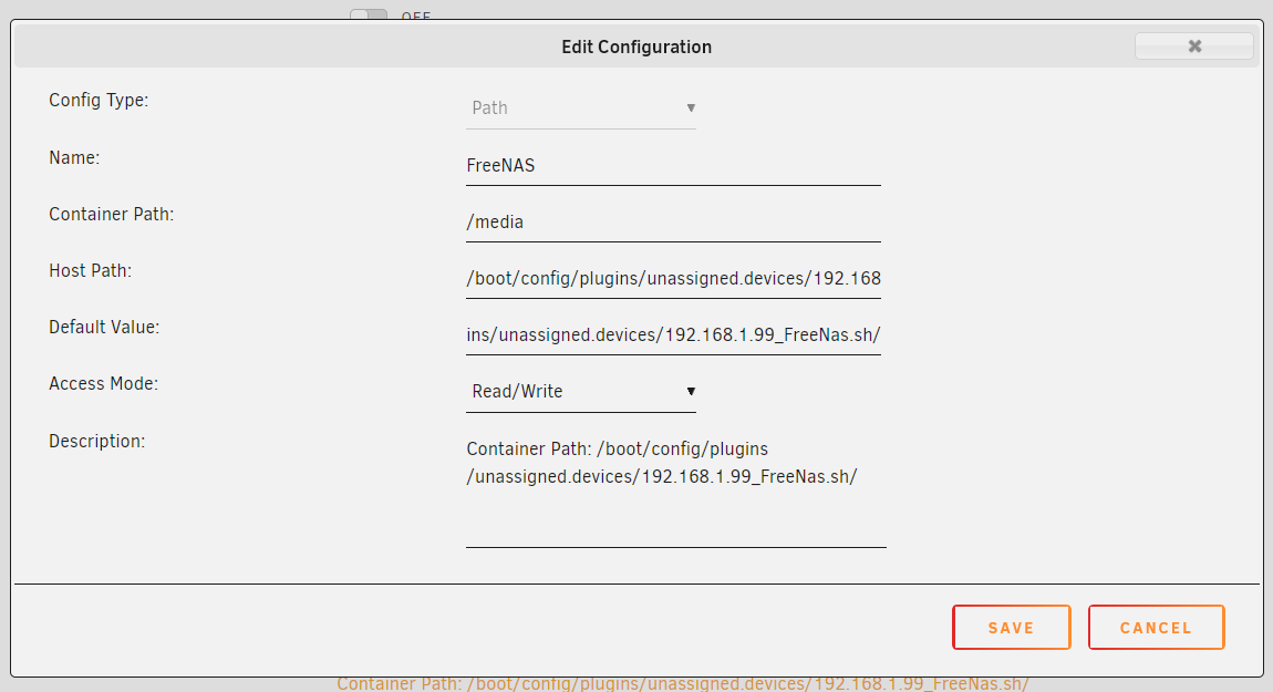

So now I went and added a "PATH" under PLEX docker settings (check attached image)
Basically from my understanding (and I guess I'm wrong)
Container path should be same path as the other media folder
Host Path I selected the share
default value should be same as the host path?
I know, I'm a n00b, sorry.
additional info
I was hoping the FreeNAS media files would be under /media but I am wrong. Also the boot folder appears empty in the plex GUI.
Edited by bhootz
additional info
The host path is /mnt/remotes/192.168....
Also set the Access Mode to be Read/Write:SLAVE  Once that's all done, within Plex you'll see everything at /media
