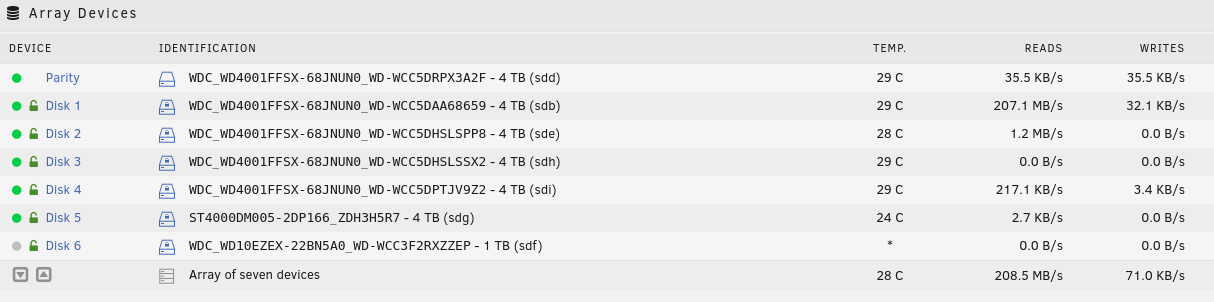

I've had issues with a lot of CPU usage, and I found out it was CPU IOwaits, but I noticed at the same time, a single disk was reading a lot.
The same disk had a "UDMA CRC ERROR COUNT". I read on these forums it's not dangerous, just make sure the cables are correctly plugged in.
Last night I looked at the disk, unplugged it and plugged it in again.
I ran an extended SMART test without errors, and without dockers started.
Now it looks like the CPU usage is gone, but the disk read isn't:
The issue started when I started the dockers again, but I can't figure out which one it is.

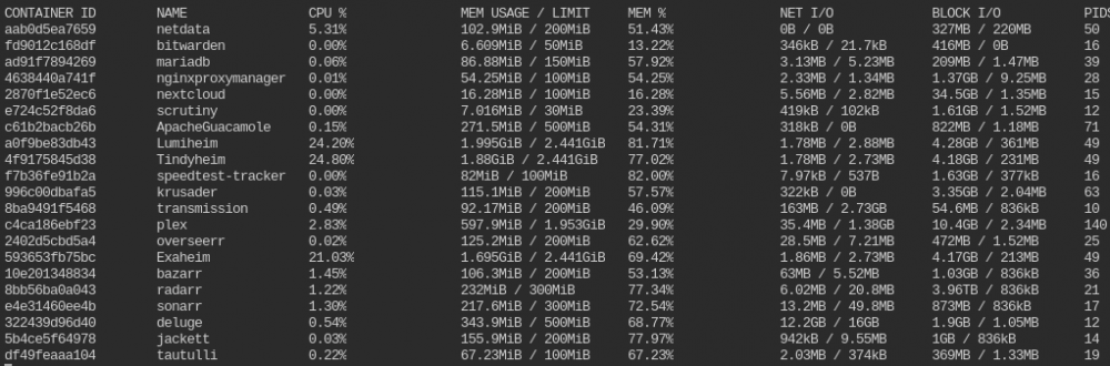

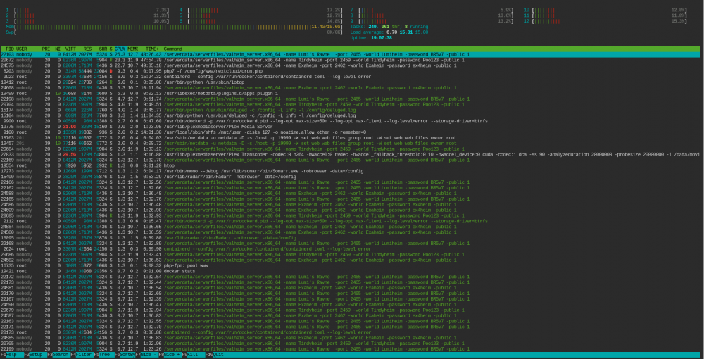

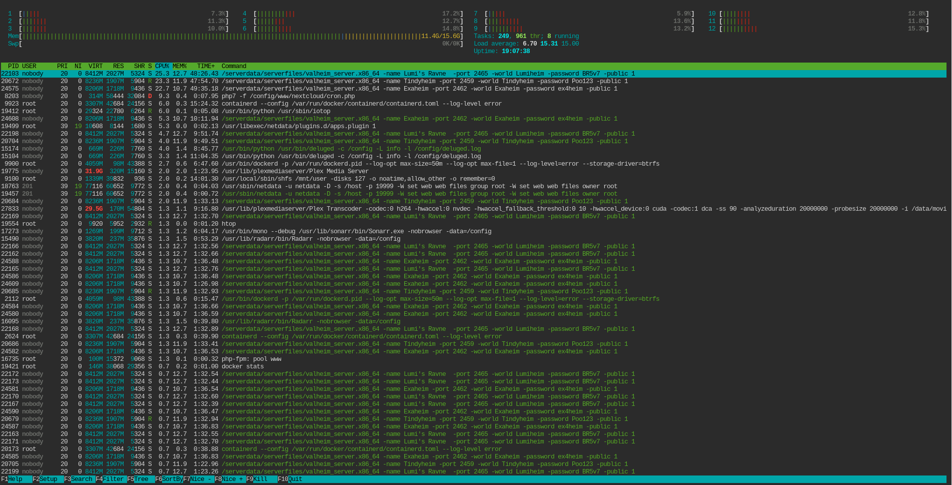

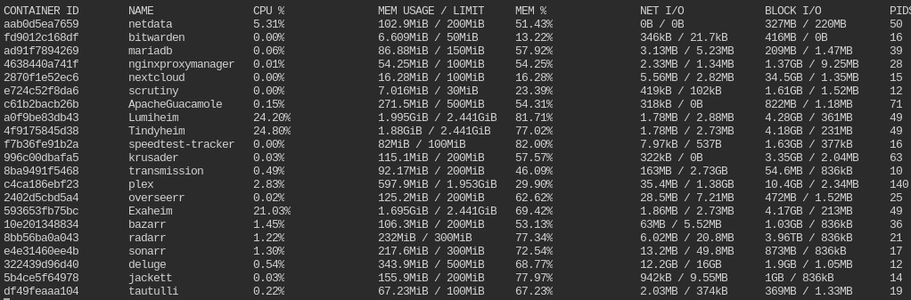

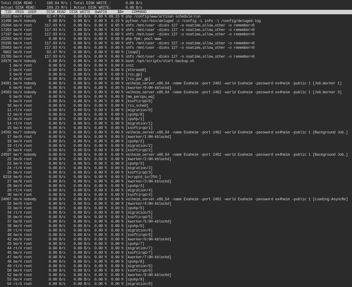

I've used Nerd Tools to install "iotop". I've also used "htop" and "docker stats".
It shows a bunch, but I can't seem to find the source to my problem.
After a while, it's normal again, but that can be anything from 5 minutes to 5 hours.
htop:
docker stats:
iotop:
I've noticed the "php /config/www/artisan schedule:run" usually is in the top of iotop, but I can't figure out what it is, except it's a scheduled run of something.
Google didn't help me on that one.

Stop all dockers then start one at a time until you find the culprit.
I've been running the same containers for a while with no issues, so I don't get why it suddenly started doing this.
I'll do it if the problem appears again, atm. it's gone.
